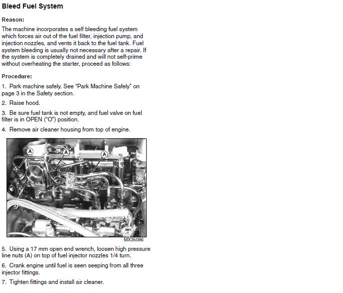

My 2320 has a fuel gauge right on the dash , it might be something new since you had your 2320. But I did look it up in my new technical manual and yes the 2320 does have self priming fuel system. again, this may be something new since you had yours.

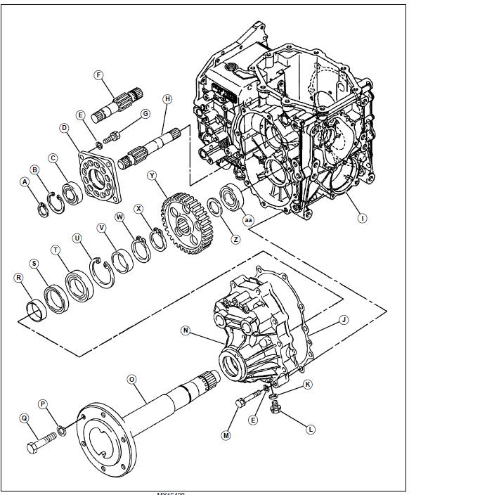

2320 has geared final axle also, just not offset like the 2520. The dealer is the one that brought that to my attention. Like he was telling me to quit second guessing the engineers that design these tractors. No matter which one I buy they are all top notch. I really liked the 2305, but sold out of new.

I respect my wife's opinion but reason takes precedent. As far as tractors go I would say that reason dictates that "form follows function" as the German's say.
I did have a fuel delivery problem on my 2320 with less than 100 hours on it and the fuel delivery system on the 2520 is better one than the 2320.
I have mowed up and down hills with both tractors and the 2520 was better, the 2320 just never seemed to be able to maintain the speed I wanted. Also if you buy MMM's and backhoes you won't be able to directly use them on the 2520/2720 if you ever decide to trade up. The 2320 has a shorter chassis.
Look the 2320 is a very good tractor but let's not think that the only difference is that the 2520 is just a couple of horse power more. It's a lot more tractor but you won't find that out using it in the dealer lot for 20 minutes.

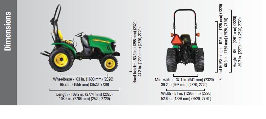

Deere site says #46 backhoe fits 2320,2520,2720 ? is there something else that makes this not fit ? When I had them at the dealer 2320 and 2520 side by side the 2320 was a couple of inches longer. But that may have been overall length , I think 2520 had 2 inch longer wheelbase at tires.
What year was your 2520? maybe they changed something on the chassis since then.
My salesman lives down the road i'll ask him today if I see him about the 46 backhoe
