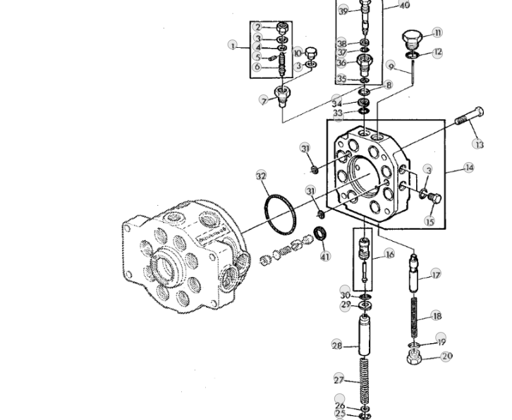

Does your 2350 have older style steering with a drag link from steering valve to frt axle or external steering cylinders? IMHO turning steering wheel back & forth on hydrostatic PS with external cylinders will not de-stroke frt pump easily as old style power steering. If tractor is open station have battery ground cables been relocated from attaching to rusty battery box to engine block or starter mounting bolt? I would suggest to install hyd pump manual de-stoking screw(Key 40) RE13271 SCREW, PUMP SHUT-OFF ASSEMBLY ADD 43.98 USD . Key 1 which is $13 cheaper is a different type screw that has a long history of o-ring failure creating a hyd oil leak. There's also an electrically operated DS screw for more $$$$$
Part number for de-stroking screw will be determined by which hyd pump your tractor has because I just GUESSED about hyd pump type.

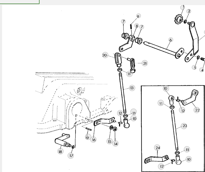

Knob in frt of seat is 3 pt rate of drop screw. I overlooked tractor is a cab model but I'll still advise to relocate battery ground cables to engine block or starter mounting bolt. On 3 pt lifting height try relocating L/D control knob(key 1) to determine if 3 pt will raise higher
Ok, that could be the only problem there. In other words, my ignorance of things green. Owner is someplace warm with no snow for a couple of weeks, so I can't ask him about that. Thanks for the picture.

It is MFWD with the single steering cylinder.
That was a good guess on which pump.

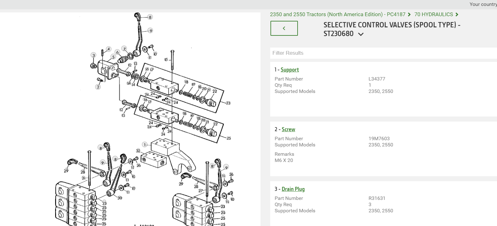

2350's had option of poppet or spool valve scv's. As you're well aware the solution to oil leaking internally with spool control valve is replacement of complete component not repair. It will be interesting to know which type scv TDIdog's tractor has.
You are correct Jim. Most 50 series we sold had the more deluxe poppet valves, so it slips my mind sometimes that the spool valve is a possibility. At that ime period, most spool valves were on government bid situations. The spool valves were cheaper, so they were spec that way to compete with other brands that didn't have the "deluxe" poppet valves. Today, the spool valves are the norm. Deluxe valves are electronic controlled spool valves. Makes you wonder what "improvements" we will see next. Scary at times.
Edit, I went back and read the post by jd110 and he is talking about the poppet valves, not the couplers. That means I'll need to step back and take another look at digging into this.
It definitely has poppet valves. Never did understand them and only worked on one or two 25 years ago, so If i have to go there, I'll have to reassess my options. But JD110 suggested the couplers themselves are a common issue, so I'll start there. I will probably throw jumper cables from the battery to the starter just in case there is an electrical issue even though this isn't a 57 Chrysler, but since the pump doesn't destroke when moving the SCV lever to full stroke, I'm sure the problem is hydraulic.
