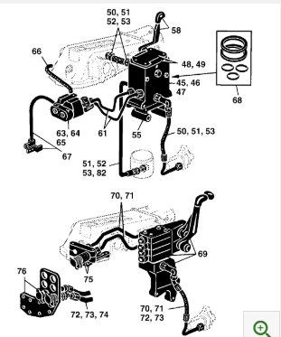

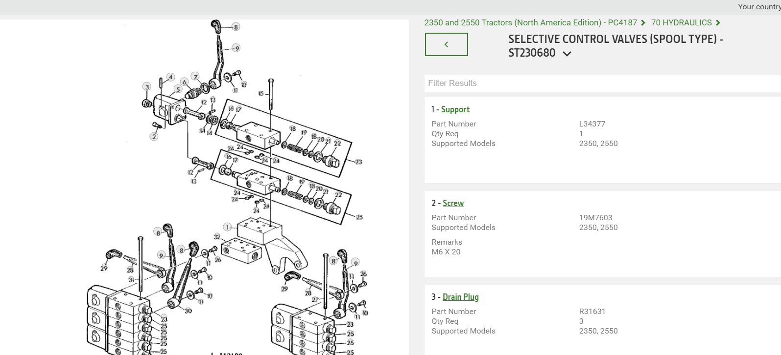

1st thing that needs to be clarified is if your tractor has poppet or spool scv's. Which type control valve does your tractor have(top or bottom)?
PS: I'm not convinced the scv's on your tractor are causing it's hyd problems. I'll suggest to get a 5000 psi gauge with a short hose & male coupler & check pressure on each breakaway coupler & note if pressure falls when control lever is returned to neutral & how quickly it falls.

You are correct Jim. Most 50 series we sold had the more deluxe poppet valves, so it slips my mind sometimes that the spool valve is a possibility. At that ime period, most spool valves were on government bid situations. The spool valves were cheaper, so they were spec that way to compete with other brands that didn't have the "deluxe" poppet valves. Today, the spool valves are the norm. Deluxe valves are electronic controlled spool valves. Makes you wonder what "improvements" we will see next. Scary at times.
I agree most utility models I've seen have the poppet valves. Have you ever set or witnessed adjusting poppet valves utilizing air pressure instead of dial indicator?

It definitely has poppet valves. That is the square block just below the leaky shift levers. 100% sure on this. I looked through the parts manual once you guys started discussing poppet valves, and it is poppet valves.
I also bought a tech manual PDF and have had a quick look at the poppet valve rebuild procedure and I am wondering if the poppets can be resealed without messing with the adjustments. According to the tech manual, the poppets come out, then the rocker plate, so it would seem like this could be done. Or does removing the valves require an adjustment afterwards? Also, is the plate required to adjust them?

Anyway, if I have this right, it looks like the pressure hose into the poppet valve goes in between the valve and the trans. That hose goes into a block on the side of the trans just above the filter and that block has a hard line going forward. It'll be easier to isolate the FEL valve, so I'll do that first, but where is the best place to isolate the poppet? Going into that block or coming out of it? I feel it's coming out of it, but would rather not somehow bust a window in something.
The FEL is a JD 540. Looking through the holes in the box housing the loader control valve, it looks like a spool valve.

Valve on the side of trans by hyd filter is the pressure control valve designed to give the power steering priority hyd pressure over other hyd functions. Disconnecting line in frt of valve will eliminate hyd pressure to scv,FEL valve & 3 pt hitch.
