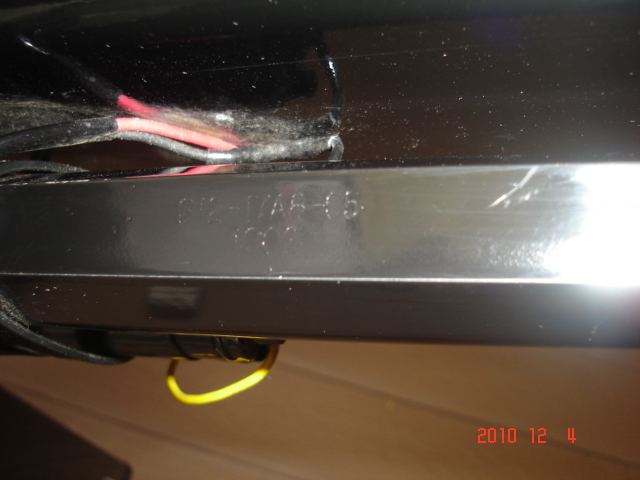

Just for information purposes I'll post the brand of deflector actuator and specs included in my kit.
Make: Thomson
Pr#: S12-17A8-05
Stroke: 5"
Actuator Type: Rod Type
Actuation: Electrical
Rated dynamic force: 75 lbs
Rated Speed: 1.00 in/sec
Operating Temperature: -13 to 149 F
Drive Configuration: Lead Screw
Mounting Method: Clevis Mount
It looks like this actuator is from Thomsons Electrak 1 (SP) line of actuators.
   / 2360 Electric Chute Deflector Frozen #20
Interesting, Jaylegger-- same number on mine (stamped on shaft): S12-17A8-05.
However on mine, indication on bottom of motor/gearbox is "Warner Electric," of which Warner Linear is a subsidiary. :confused:
It still seems to work OK-- even after a heavy workout as a result of our storm on 12/27-- but I'll be keeping an eye on it.
