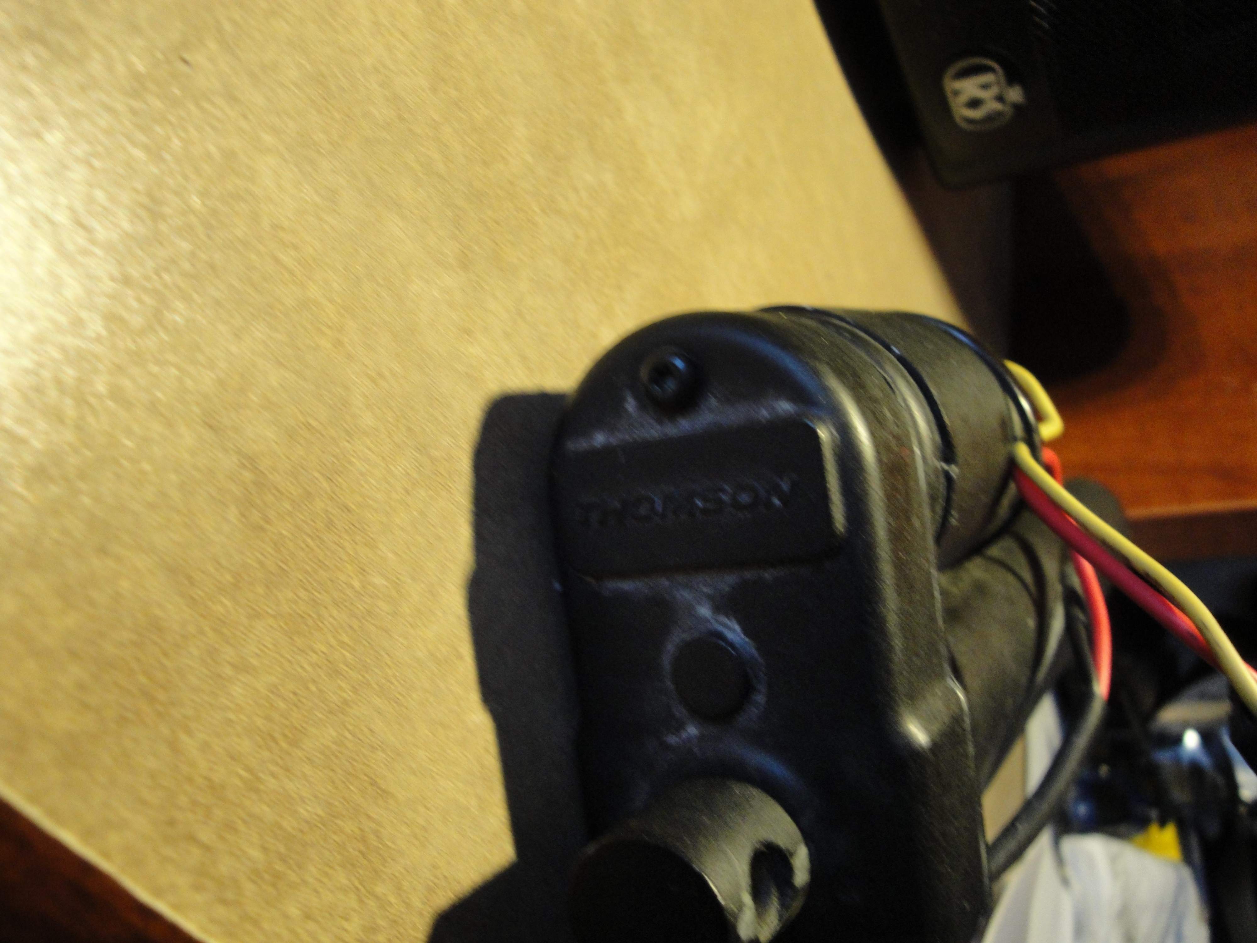

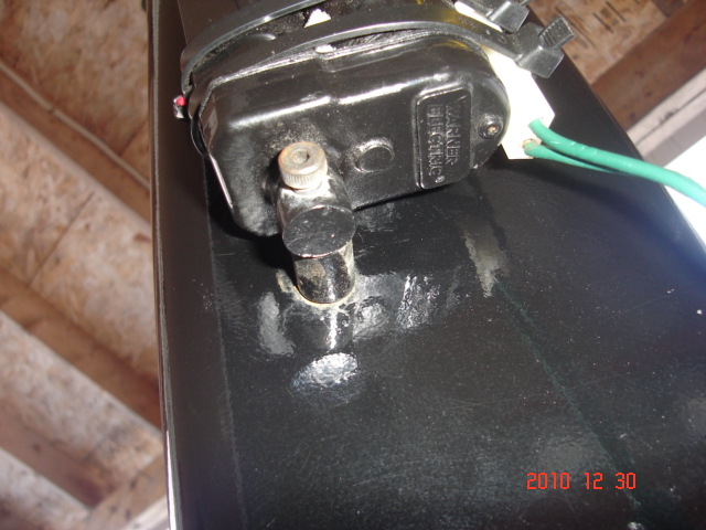

Hi Irvingj, I took off the actuator last night and brought it into the house as for some reason the actuator isn't retracting nor is there sign of it engaging at all, still extends though. The gears are perfectly dry but I'm hopeful it's a simple, frozen water in the motor, issue. If I recall this happened once last year as well after flipping the unit. I'll know very shortly. Update: The unit is functioning properly now.
Here's a couple photos of mine depicting the same stamp, and the embossed Thomson label.

   / 2360 Electric Chute Deflector Frozen #22
QUOTE: "Update: The unit is functioning properly now."
Curiouser and curiouser... a private label? Glad to hear yours is working again- what'd you have to do to get it to work?
