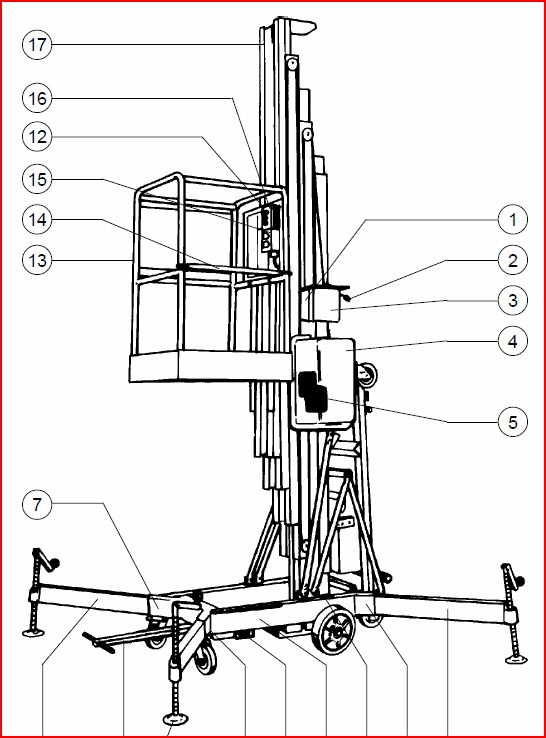

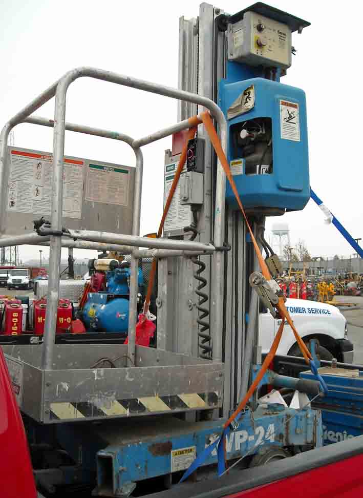

I started with a Genie AWP24 manlift, which I purchased used (and non-
operational) from my local rental yard. These units are designed to be
pushed around manually, then they telescope vertically with up to 300
pounds in the basket. Outriggers are attached and leveled first. The
third picture is from the operator's manual.
These units are pretty unwieldy, weighing in at about 650 lb. There are
also 19, 30, and 36-foot versions that use more or less sections in the
telescoping boom.

It was no easy task getting this home. It comes with forklift slots, but
they are set at the wrong spacing for my tractor forks. It is also quite
high as it sits in my truck. Fortunately, my boompole attachment to
my loader could reach and handle the weight. Unfortunately, this unit
would not stand up on its own on my slightly sloped paved parking area.
Naturally, it was raining during the unload process.

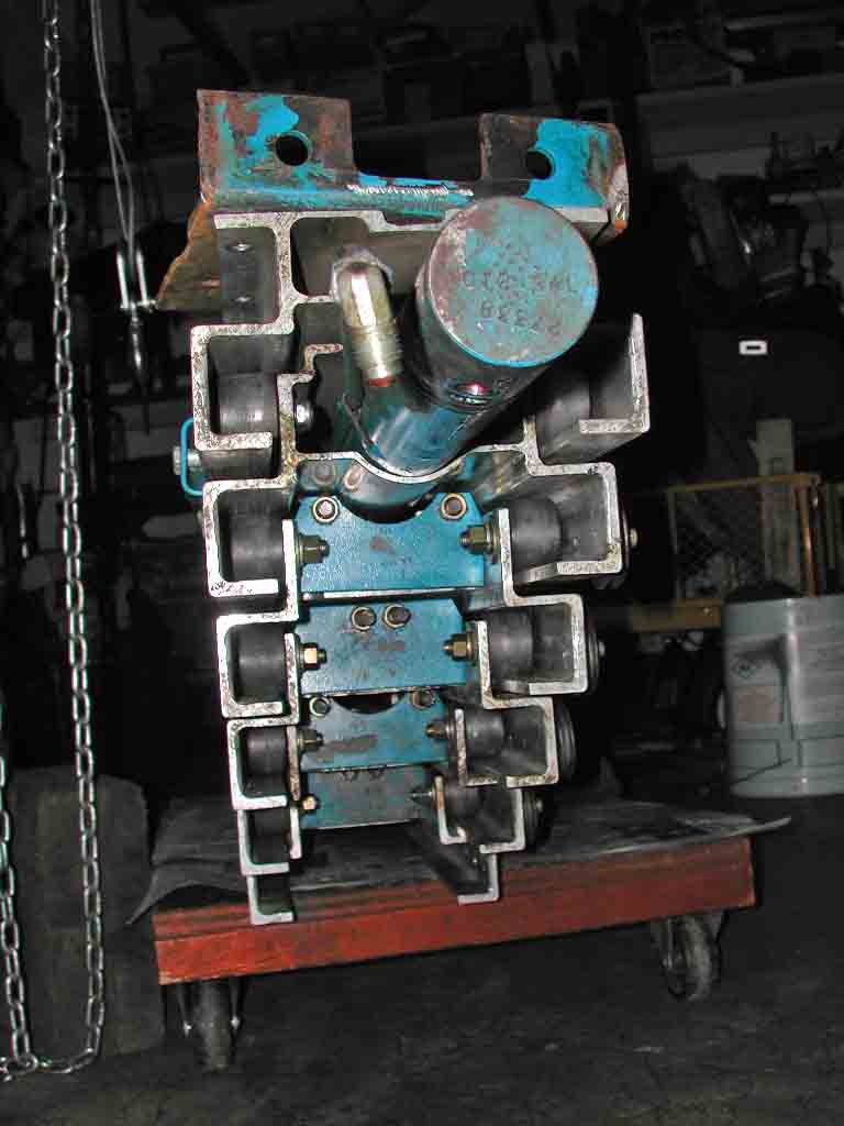

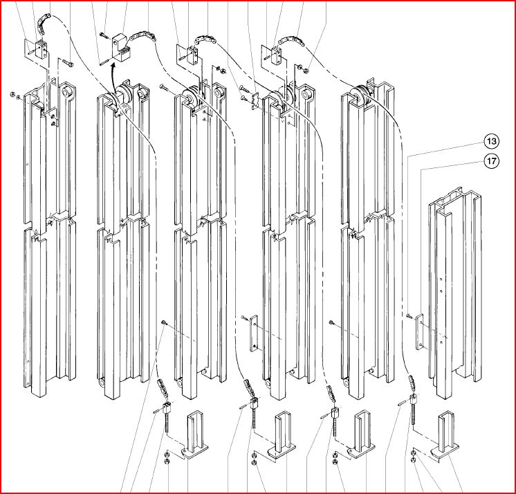

This is an amazing piece of engineering. How it works and how it comes
apart is NOT intuitive at all. (And I have spent a lifetime of taking things
apart!) A very long cylinder pushes on the 2nd of 5 telescoping stages,
which are linked by leaf chain, pulleys, and sequencing cables. The
service manual drawing shows the stages. In the 2nd image, you can see
a bottom view, after I have removed the support framework, drive, controls,
etc. Note the Nylatron rollers between each stage, and the blue plates
that anchor each pair of chains. The 3rd image is of a side view of the
telescoping assembly with the staging cables disconnected. An overhead
crane/hoist was absolutely required for this project.

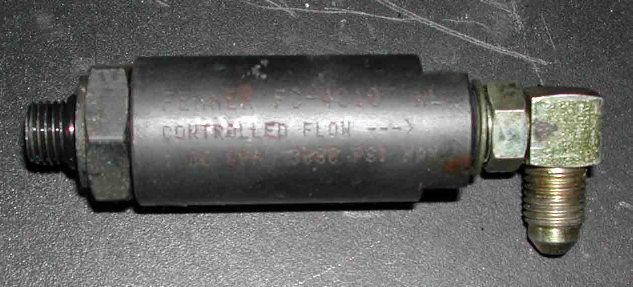

Here I am starting the disassembly of the telescoping stages.
After setting the assembly down flat, I removed the sequencing cables,
then pulled out the cylinder. The cylinder is almost 6 feet long
retracted, and about 10.5' extended. It has a 1 GPM piston-type
flow restrictor to control the retract speed without causing much
extend restriction. This is mounted to the base of the cylinder. The
cyl rod acts on the place marked with the yellow X in the 3rd photo.

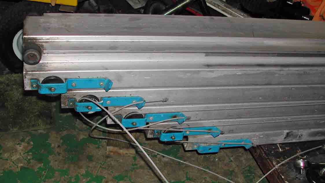

So far, so good. Then I ran into my first major problem. The brackets
that hold the pulley axles to the boom sections are hex socket
head bolts (photos), recessed into the aluminum boom. They did not want
to come out, using single allen wrenches, or ratcheting socket wrenches.
I broke one trying. I soaked them for days in PB Blaster, and even tried
impact tools. The only thing that eventually worked was repeated
heating/cooling with a propane torch. There were 16 of these. It took
over a month of re-visiting this project to get then all out. In the
midst of this effort, I found that virtually all of the plastic rollers (4 per
section) had frozen up on their shafts. You can see why in the photo.
Water had invaded them and caused rust. This meant that once the
chains, pulleys, shafts, and cables were removed, I needed to use a
come-along to pull the sections apart. The rollers had become skids.
I ended up buying 16 new roller shafts, and 5 or 6 new rollers. I reused
all the nuts, washers, shims, and roller caps.
