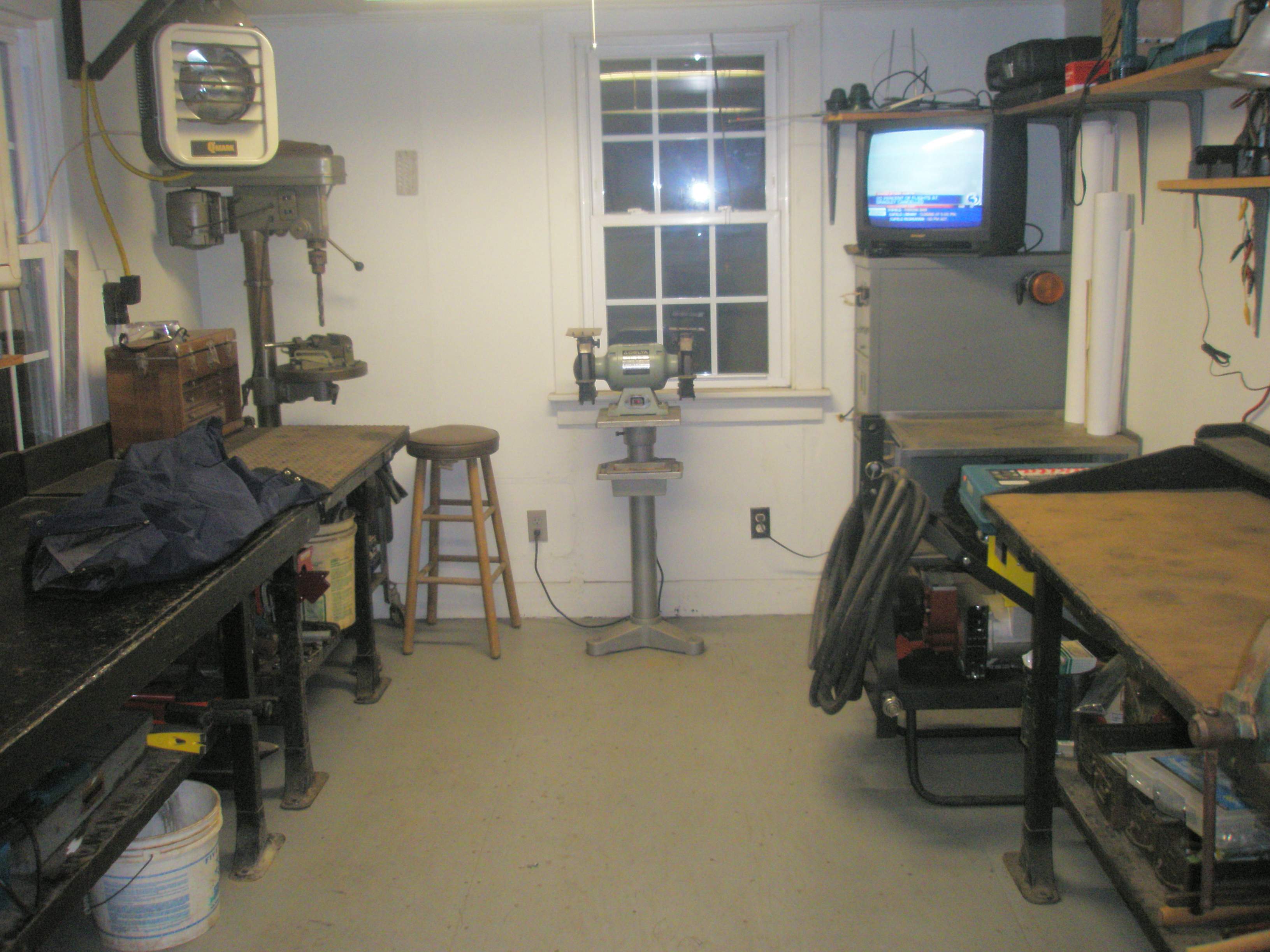

If it's rated 21 amp (That's 240 right?) then you will need a 30 amp breaker and 10 gauge wire to keep it within code. and safe.
I'm no electrician but that's what I believe. I've got an equivalent electric heater in my shop and it has performed flawlessly for 10 years.
Quark from Granger, see upper left in this picture. set it to a low setting just to keep the plumbing from freezing when I'm not there and it maintains perfectly.
This is a small shop, (basically built like a cape house) but it heats 3 rooms on the first floor and prevents plumbing in basement and bathroom from freezing.
JB
/ 240 or 120 Volt? #18
JB, nice heater, much safer than the chill-chaser floor type. Correct on the 30 amp breaker and #10 wiring.. Plus the plug on the cord to prevent exchanges on a 21 watt unit?
