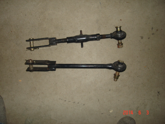

My lower arms are bent and although they work fine, I'd like to get replacements for them. Anyone have a good source for them?

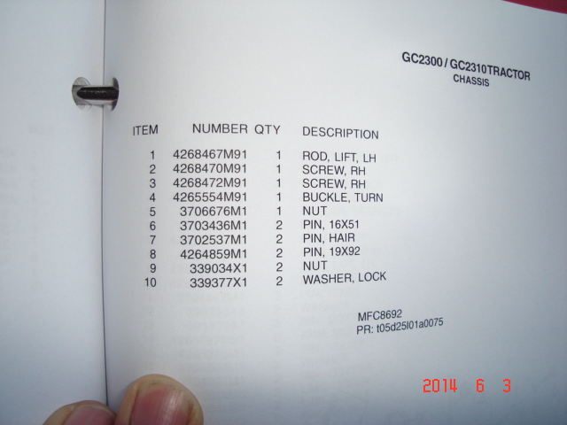

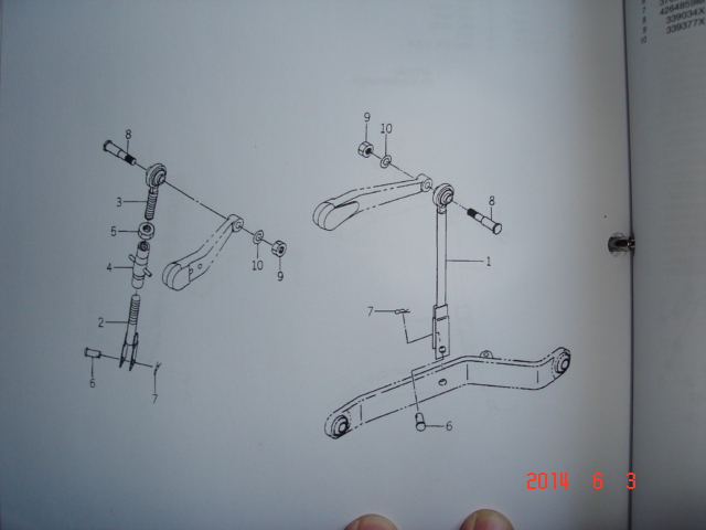

OK, I got it. Four options, perhaps:
1. They're "just" steel rods- first thing I'd do is lay them on something and pound on 'em. Maybe a torch would help. Nothing to lose, and they might very well come into it.
2. M-F parts as replacements.
3. I'd be willing to bet that, if you don't mind orange, Kubota parts might be interchangeable. Worth a look.
4. Somebody must make generic Cat-1 replacements (?).

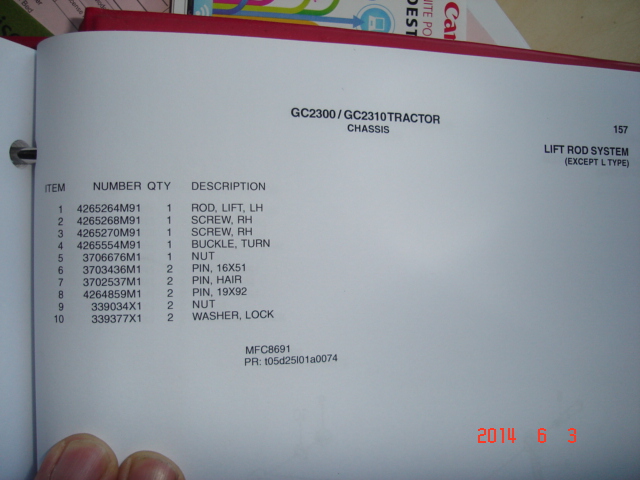

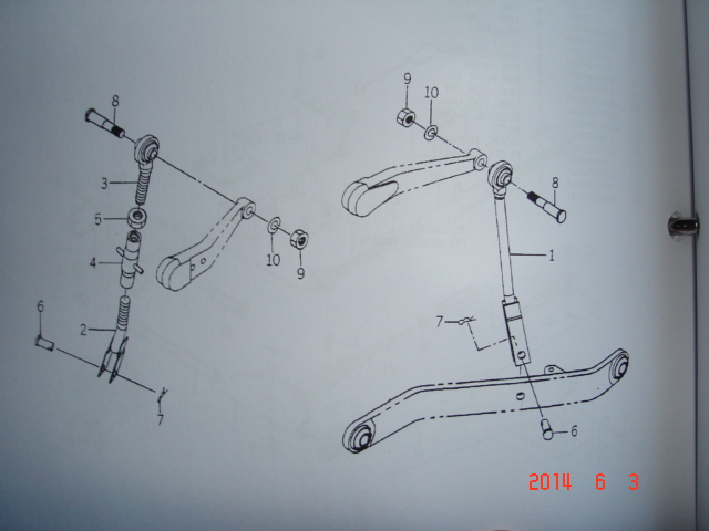

In the M-F parts book, those are called "lift rods." There are two types, "L-type" and "Except L-type". From the drawings, it appears the L-type lift rods are all straight, where the "Except L-type" have a bit of an offset angle at both ends. For what it's worth, mine is a 2007 model and uses the straight "L-type" parts. Not sure why the change, but there it is. To repeat-- when looking at the part numbers, the straight ones are the "L-type."
Here's some pics:
