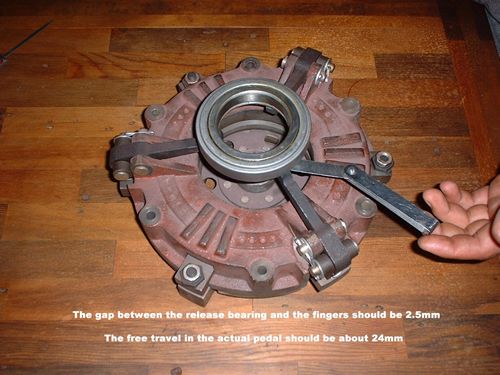

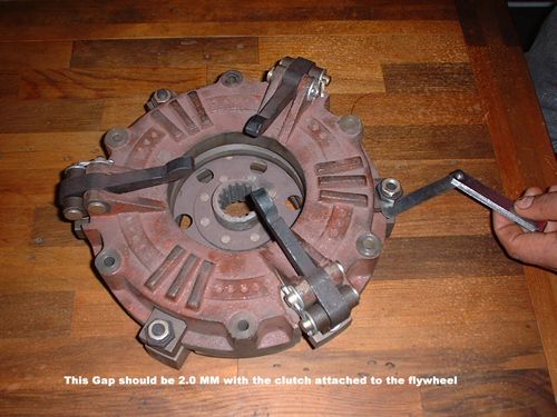

There is a "fixture" I'm told at one time that assists in setting up the clutch on the bench. I'm told it was/is a big plate to center the disc's to the pilot bearing and then a flenage that you measure to the throw-out bearing. Best description I can give as I've never seen it but understand the concept somewhat.
However, I'm sure you can do this adjustment on the bench or on the tractor. Your choice I guess. But, if it were me, I would pull the flywheel off and use that as my fixture. Bolt the pressure plate, center plate, and discs on flywheel doing a "eyeball" line-up. Then you can verify if the levers are correctly adjusted.
I'm going to include a few pics to show the concept. Please don't use the spec's listed as I'm not sure if they are the same as your model. This is just an example as if it were bolted to the flywheel, special fixture or engine.
I hope this helps.
Maybe others can add to this.
Regards, Harry

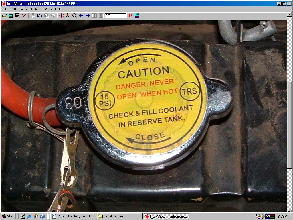

Ed_B said:
One other question off subject: Radiator cap. Anyone got a U.S. part number?
The OE cap probably has a 0.3 stamped on it. This is the metric equivalent of a 4.3 psi cap. Not sure if that rating is even available in an American aftermarket cap, but the correct diameter cap is readily available in most auto parts store chains. I just took my OE cap into an AutoZone and found a matching size in 7 psi. Think there was a 9 psi hanging right alongside, but I went with the closest to OE pressure rating.
Avoid the higher pressure caps, they're for automotive systems designed for much higher operating temperatures than your 80C diesel. Doing so will likely cause coolant weep around the seams/gaskets/clamps.

   / 2425 Split in two, new clutch discs on the way. #9
My 05 284 came with a 15 PSI cap.
