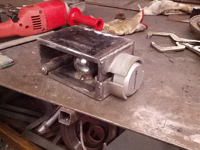

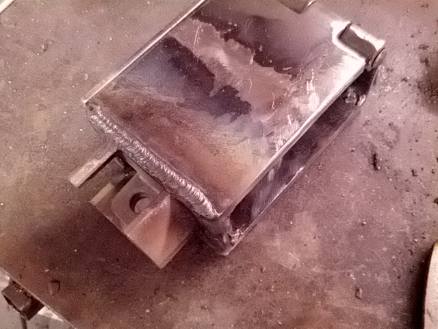

If you are talking about the hing it is plug welded to the front plate so you would need a drill too. Then the pin cant go back becuase the lever is in the way. You would have to pound it from the back at an angle with the lever in the way too. Even if you got that fare the lock would hold the top in place so you couldn't push the lever down to release the ball our drop the bottem plate staight down 3" ether. Honestly i built this the way i did because everyone attacks the hinges first. Even if you cut the hinge completly off you still couldnt get this off with out removeing the lock. The hinge is only there to aid in taking it off and puting it on. There is a much better way if you know were to cut it. But you give crack heads and theifs to much credit though. The last time i saw one with a grinder or a drill he was in line at the pawn shop trying to sell it.

The coupler OP posted does have a small tab underneath the release lever where a lock can be placed, but it seems like an afterthought. Any trailer using a coupler like that is likely so heavy it would probably stay sitting on top of ball with the latch closed for a short trip anyway.
We have one on a trailer here at work and I haven't figured out a really good way to lock it, except leaving the truck and trailer hooked together whenever it leaves the lot. We also have a wheel-boot for it. And an insurance policy LOL.
