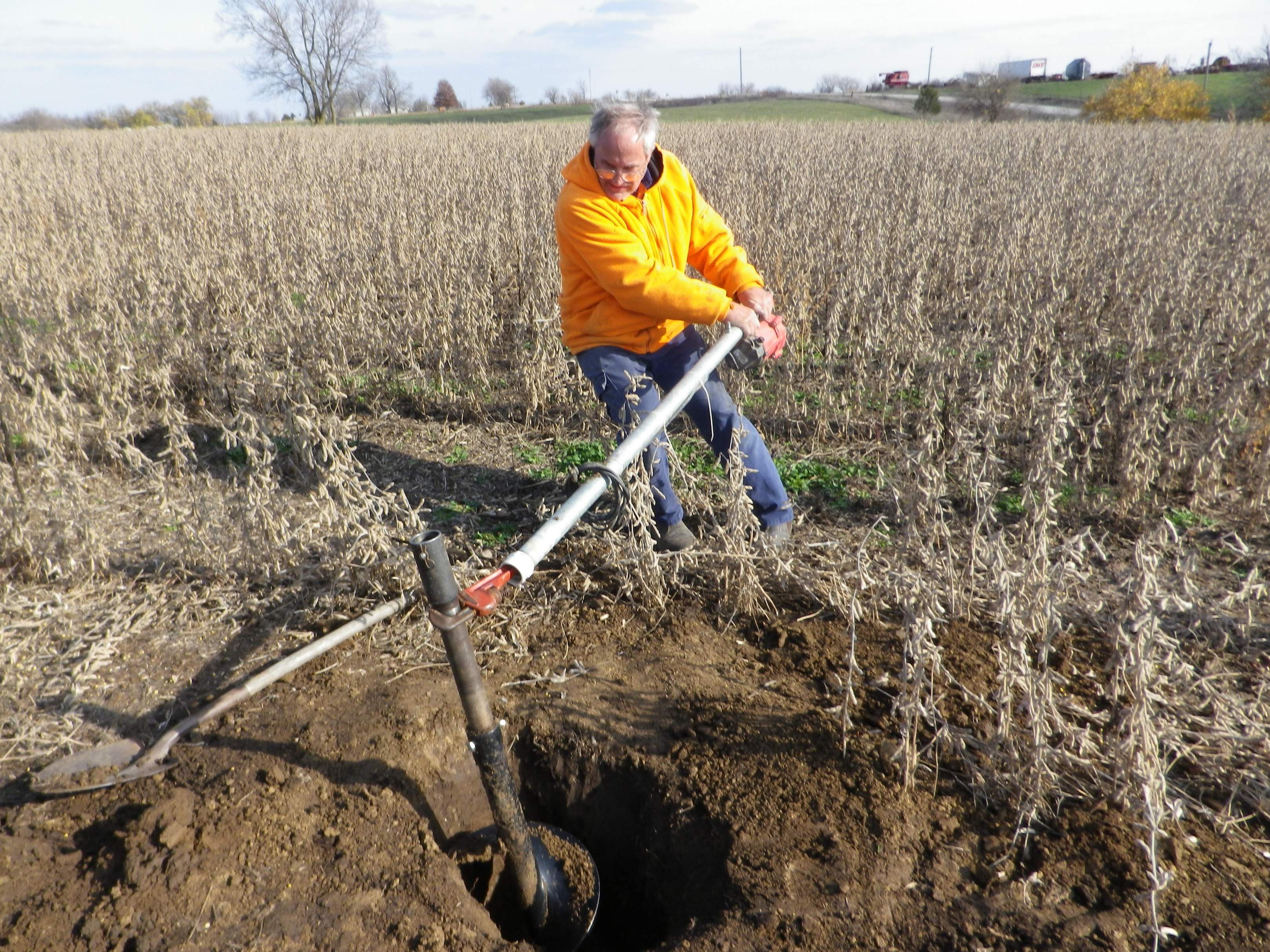

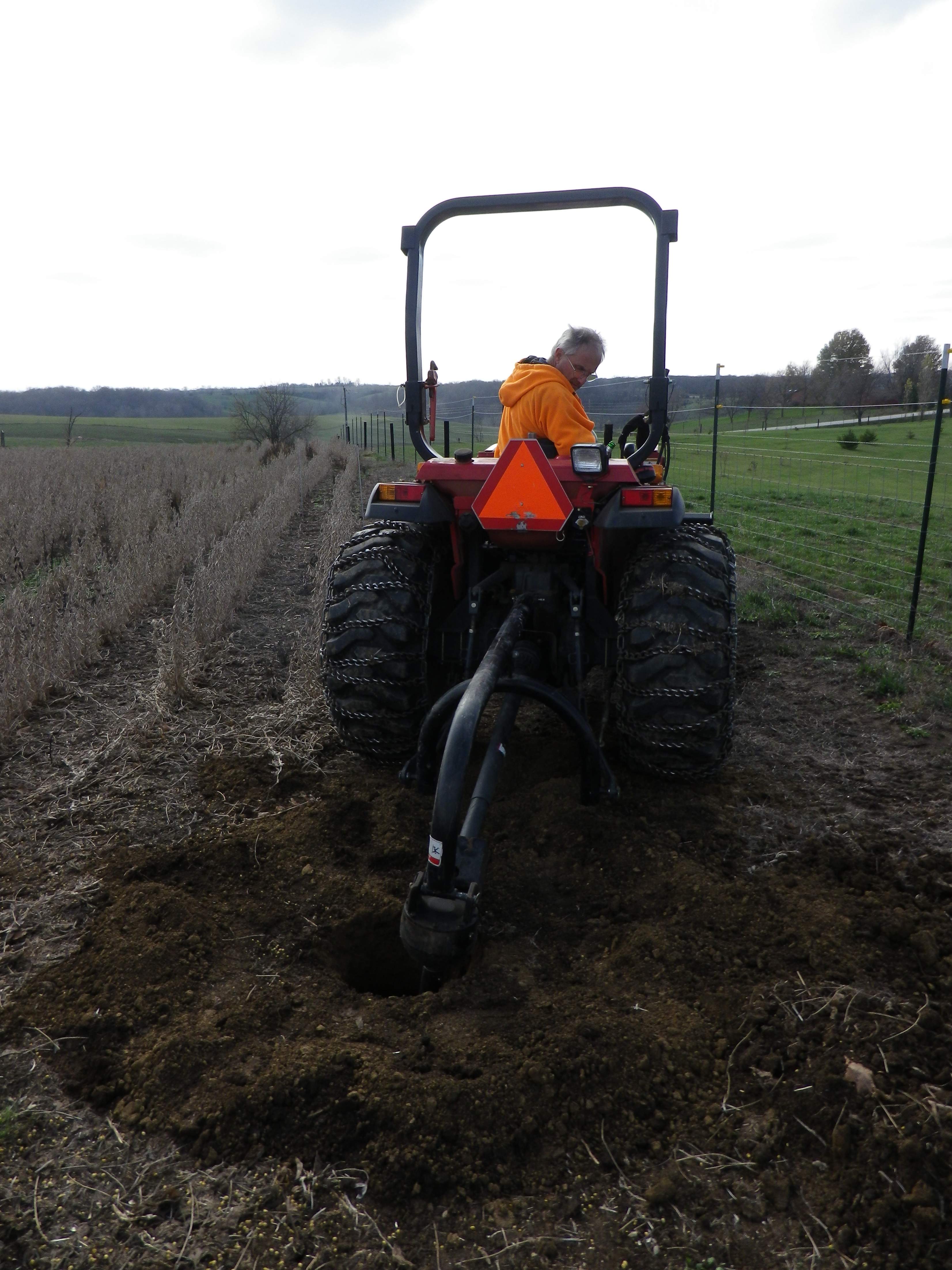

Drilling 5ft deep holes.

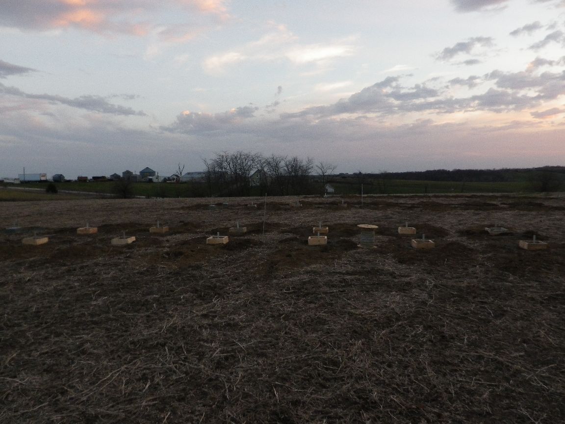

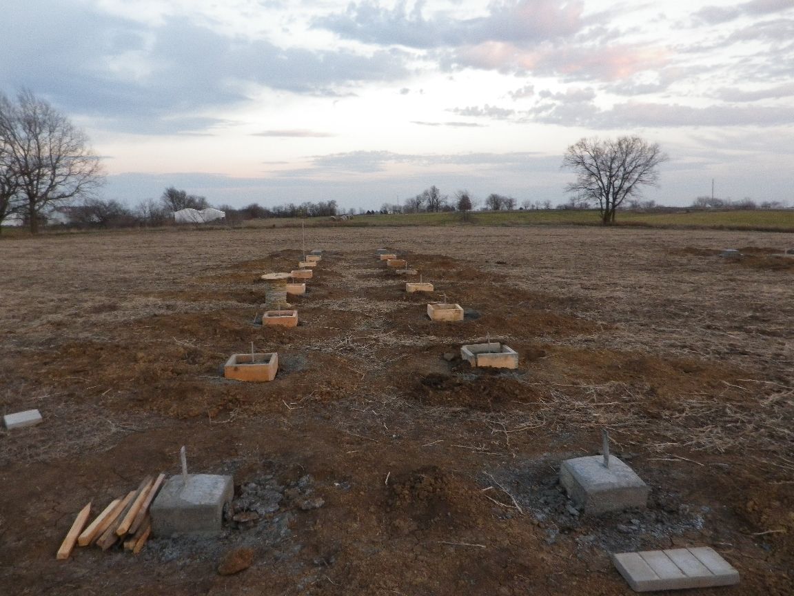

Panels, Inverters, Ephase cable and bunch of small grounding parts are in. Still waiting for rails, clamps etc, galvanized bolts and main cable for connection to the grid. Still has to finish 24 concrete (out of 52) footings but got caught by cold weather. Hoping to have them finshed Wednesday and Thursday. By then the footing for first bank will be cured enough to start building the supporting structure for the panels.
