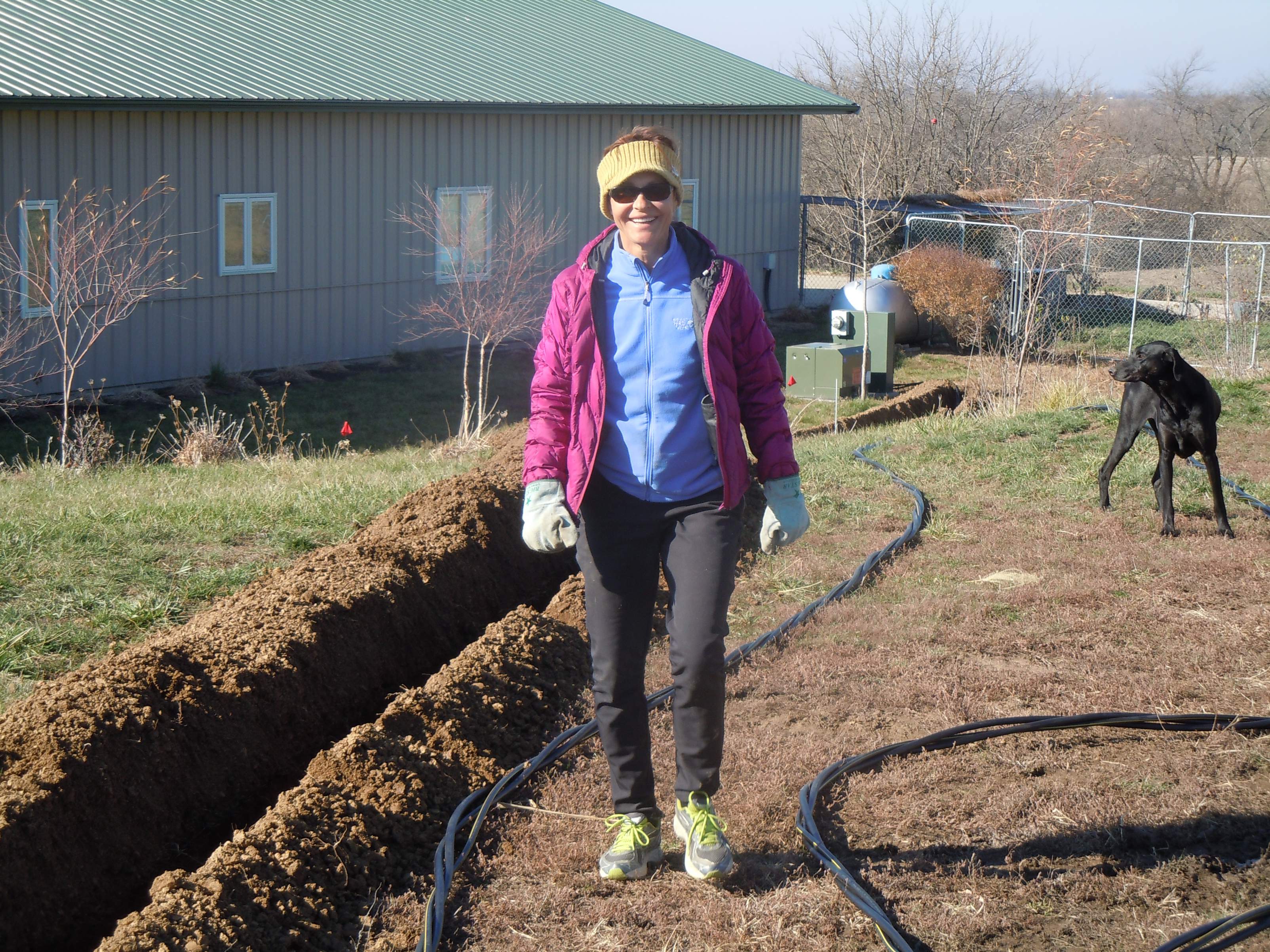

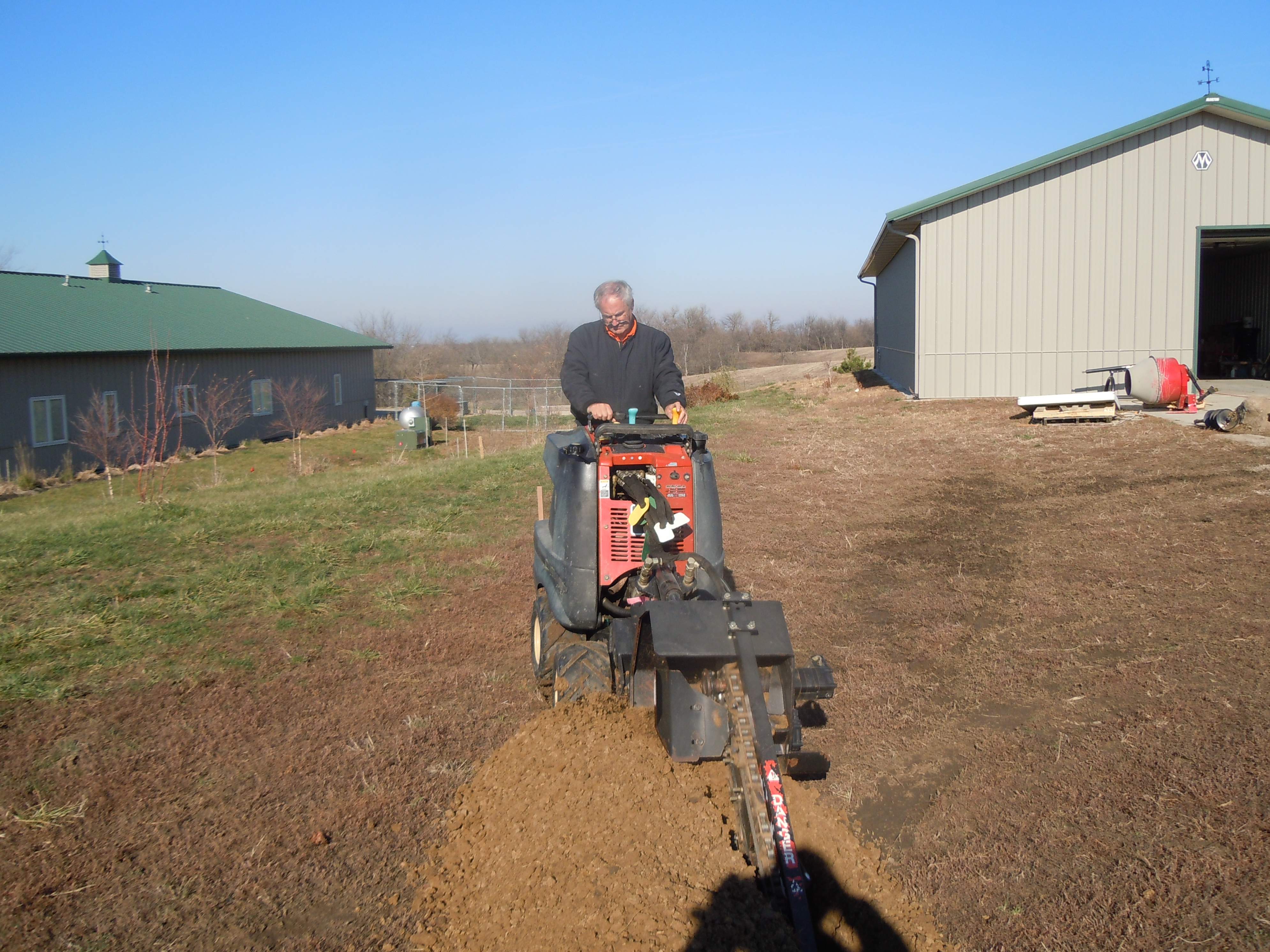

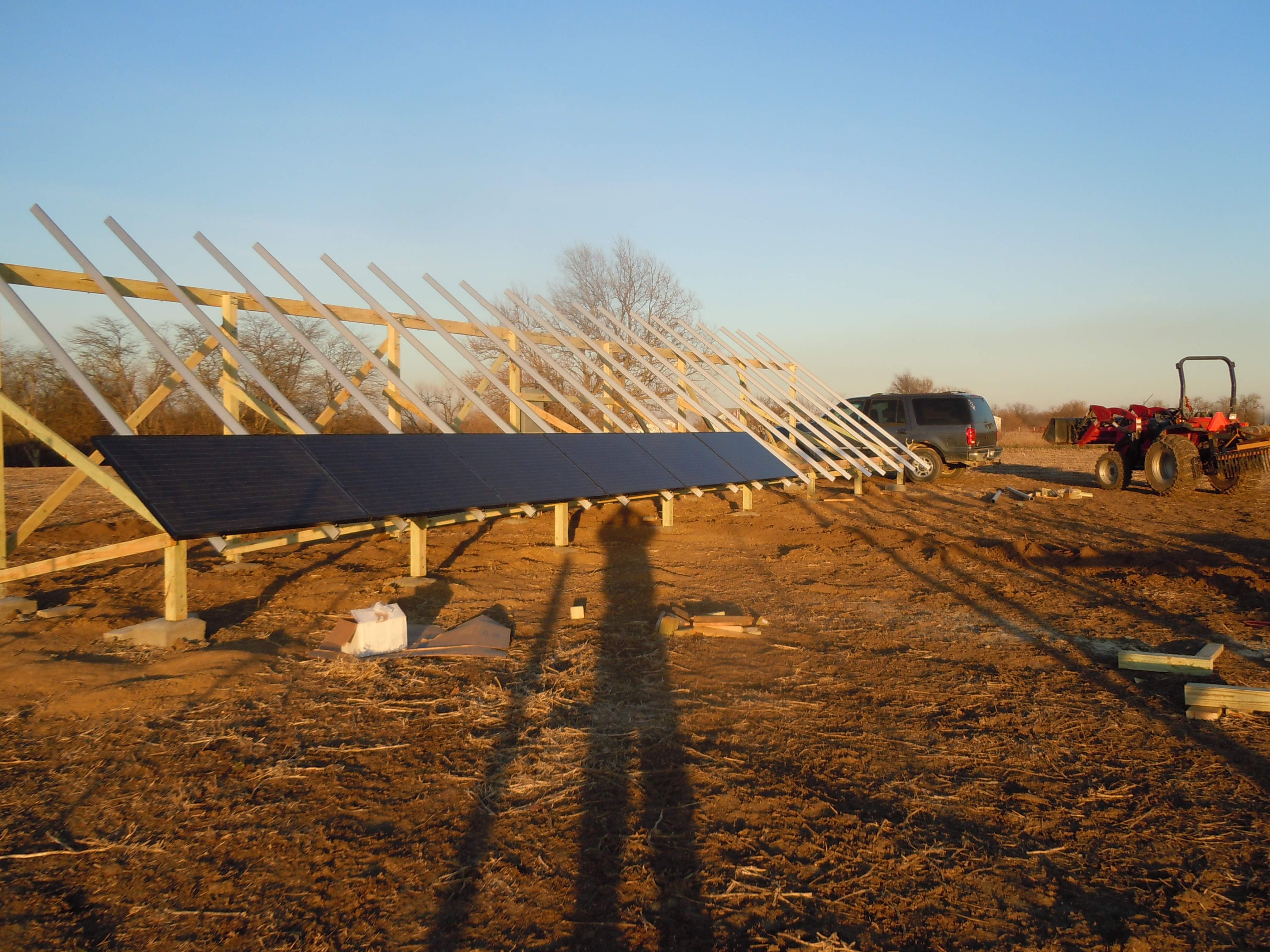

We have supporting structure for one bank of panels ( for 30 panels) completely built, main cable laid in the trench and main safety switch We started installing panels but found that the inverters came without mounting screws. I ordered the screws about a week ago but still didn't receive them so the effort somewhat stalled because the inverters and the grounding lugs have to be installed after first row of panels is in. So far we lucked out with the weather but it seems to me that we will be able to finish two banks (out of three) before I get sent to my next work assignment.
Digging trench
The boss
Laying the cable

From what I can see in your last photo of the rack, I would be very concerned about wind loading.
Yes, wind loading is an issue here. The footings are 5ft deep poured concrete about 80" apart. The wooden structure is all braced and bolted together. I went to Unirack web site and designed the racking on their program and then made it out of wood. There is room for four landscape rows but I will install only three lower rows on each bank.
You have very nice place. How is your system performing? Does it meet predicted and/or expected production? Are you on or off grid? Do you use industrial racking or DIY? How did you select the angle? Any technical specs you can provide?
The bracing and bolts were not discern-able in the photo. Perhaps a detail shot would help. If the engineering behind the Unirack design carries over to your wood version, you should be fine.

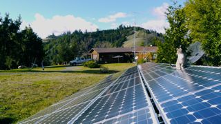

Mine is a grid-tied system and is producing as expected. May-October, it produces 30-45kwh/day. Because of California's tiered time of use rate structure, I am selling most of that power to PG&E at their extremely high peak rates, about $0.35/kwh. In the winter (and after dark) I am buying at their lowest rates, $0.08-0.12/kwh. Thus the panel angle was chosen to maximize summer production. What used to be a $3600 annual electricity bill is now about $150.

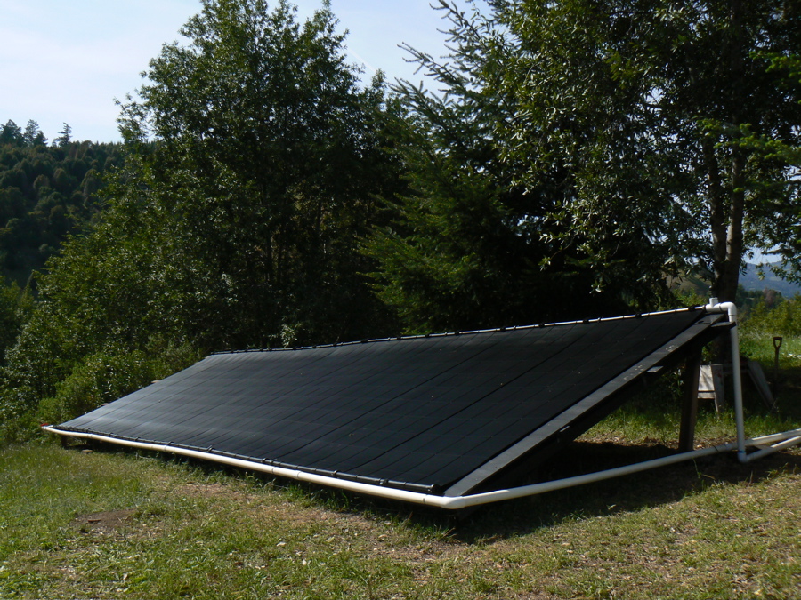

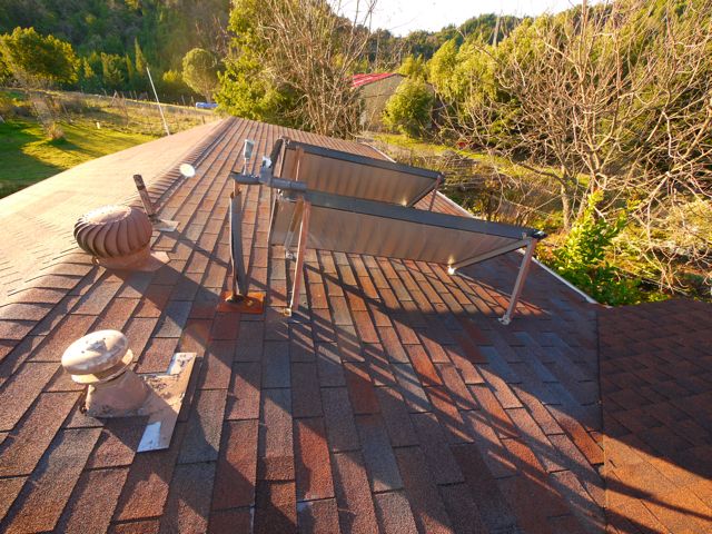

Twenty years ago, I put a 2 panel domestic hot water system on the roof using a commercial system which I acquired 2nd hand for $250. I estimate it has saved me over $7500 in propane over that time.
Another system for the swimming pool keeps it at 80-90'F from May through October.
The week after I finished mine, we had record breaking winds for our area. Not tornado force, but close. Took out one of my big maples and flattened two sheds... I called the wife from the office and told to get her ***** out there to see what was happening to the array! :laughing:
Didn't even leave witness marks in the backfill around the poles, but frig I was trippin for a while. Didn't have insurance on them at that point either....
