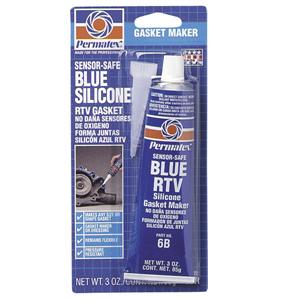

I've decided to use 1" OD poly pipe instead of PVC, based on info and suggestions from this and other threads on other sites. I've already ordered the 18 ga tracer wire. I plan to use 200 psi pipe and put it inside a 3" or 4" drain pipe for protection against rocks, as discussed in several messages above.
My plan is to use brass fittings with dual (or triple) all SS hose clamps, plus that blue RTV stuff, I forget the name of it. Anyone have any other good suggestions for connecting poly pipe?
   / 250' water line: got some questions #66
I think they call that blue RTV stuff Blue RTV. :laughing:

Brass fittings IMO are pretty unnecessary, the nylon insert fittings work just as well. I have several thousand feet now of 1"-1.5" poly buried. With the 1" pipe, I use cinch clamps which are much cheaper and faster than the hose clamps.

I tend to believe in putting together a connection as it was intended not adding a bunch of belts and suspenders which may inadvertantly interat in a negative way with the intent of the design.
that is to say poly hose with barbed fittings seals via an interaction between the barbed fitting and the hose. The external clamps just secure it. Adding something else inside the joint may interfere. Therefore I would go with your idea of brass fittings in poly hose with stainless steel clamps. The poly fittings I had in my waterline failed after 35 years but then the new poly fittings are much better than what they were 35 years ago. Your choice but I would go with the brass and be sure and of course you want stainless clamps because you do not want them rusting away either. Simple, complete as intended and done. No worries!
