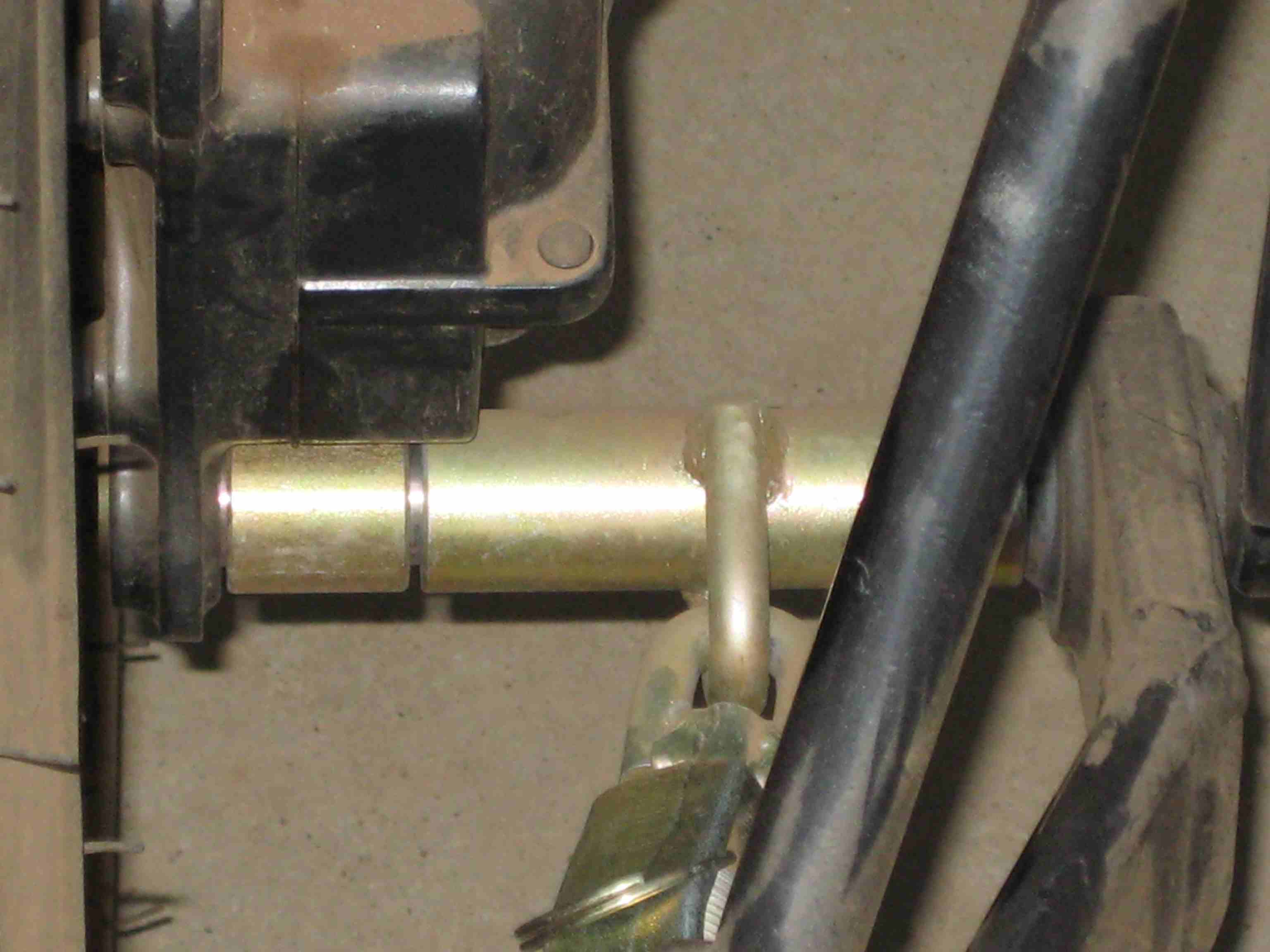

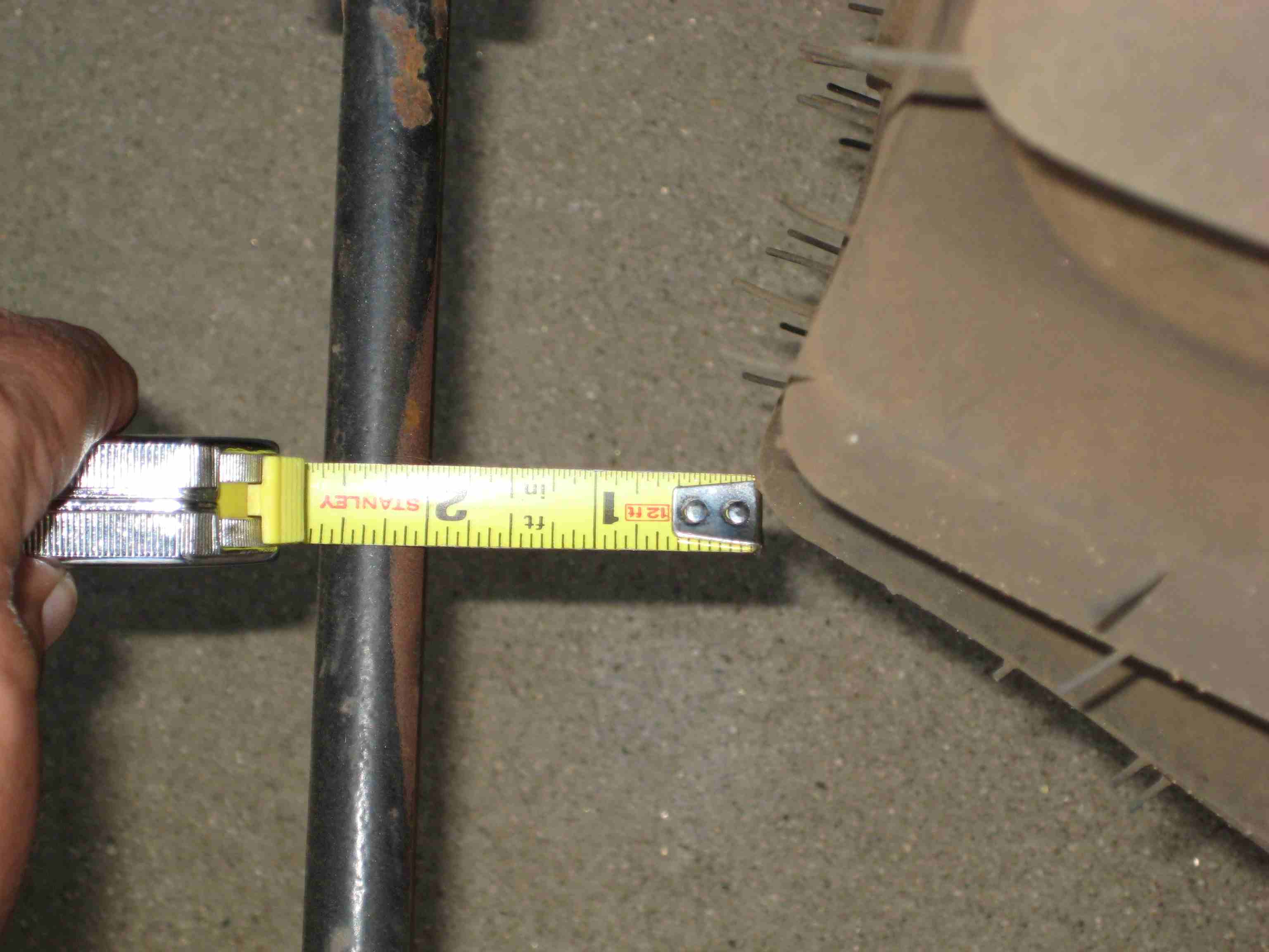

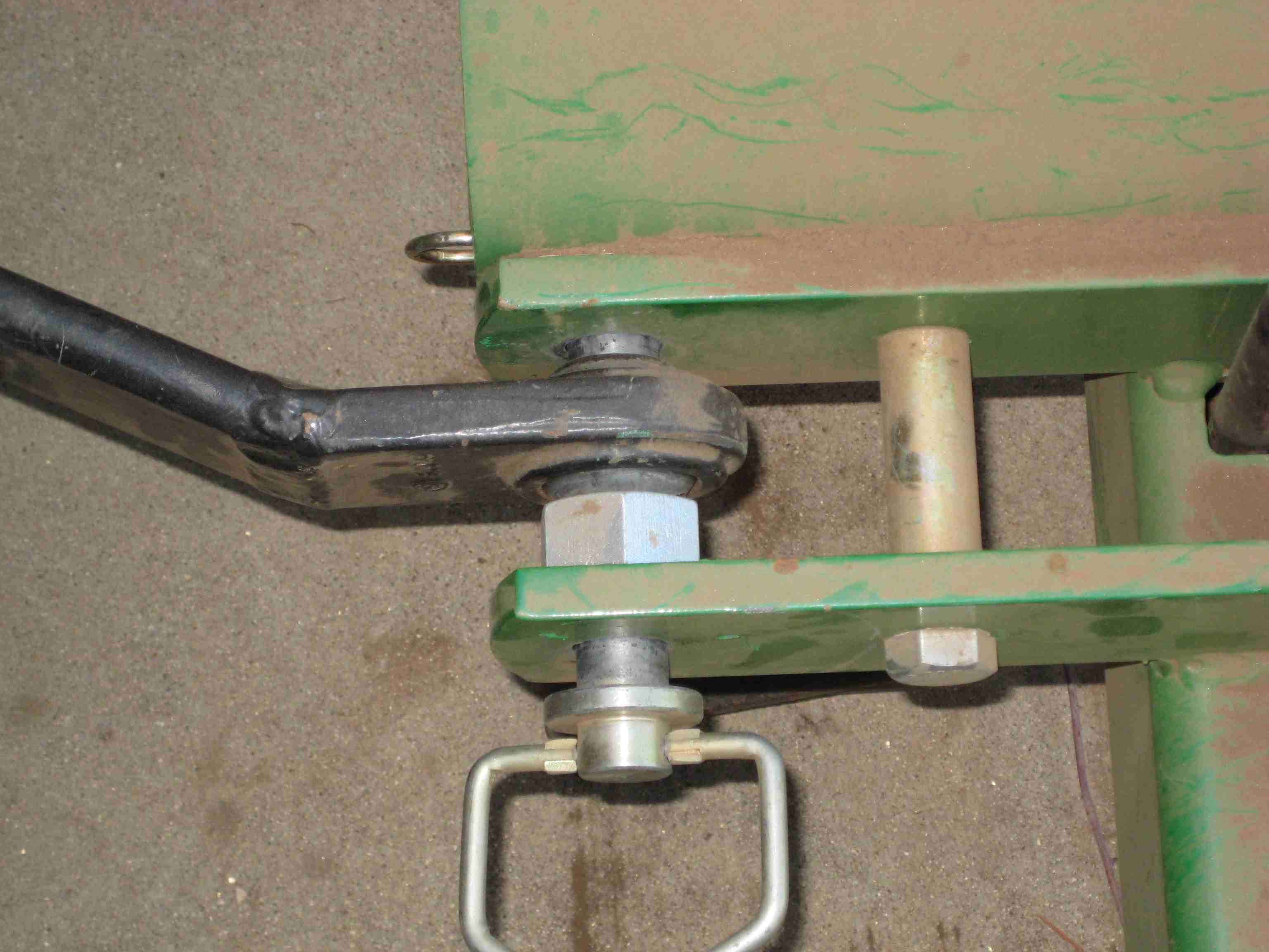

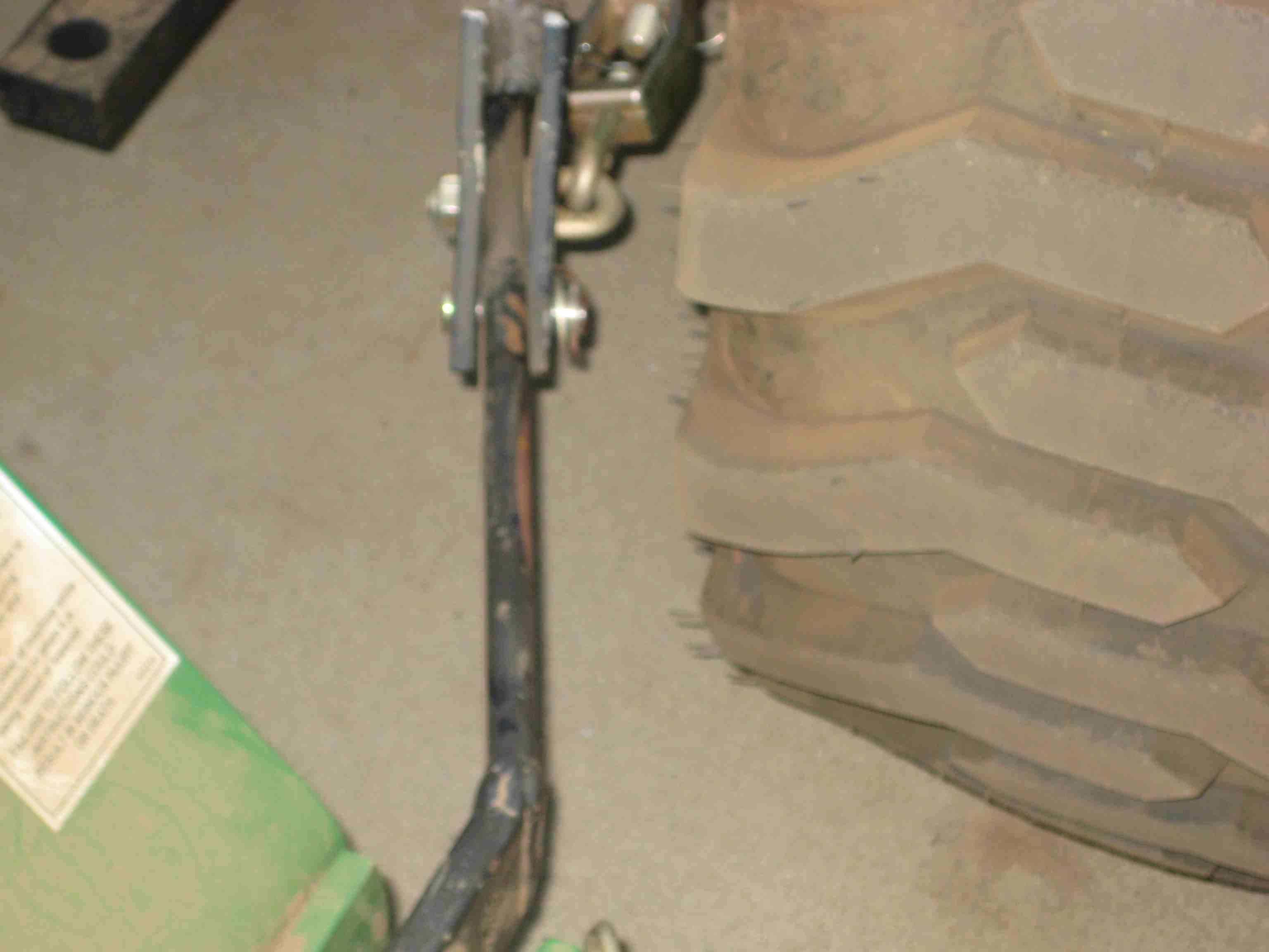

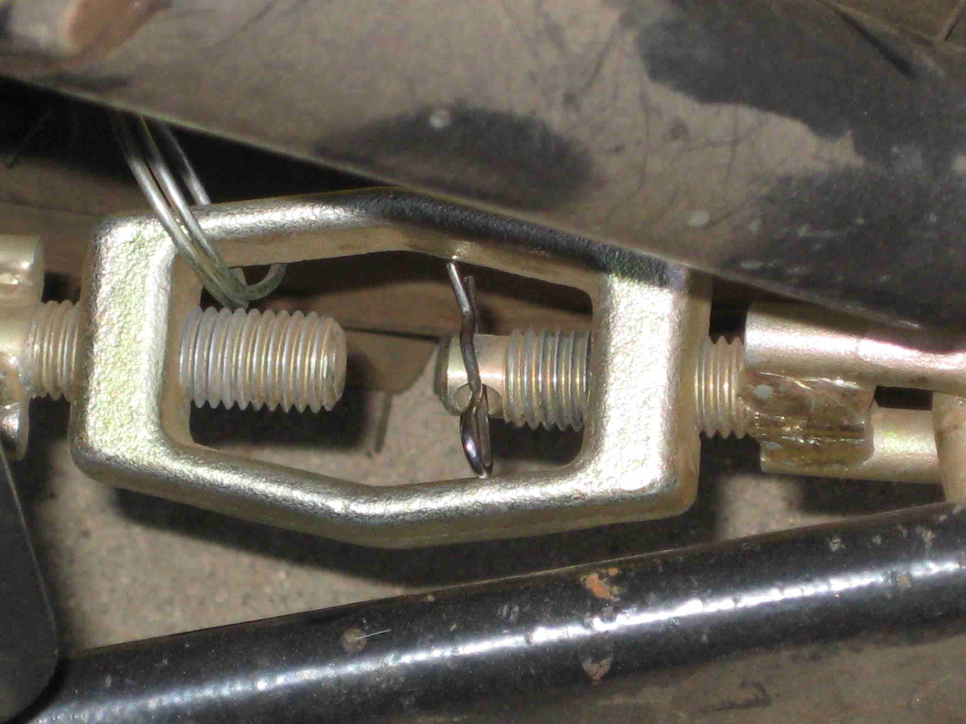

I took some photos of the clearance on my 2520. Measured the space and have 2 inches both sides with full deflection left or right. Pictures show turnbuckle mount, pins in turnbuckle and I have added a large nut as a spacer on the box blade hitch pins to force the arms in.

NOW, go raise the arms all the way and measure again! :D
Now you'll be at the tight point, and mine MIGHT have a 3/4 inch if the planets all allign! :cool:
   / 2520 3 Point hitch hit R-4 tires #19
With the tires set to the widest point. and arms all the way up. you will never see 3/4 of an inch
maybe a hafe , if your lucky. but if you set it right. it still wont rub...;)
Chris....:)
   / 2520 3 Point hitch hit R-4 tires #20
I flipped the wheels, so I gained about 1/4 on each side there too! :D
