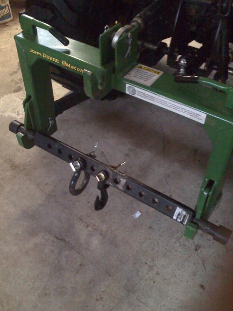

It was hard to believe that John Deere let a tractor be released with a clearance problem on the the 3 point hitch. I made a set of 1.5" wide wheel spacers to take care of this issue.I read all the posted sites after I purchased
my tractor and it would of been nice to know before hand that this was a problem.I don't know if the 1.5" extra width is going to cause stress on axles and would like to know someone else opinion on this. I made spacers 8" dia.
with counterbore for hub and a boss for the rim and reversed tires from
side to side so I gained a inner tire width measurement of 30" anybody
have same issue or suggestions? Thanks

Get an I-MATCH, and mount the 3 point arms on the inside of the I-Match. Mine has like 3 inches of clearance on each side.
Its no big deal, and most definately LESS Stress on the rear end of the tractor than by having huge spacers.
/ 2520 clearance 3 point #4
OOppppppssss, I see my 3 point arms were still in the standard position in that pic, so disreguard that. Just mount them on the inside now.

The Kioti CK20 has this problem, too.
I fixed it the way JD approached it, less the hundreds of dollars.
Leaving the lift arms on the tractor, I looped a chain around the middle
of them, about where the lift links attach. Then I took my 4-ton "porta-
power" hydraulic cylinder and placed it between the 2 swivel eyes on the
ends of the lift arms. I then bent the arms outward about 1-2 inches.
Works great, now. You can get a "porta-power" like this from Harbor Freight
for under $100.

I'm going to state my position up front, I feel that these should be either covered under warrantee as a defective part or as a product recall replacement. I have set my tires to the recommended wide position and used an I-match and still have clearance issues. To me, the product was delivered from the factory with limited functionality because of the defective design of the lower 3pt arms which the factory has subsequently redesigned and released a replacement part to alleviate the defect.
