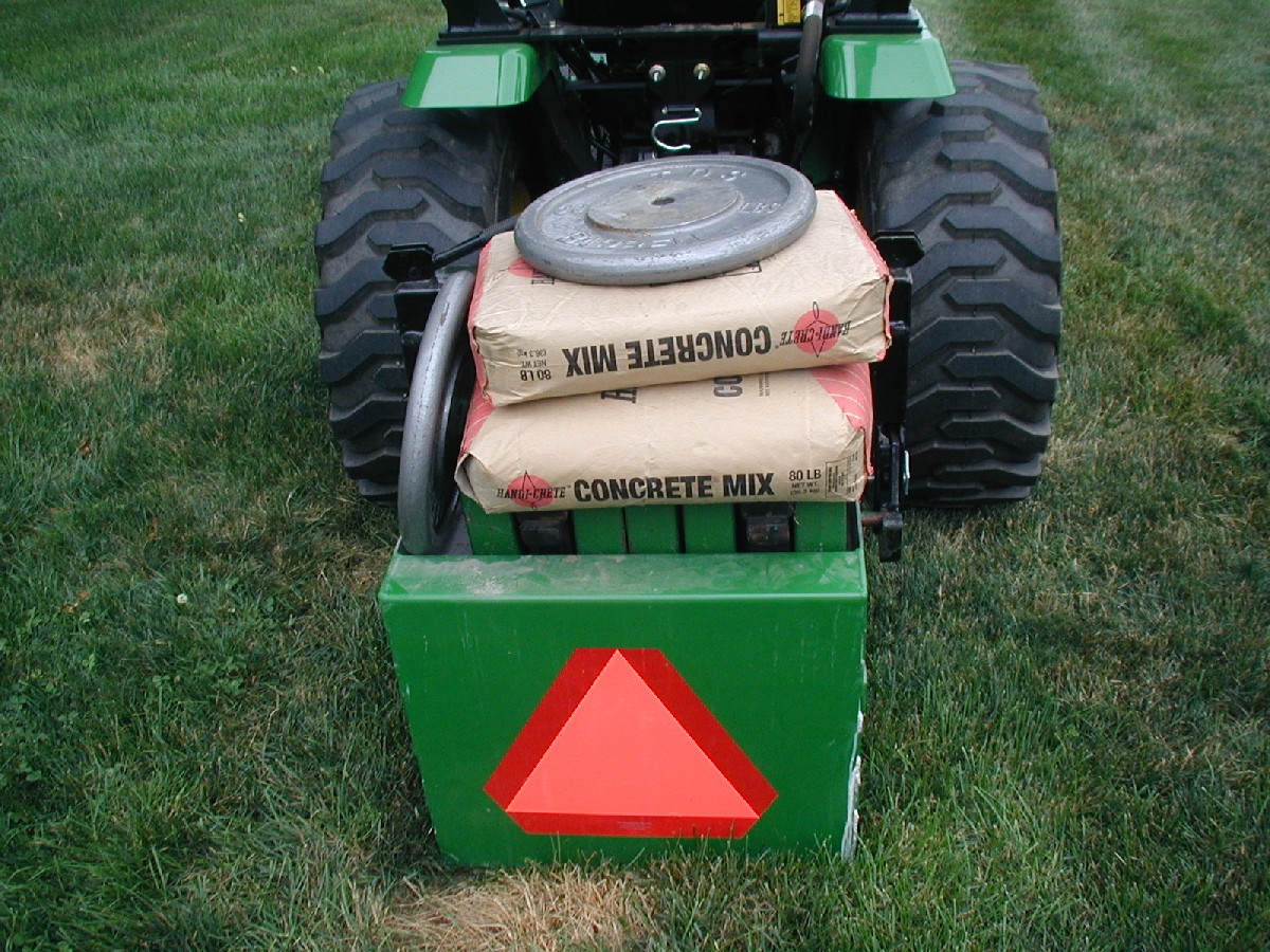

The key is using the correct amount of ballast - using a BH and loaded tires resolves the ballast question for most. However taking a page out of Chris2520's book, I threw on my ballast box loaded with portland cement (best guess 800 lbs -900 lbs conservative) and added on another 540 lbs. Total around 1340-1440 lbs, and I ran out of weight before I did with hydrolics. This surpasses the spec of 1,150 lbs by a signifcant margin.
As for the 200cx and whats the weight of a filled heaped bucket, my guess is about 1,100 lbs. I have to get that into my F550 dump bed, so max height is critical. My 4100 had to do the same
