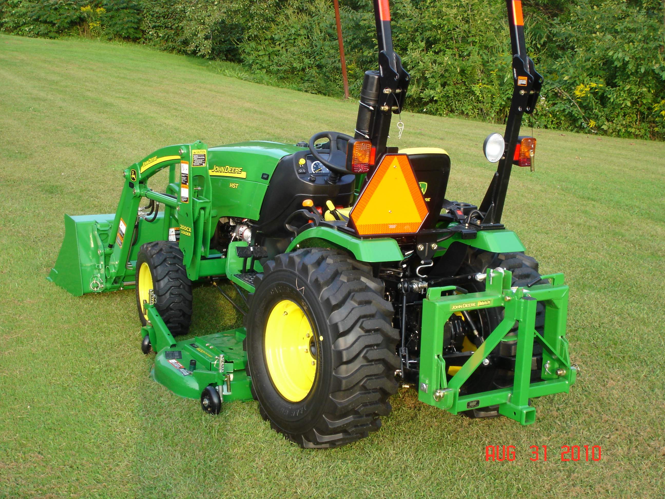

Thanks,for the info. My main concern is having the 3point hitch going up and down with the mower deck. I'm going to have a quick hitch onto the 3point hitch and I don't want that riding close to the ground.
/ 2520 mmm question #5
If you are you talking about the "I" match hitch, at it's lowest point, it is well off the ground.
I have the 2" reciever hitch, that attaches to my "I" match, and I leave it on all the time. It just goes up and down with the deck. Doesn't interfere with anything.

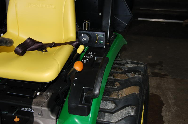

My 2520 has independent lift, and yes, the height adjustment is to the left of the seat, on top of the fender. It's basically a knob attached to a cable that runs down through the fender and attaches to the lift mechanism so as to limit it's travel. I use it to lock the deck all the way up, or to lock the lift up when the deck is not attached.
I'm also glad I have the diverter valve so that I can switch hydraulic functions without switching the hose connections. That way, when I forget to lift the deck all the way up after attaching the FEL, I don't have to say bad words.
