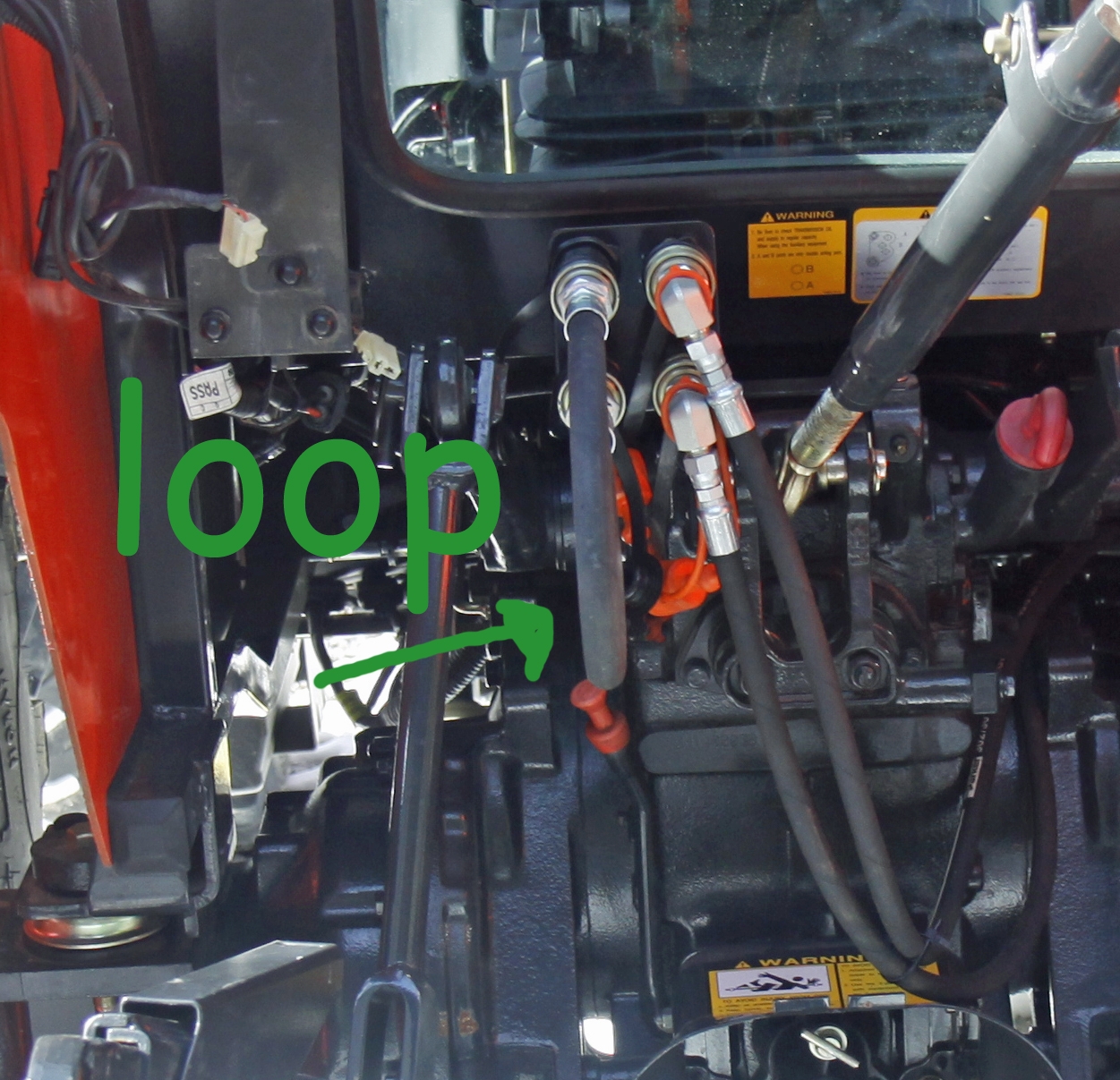

Ok, the hose they installed is not a problem. It prevents bogging down hydraulic system if button on joystick is accidentally pushed with no attachment hooked up.
I installed a switch to shut down 3rd function system when nothing is attached.
I use a jumper hose like this on my rear hydraulic hook up that works on the detent system so i dont accidentally deadhead the system.
I think the 3rd function is not hooked up properly.

Whoever thought that loop fixed any is an idiot.
