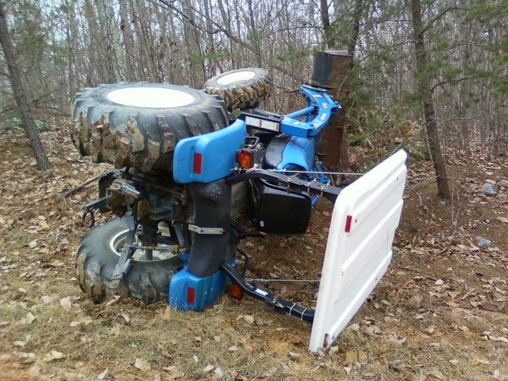

No load in the bucket.
No liquid in the tires.
No weight on the 3PH.
All it took was a steep hill, slippery ground, and an operator that didn't use enough sense.
