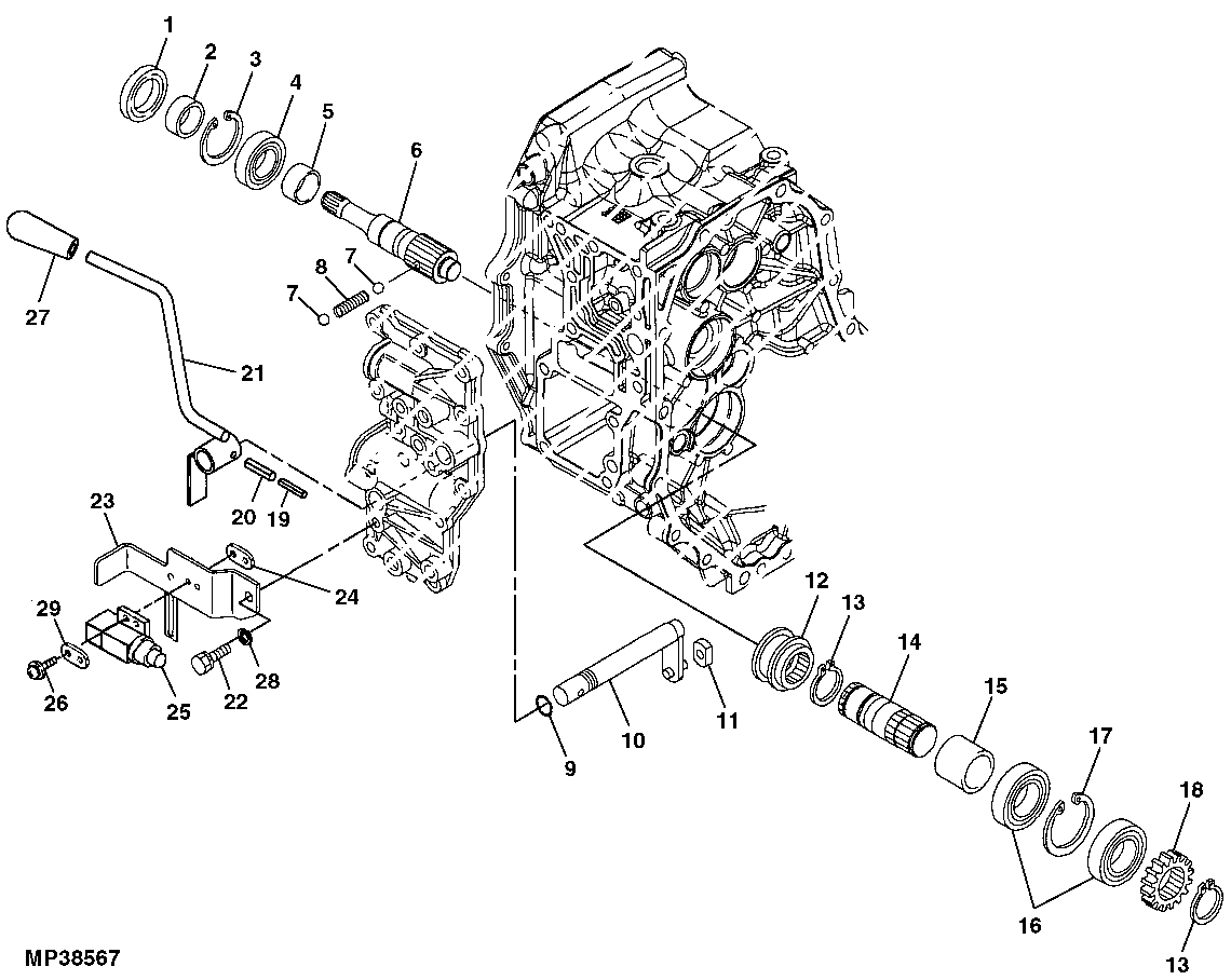

I got my tractor back and so far so good. It hasn't popped out of 4wd since I got it back this most recent time. I talked to the mechanic and he said that he replaced a part called a "button". Aparently that part pushes against the detent. He said that he saw some issues with it that he didn't see the first time he took it apart. The good news is that he didn't have to split the tractor to replace, he was able to replace it by just taking off the side cover of the transmission where the 4wd shifter goes in. Maybe the new "button" and/or the tire pressure changes have solved the problem. I'm keeping my fingers crossed.

Does anyone have a schematic they can post on here to see what this button is?

No button in the repair manual. ZR7400 said that they removed this section so the part should be in this section.
The air pressure sure sounds like someone fishing for an excuse. Remember the front to rear ratio is already 1.538 which is set by gearing and the loaded radius is not going to change significantly to cause an issue (unless you run your tractor with the front tires flat). But even with that said the ratio front to back when considering tire combinations has a "window" of acceptability and not a set standard to compensate for manufacturing differences in tires.

Hey Tom
Here is the parts breakdown.I wonder if it's the item listed as #7.
It's listed as a ball,and there are two.
Maybe that spring between them is too weak.Who knows.
There is no part listed as a "button" though.
Greg

Thanks Greg, that was the picture I tried to post as a link but obviously my link did nothing.:laughing:
I wonder if you can get to #7 by just removing the side plate. The repair manual does say to be careful with these on assembly as they can come loose.
ZR7400 had said, "The 4wd lever now goes clear to the floor board and there is no longer any detent clicks, just a smooth glide from the the 2wd position to the floor."
So I would guess that the lever was no longer engaging the collar (#11 and #12). If I were to continue to guess, the button was #11 and was either missing or not placed back into the collar and that is what allowed the lever to move freely. Like I said just a guess since 4wd did not work at all.

I'm now wondering what my mechanic was talking about. I agree that there is no part called a "button" on the diagram. I'm starting to think that it was the balls. I asked him twice and he said button but I will find out and settle this.
