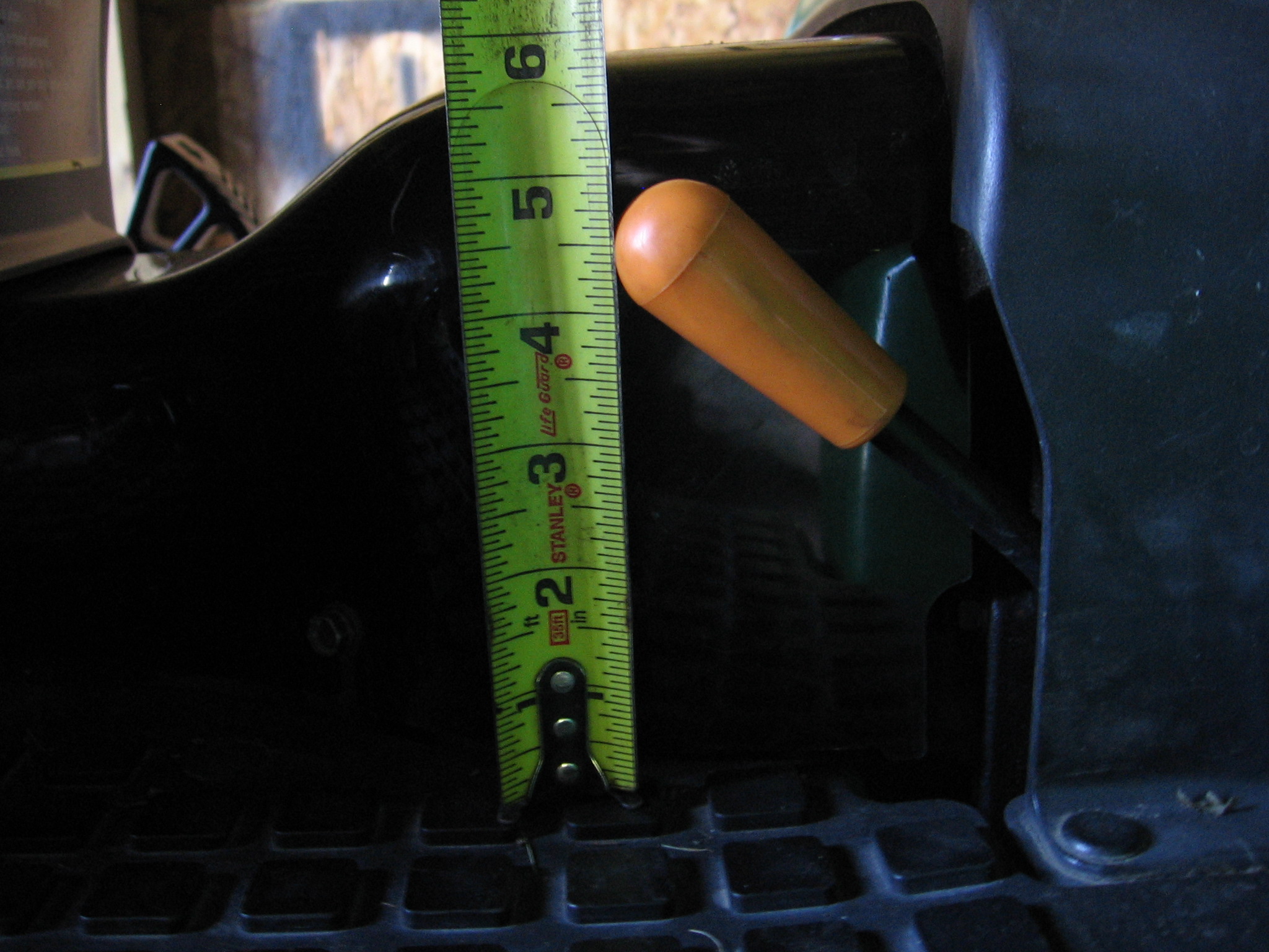

Mine definitely does not feel that way I push it down and the 4wd light comes on but it does not feel like the other levers on the tractor. It just seems lime it is not engaged the whole way, how far off the floor is your lever when engaged? Mine is probably up 2-3" I can check that tonight also...
   / 2520 popping out of 4WD #13
Mine I believe is closer than that to the floor but I would have to measure it to be sure. There is still enough room though that I can disengage with my heel. I definitely feel an engagement.

Ok so I checked under the tractor where the 4wd lever is and there is an electronic button there. There was definitely nothing in the way or preventing it from moving. Does anyone know if that switch is just for the 4wd light? Does that 4wd lever switch something internally? It moved about a half inch from the end of the switch....

Hey Tom,
Man,sorry to hear you're having another problem.
From what guys have said,I too actually "feel" it click or indent or whatever you would call it. It doesn't do a serious lock per say like your range lever does. It is ....I guess subtle,but you can still feel it.
Here are a couple pics with where the lever is engaged and disengaged.
Greg
