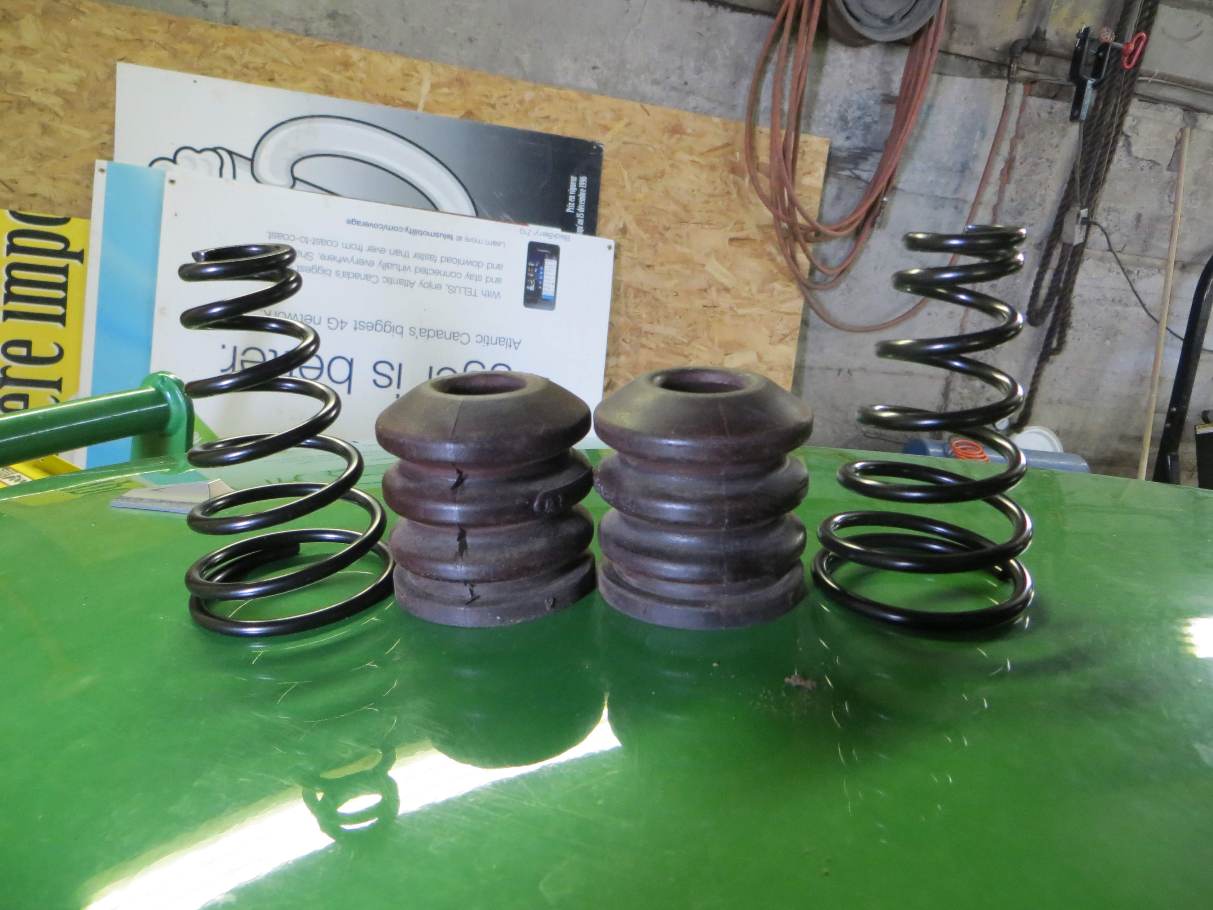

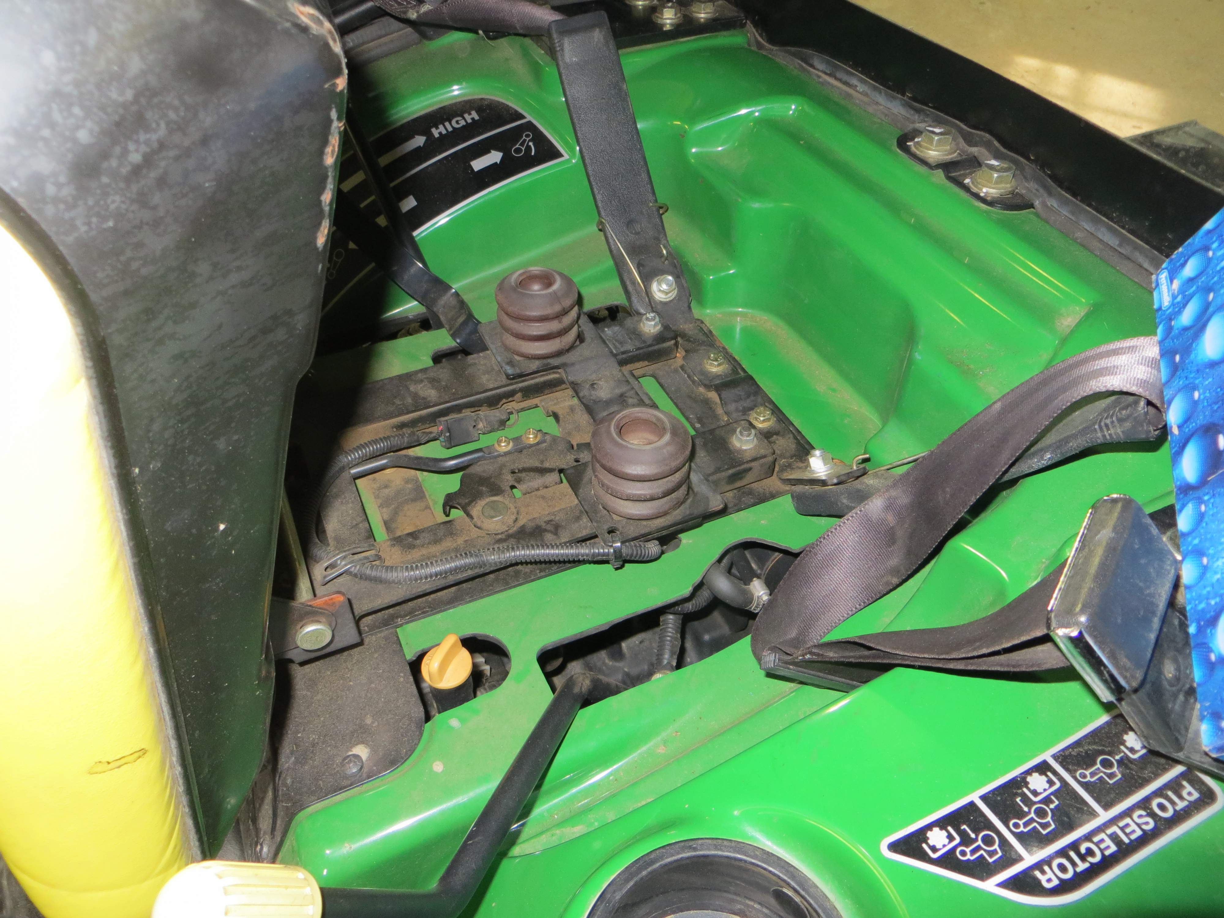

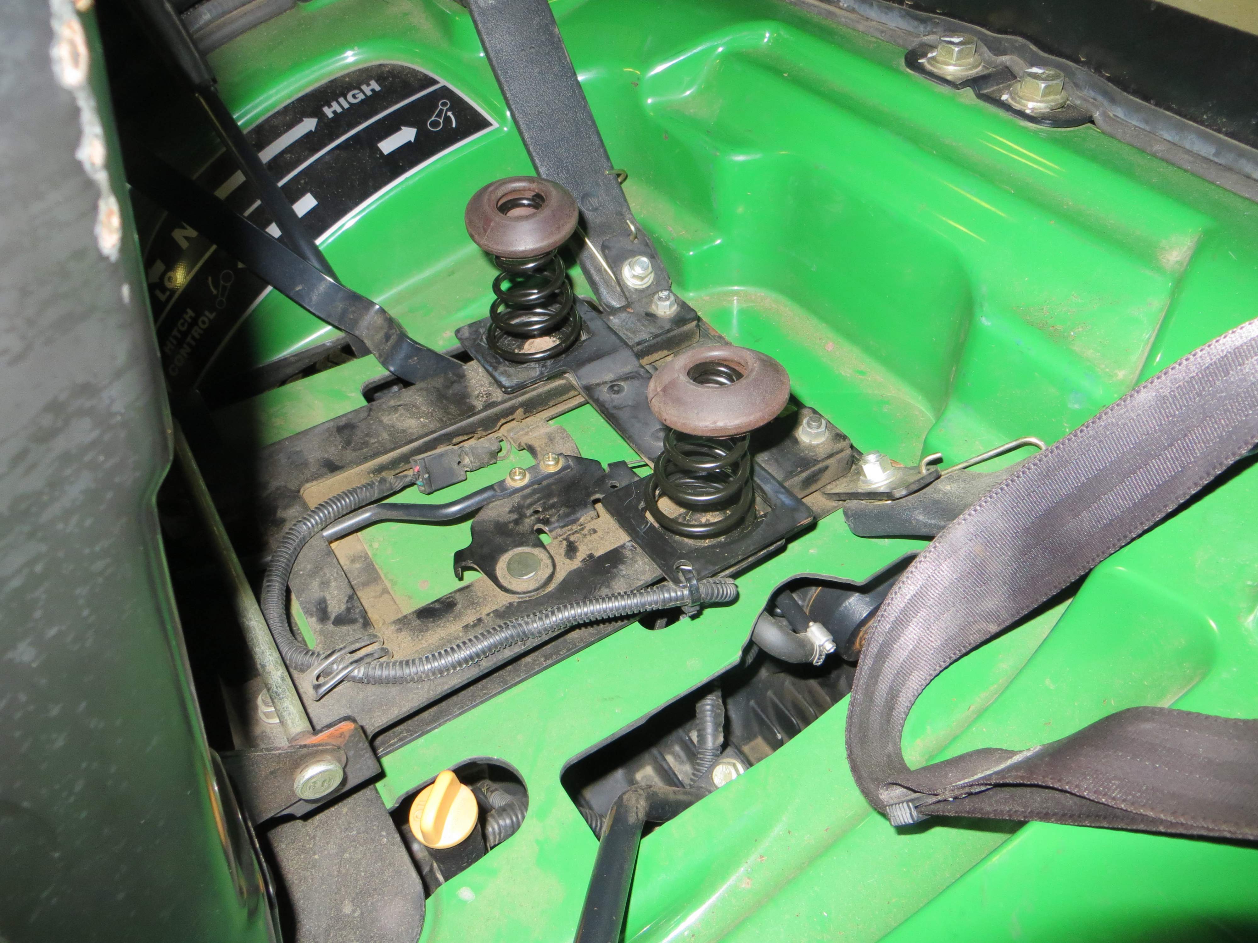

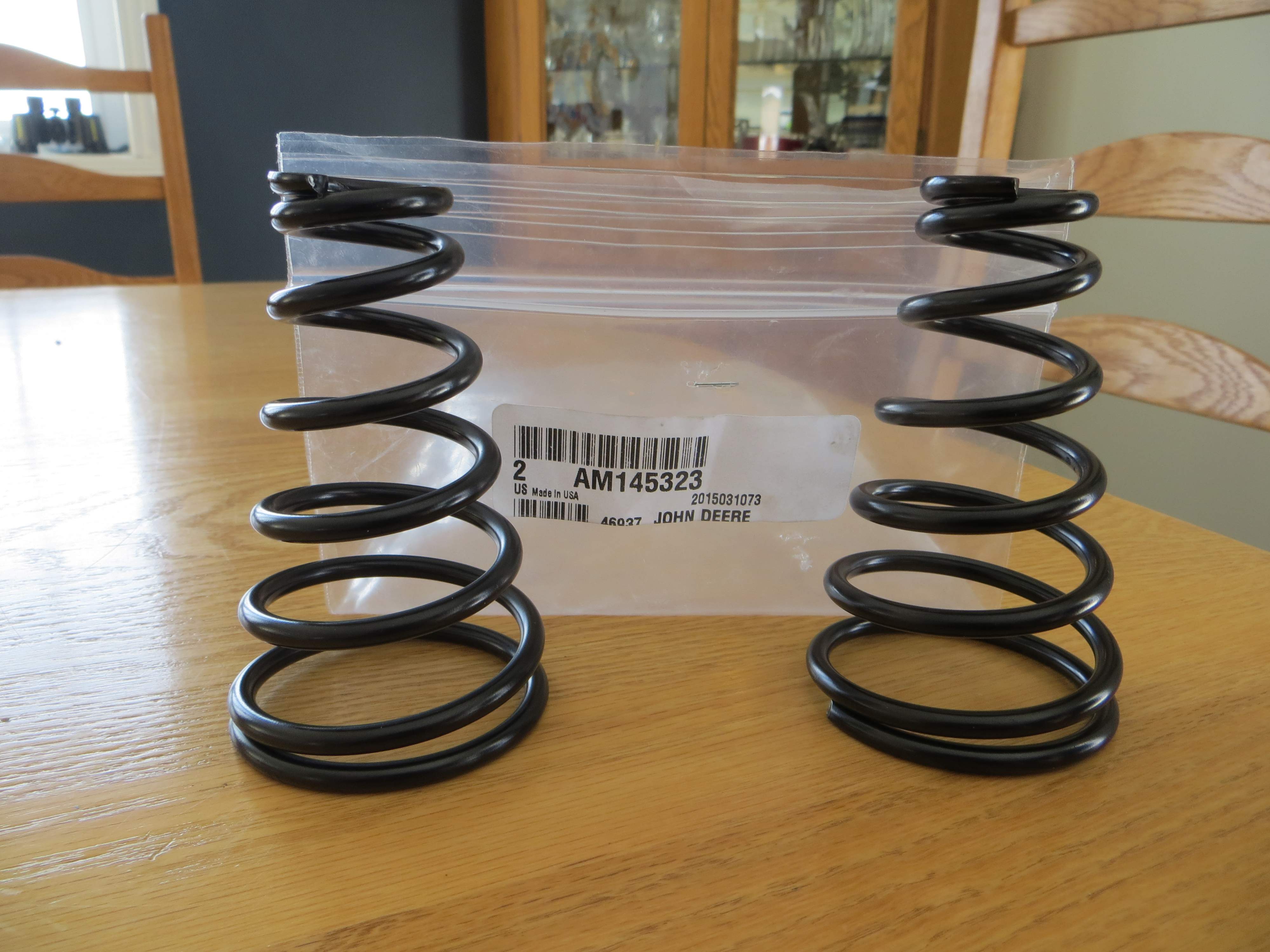

I don't have the tread but maybe this could help. It was for my 2305.

Oh god yes! I was contemplating the Michigan seat and this was suppose to be a temporary fix, but now I think this is the fix for me and my 205 pounds.

How did you keep the old rubber caps on the new springs?
B
/ 2520 seat spring mod?? #6
I just cut the top off and press it on top off the springs.
