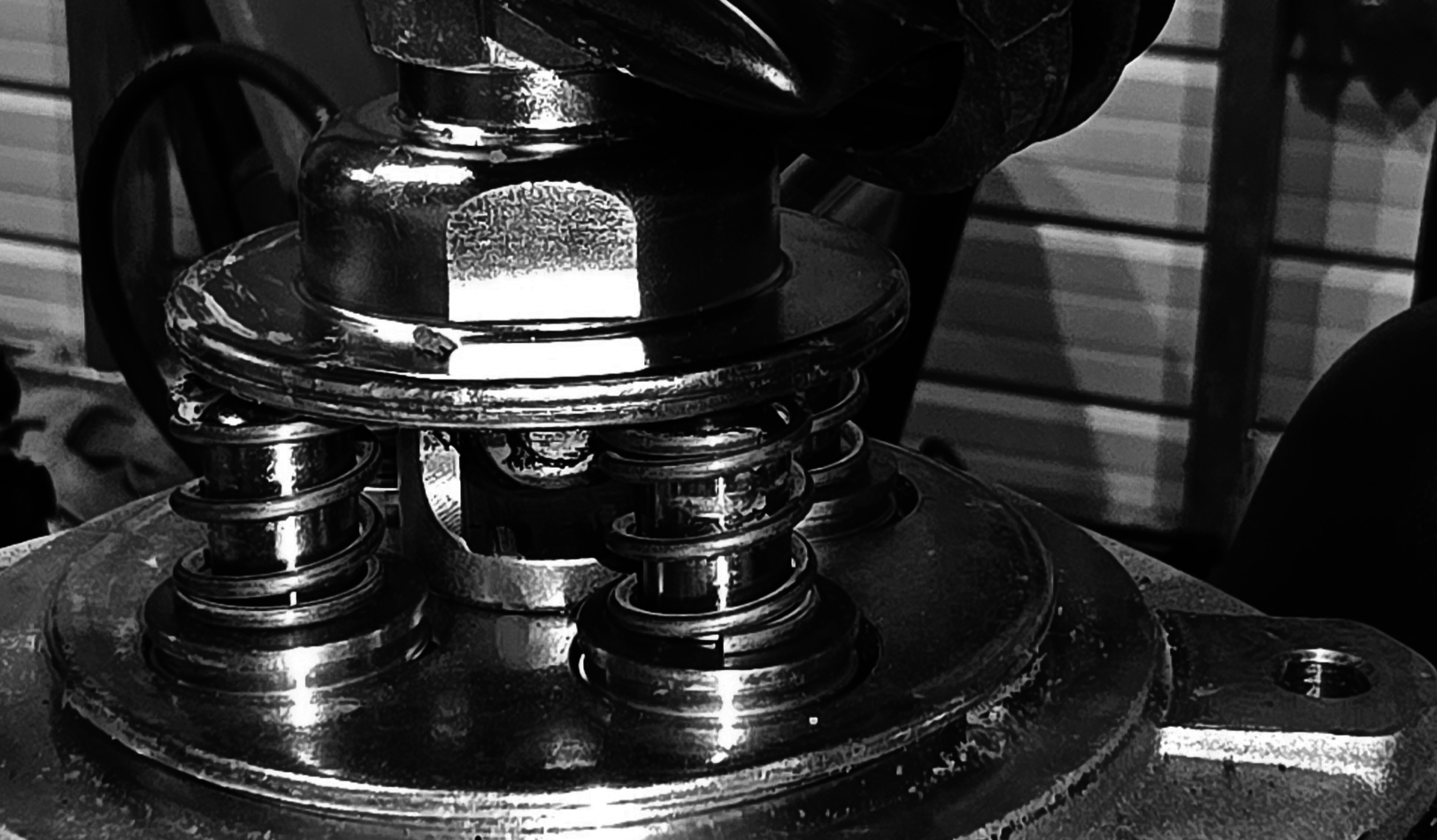

Hello - new to this forum. I ran this by a longtime member first and he suggested I post to the group. So here you go...
What is everyone's experience with the Pilot Control Spring Mod, if any? Any thoughts, questions or concerns about the mod? The following is what I know about the mod and I do not profess to know it all, so always open to hear from others.
FULL DISCLOSURE: First, I own about 1.5 acres, own an old (but awesome) Case 1840 skid loader, own an AGT KU-18e mini-ex and I also happen to work for a spring manufacturer here in Oregon. I designed a custom spring kit for my mini in April 2025 and decided to offer the kits for sale. For details...
WWW.SPRINGPILOT.COM
WHAT IS THE MOD? If you are not familiar with the mod, the goal of the spring mod is to "help" people settle down jerkiness in the hydraulic controls. I was exposed to the mod on Facebook Groups where guys were buying cheap springs on Amazon, using dykes to cut them down, and sliding the cut spring over the pilot pistons to add "resistance" to the joysticks. From what I can tell, this early cut spring mod was hit-n-miss as far as performance. Some guys felt a difference while others did not. Many of the guys who tried the cut spring mod and did not notice a difference are trying my kits and becoming raving fans.
MY KIT - Bottom line, I wasn't willing to have sharp steel wire flexing in my pilot control assemblies and I wanted maximum "resistance" within the small pocket available. So I went to work. The amount of material, number of coils, wire diameter, tensile stresses, solid height, and end finish all contribute to function, performance and cycle life. Prototyping resulted in my GEN1 and GEN2 kits. NOTE: I did an experiment where I used a digital fish scale to measure push-pull force with and without the kits installed if anyone is interested in that data let me know.
MY OPINION - WHY THE MOD IS SO POPULAR The way I describe the spring mod...when done correctly, the springs safely deliver a more tangible connection of the operator (joysticks) to the machine hydraulic functions. The incremental improvement in joystick feel makes a big difference and enables guys like me to enjoy the process of acclimating myself to my machine controls, find and stay in the sweet spot for controlling hydraulic functions on my machine and more importantly get the required seat time it takes to truly smooth out operation of my machine.
PRIMARY CONCERN SO FAR - The primary concern people have had regarding the mod is scoring/scratching on the surface of the pistons, especially in the "piston stroke" zone (bottom .300") let's call it. I addressed this concern on my GEN2 kit springs using a coiling feature that makes it impossible for the cut wire ends to reach the piston surface.
NOTE: I do not believe the spring mod is a cure. Seat time and technique are the real cure. But after selling almost 1,000 kits in 6 countries, working really hard to find (I cannot find any so far...knock on wood) issues and unhappy customers, and piling up over 100 5-star reviews, I can honestly say the kits make a difference and across the board guys are enjoying their machines. Seat time and productivity are up.
All feedback welcome. Thanks everyone!

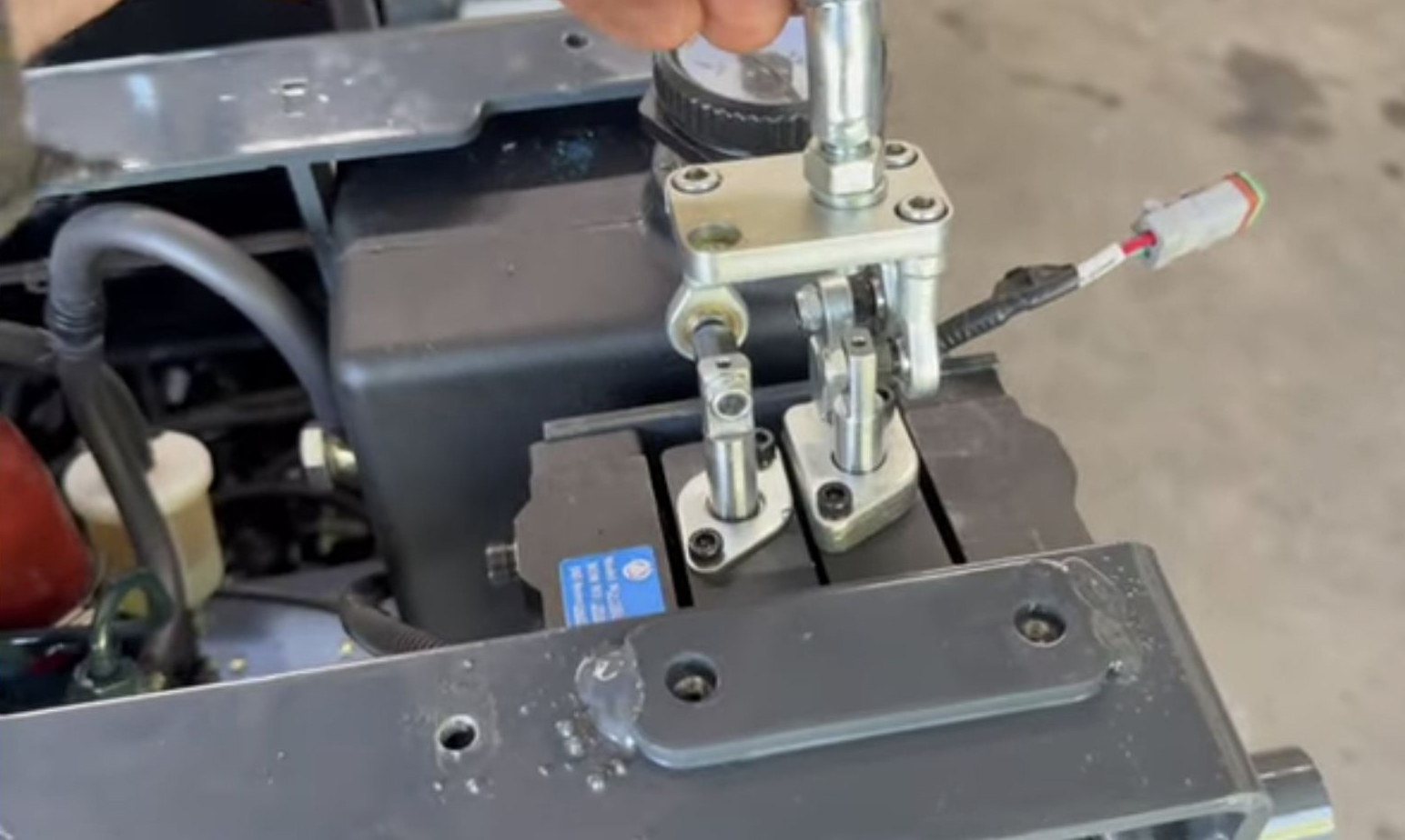

RIPPA R-10 ECO: NOT COMPATIBLE
The R-10 is sold "with Pilot Controls" marketed as "Bi-Lateral Operations System". What looks spring mod compatible on the outside, is NOT compatible on the inside.

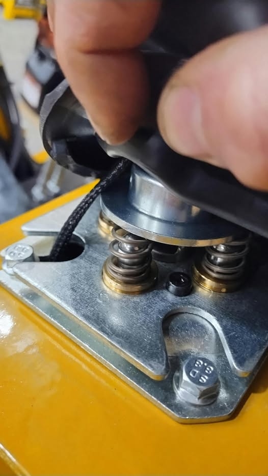

I worked with a customer in Louisiana who installed a kit into his Tigercat 724G Feller Buncher. His "steering control was soft and a bit snappy". After his install he fed back to me recently..."Fit like a glove and a much more comfortable resistance on the sticks than factory." I am curious if anyone else in this forum, with name-brand equipment, sees a need for this type of drop-in mod for joystick controls. Is there a hidden niche demand somewhere in the world of heavy equipment (aftermarket)?
