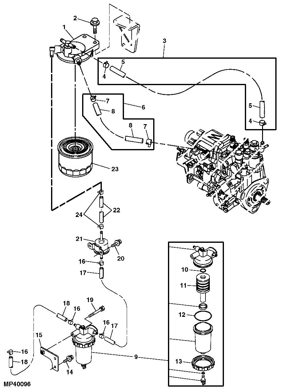

You may have a plugged fuel return line,disconnect it and see if fuel comes out. I had an orange tractor I had bought used with the same type water separator filter(parts key #9) that had a tiny white screen in it plugged with debris and it wouldn't run right until I removed the screen.
