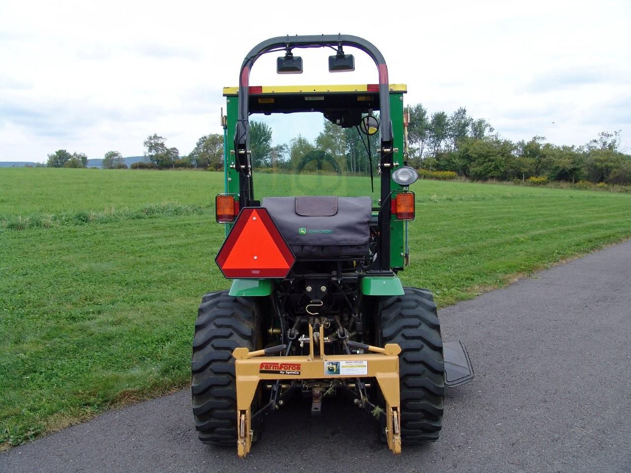

/ 2520 Tool Box #4
Jeff
Picked up a JD canvas tool box on clearance from a big box store (about $33).
Made clamp-on brackets to fasten to ROPS crosspiece, without drilling. Mounted a "shelf" on risers to clear seat belts, wires etc. Extended hazard sign back a few inches.Result is a large box with room for everything I need. Pull two clips and the box is easily removable.
This was a year ago, don't know if box is even available, but any box can be adapted.

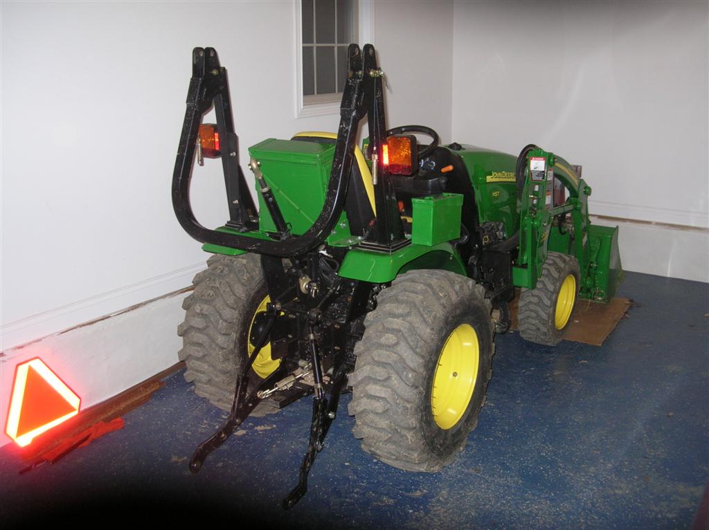

/ 2520 Tool Box #5
I like this ammo box setup, but haven't investigated enough to see if it will work on my 2520 yet.
/ 2520 Tool Box #6
I don't have a picture handy, but I bolted an ammo box just behind the seat on the right side of the tractor. There are a few existing holes in the horizontal metal piece that runs between the two fenders, bolted on perfectly right there. No clearance issues with the seat, center link, etc. It's plenty big for a socket set, pliars, extra sheer bolts, pair of gloves, etc.

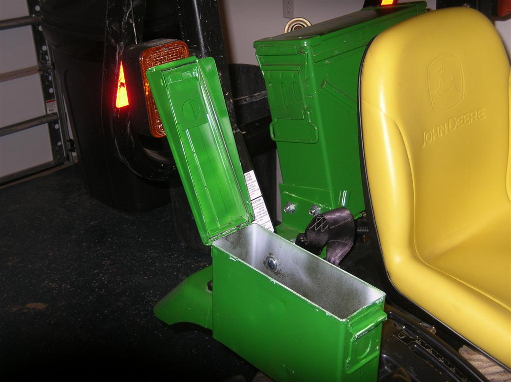

/ 2520 Tool Box #10
Not a 2520, but here are my tool boxes on my 2320 tractor. Just love the smaller one. Very handy for gloves and headphones!
