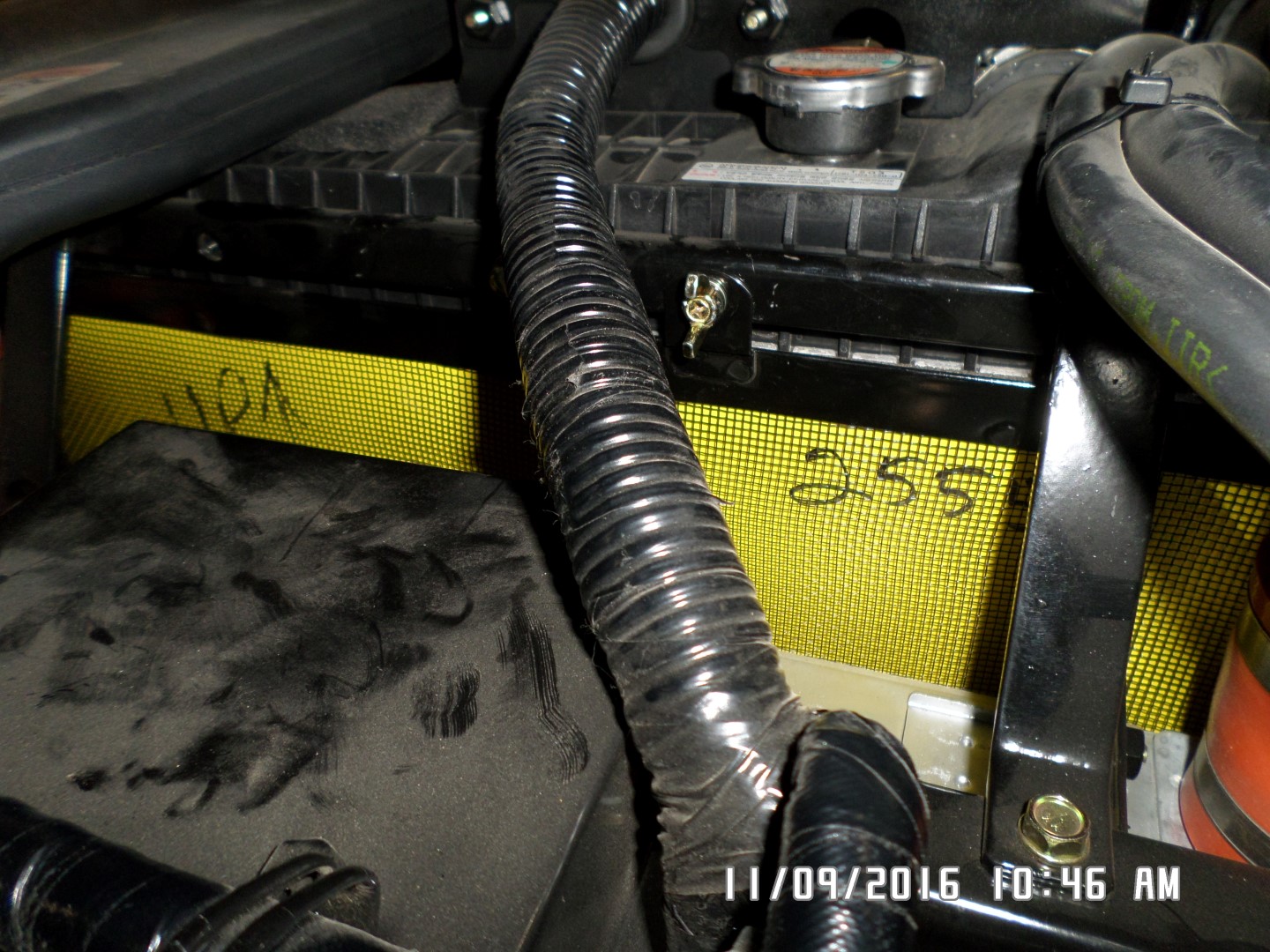

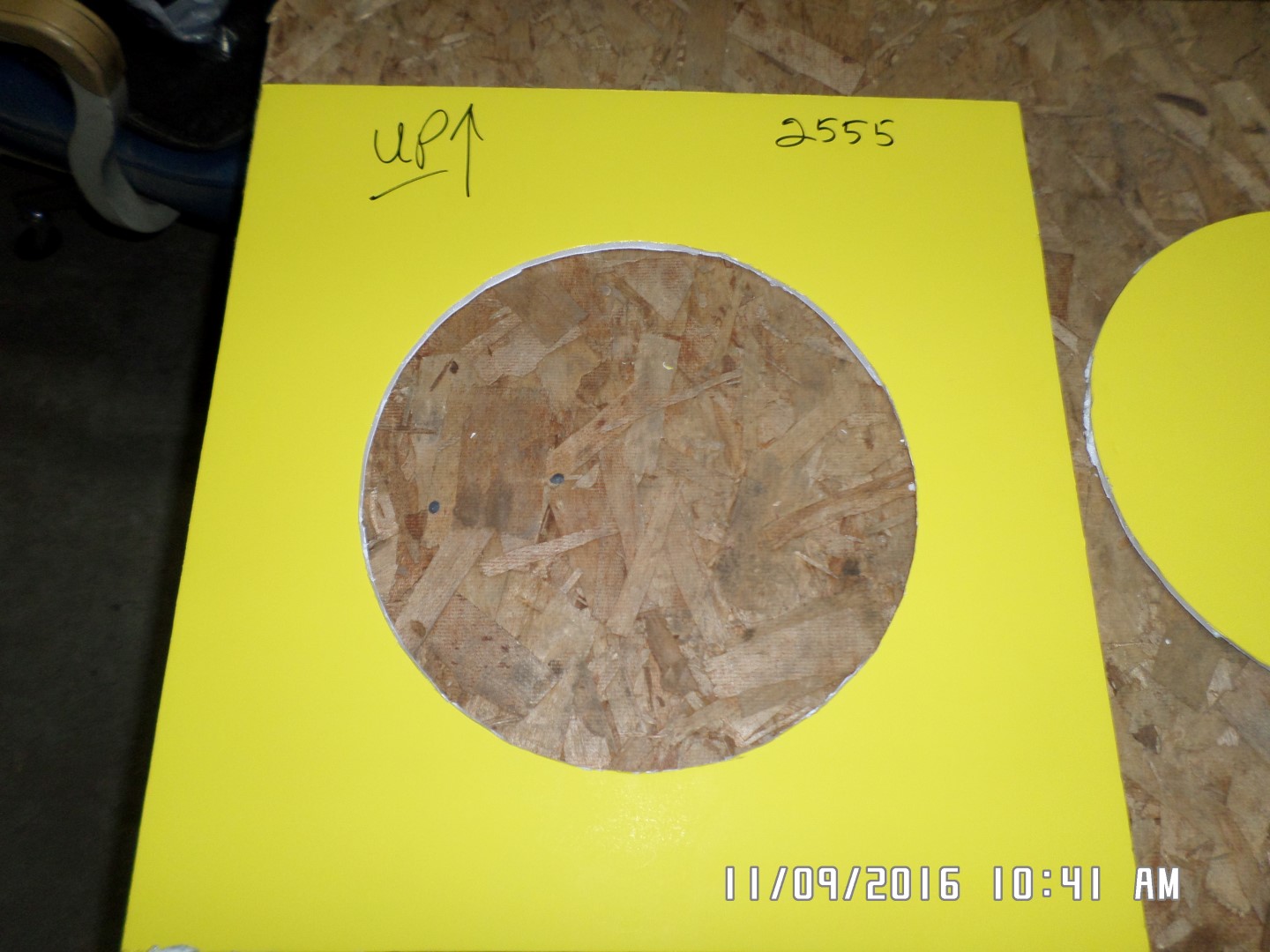

I've seen a significant improvement in the engine temperature now that I have added the airflow limiters in front of both radiators... The engine warms up much faster but it don't seem to be over heating any. The real test is going to be when the temperature drops to single digits and below this winter.

Holeycow.... yes, I did put a board in front of the hydraulic and engine coolent radiators but I put a 7 inch hole in the center of both boards. I plan to watch them very close to make sure I haven't created a situation that will result in hydraulic overheating.
The cab heater is now blowing warm air....not hot air but at least it's not like having the air conditioner on.
I'm still thinking of making some sort of engine side skirts that I can use this winter when the temperatures get down in the teens and below.
