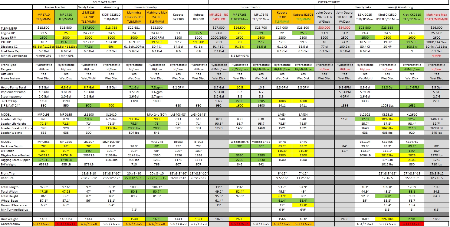

The attached chart is my spreadsheet for helping to see the desired traits of different brands that I am considering. I do have other brands included in the chart, but they are hidden as they are not a part of my search... such as TYM, Yanmar and Branson. If you want the Excel version, PM me your email address so that you can add to the information I have already gathered for your personal use.
Along the main body you see green and yellow items in each category, green is the top performer, yellow is the close second. I view the greens and yellows as nearly equally weighted.
Along the very bottom I score them on total counts of greens and yellows to determine the best overall performing units within the group. You'll red as the top performers and orange as the next level down.
There are many intangibles that are not on the chart. Ergonomics. Fit and finish. Personal bias. Dealership distances. Visual appeal. These things could be integrated into the chart, but many of them are personal opinion/choice and do not fit well into the concept of using facts to remain color blind while sorting the products that best fit my concept of value. I see value not as lowest cost, but lowest cost factored into best performing.
The chart is broken down the center with SCUT options on the left and CUT options on the right.
The MF 1526 can not take a BH, so it is greyed out. John Deere priced itself out, so it is greyed out. The Mahindra Max 26 is to slow in low range and does not have a mid range, so it is greyed out. All other CUT units are in the running and I will eventually go hands-on on each one to eventually get the list narrowed down. As it stands, that MF1726E and in the SCUT territory the MF GC1720 are rock solid contenders. MF has some really well sorted out products in this market place.
