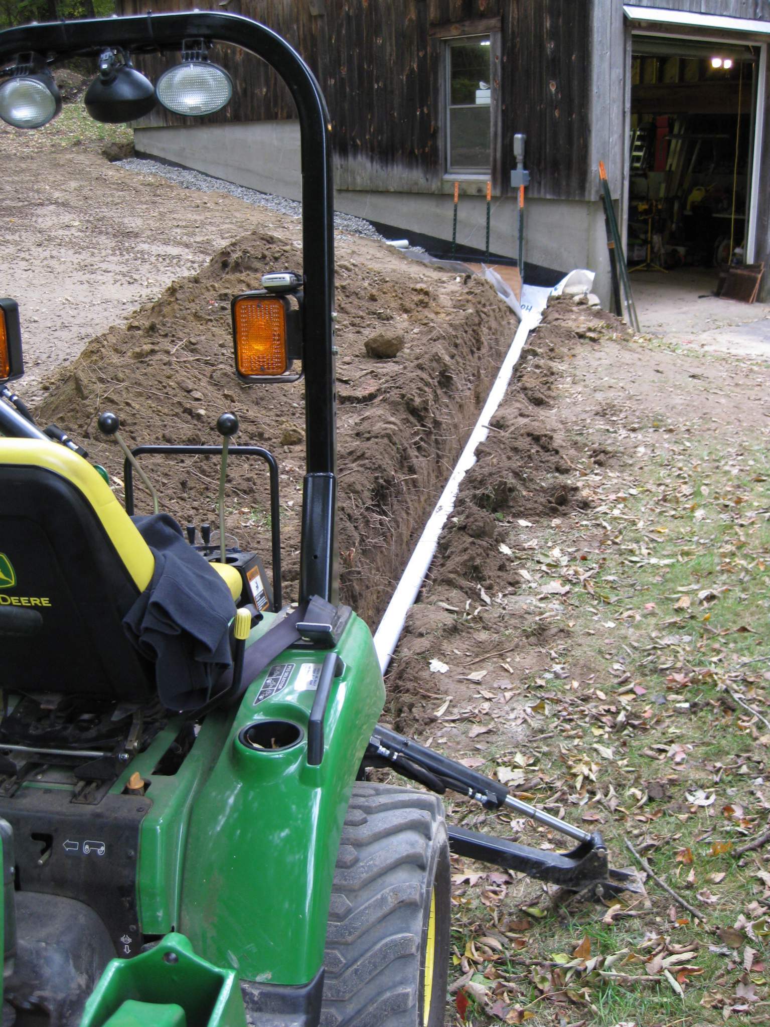

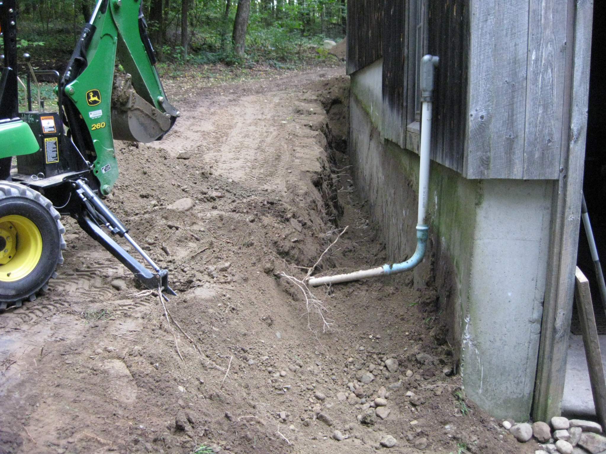

Hi All,
As a former 2305/260 owner, I was thinking anyone with access to a mini ex would be nuts (please excuse the accusation) to even consider a 260 hoe. The only exception I could come up with was someone who wanted one for speedy access for light jobs.
It sounds like this is just what Foxtrot is looking for so I'd have to support his purchase of one for $4000. For that price, you can't loose. If you get it and decide it was a mistake, there will always be people looking for one and you can sell it easily.
It's a great hoe for its size. You can get into areas with it that can't be gotten at with much else. Just don't plan on doing any significant stumping with it. There isn't a lot of power and certainly not a lot of speed.
Be sure your machine has the Power Beyond kit installed. It's about $200 and you can do it yourself in a couple of hours. Other than that, be sure the backhoe comes with the 2305 sub frame. Last, be sure you get/have the rotating seat with the deal too. They are pricey to buy.
