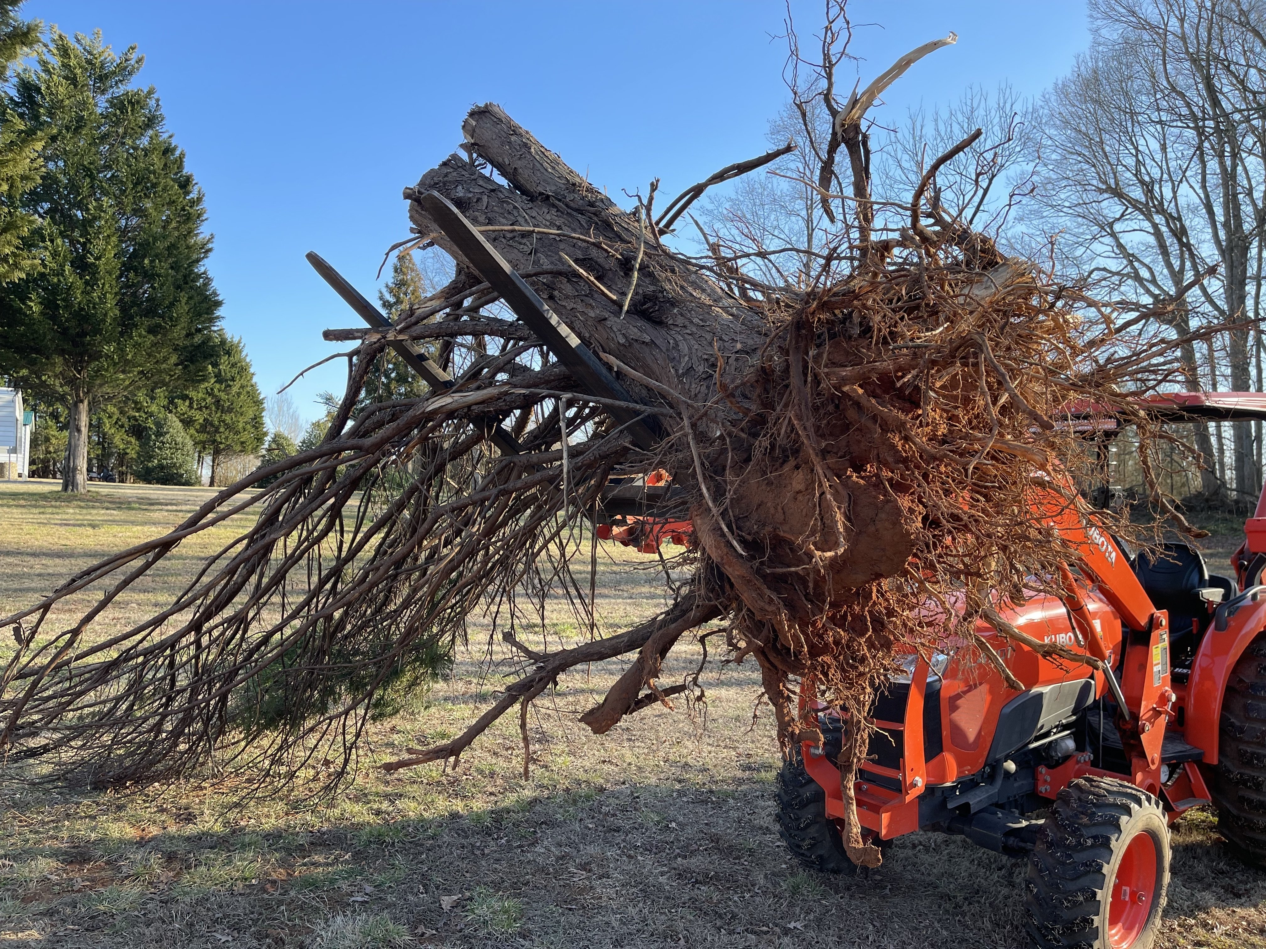

What makes a backhoe the best all around machine for a farm is it's ability to dig, remove trees, haul materials and travel over the ground at a reasonable speed. Tires are always faster and easier to travel on then tracks. But for me, the reason I like the backhoe the best is that I rarely have to get off of the seat. For big trees, I have to use a chainsaw to cut it down, but for smaller trees, I just pluck them out of the ground, turn the seat around, pick them up, and carry them to the burn pile. Nothing is faster or easier. If I need dirt to fill in the hole from the stump, I can dig it with my hoe, haul it with my front bucket, spread it out, compact it by driving over the fresh dirt, add more dirt and spread it with the bucket until it's impossible to ever know that a tree had been there.
Have L4701 with BH92 R4 tires use machine around house and property.Track machine will tear ground up rubber or metal verses R4s on tractor being careful not in 4wd cutting wheels hard gunning throttle obviously.Have 20 acres in western NC ran full size BH for years on cranberrry farm in southern NJ Ford 555 and lastly JD 410G ext hoe as well as JD 160GLC excavator I’ve been very pleased with L4701 pound for pound BH 92 is built as good as any back hoe arm Ive ran now not as fast as full size BH but for one fill line and one return line with hydraulics I’m impressed with years on bigger machines.I totally agree tires are faster and cheaper than tracks I have cleared and burned up trees and stumps probably around 500 mainly Leland cypreess with chain saw,BH,and forks.Now I did rent an Bob Cat Ex85 excavator with thumb when I burnt my first large pile didn’t want to get tractor close to fire,last couple piles kept smaller used tractor.
