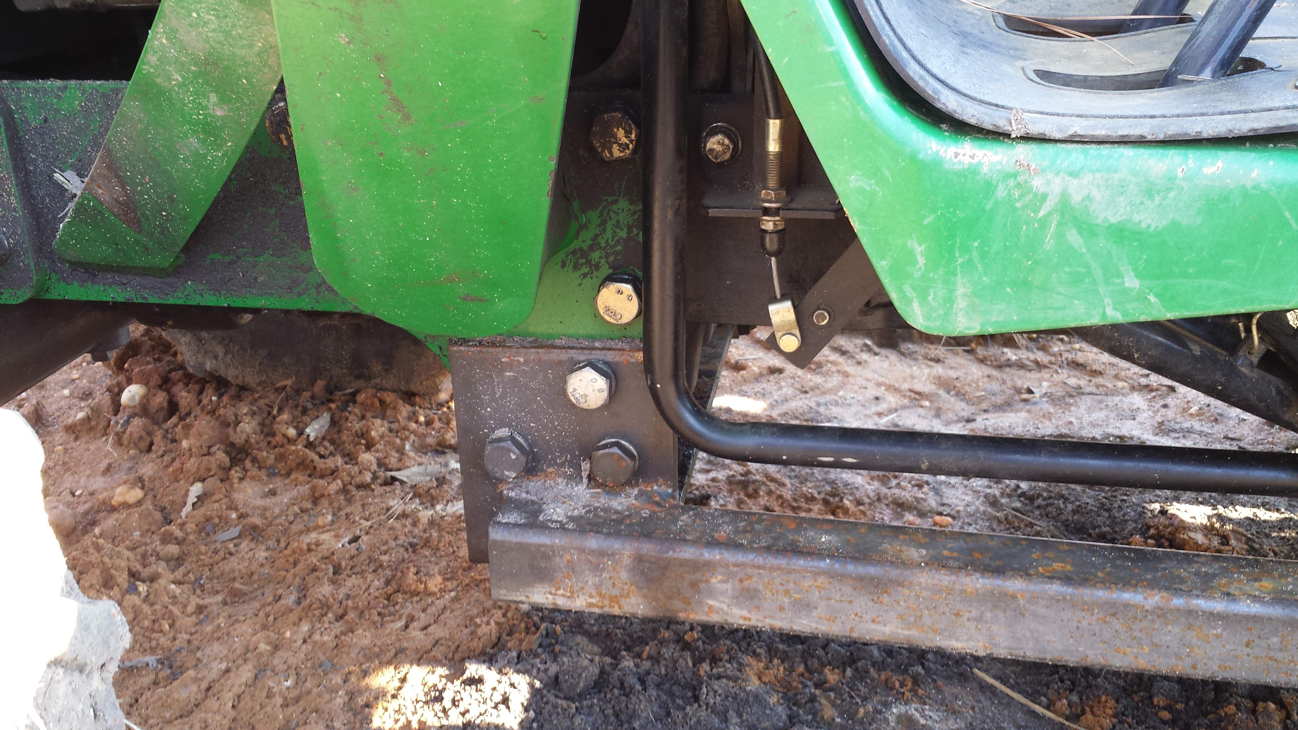

20140309_165035.jpg Picture of sub frame connector.
   / 273 broken frame
#37
The 2x2 makes a 90 and is welded between the four bolts that hold the ROPS bar to the bottom the axel. Same on both sides of the tractor. Also not pictured is 1/2" thick steel between both sides connecting them together. Still have room to get to the hydro filter.
