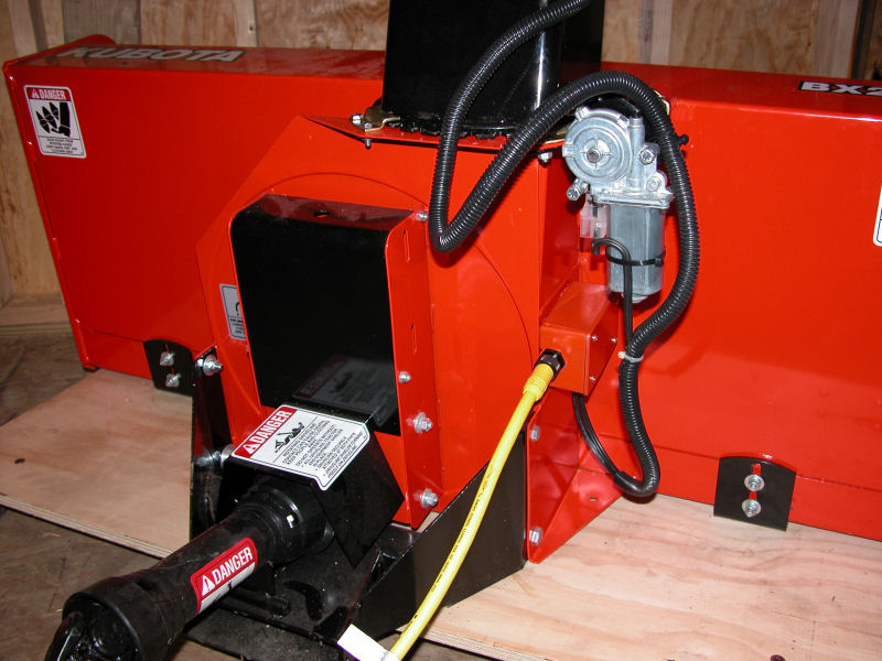

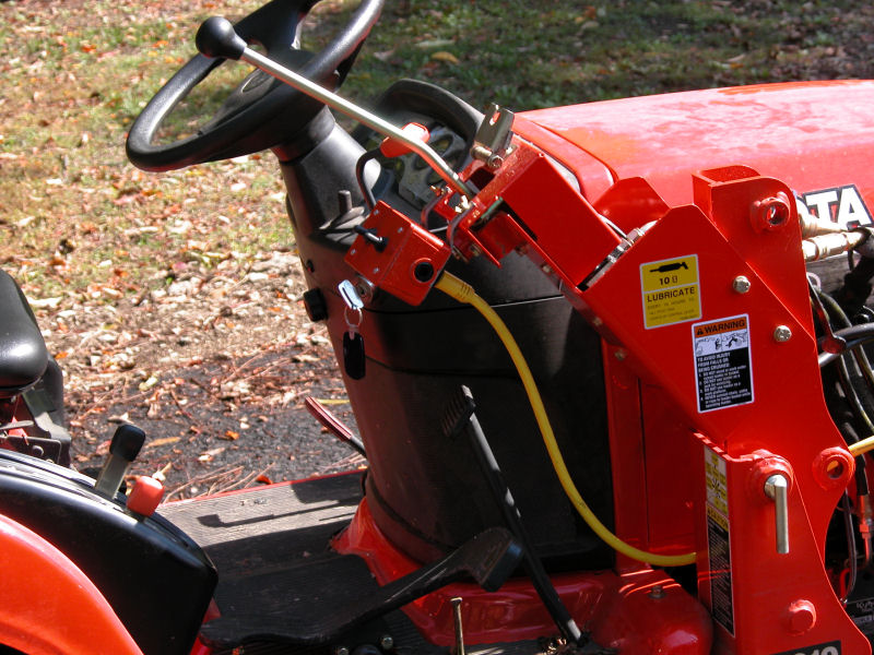

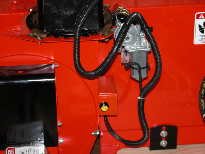

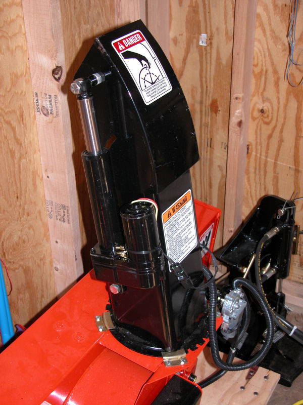

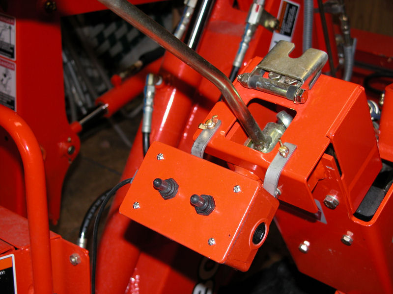

I did a similar a few years back. Only difference was I found the Kubota kits for rotate and angle on ebay, about $ 100 for both. The angle actuator was for a larger blower, but a few new holes fixed that issue. I also terminated to a box wit a connector that I can disconnect easily with the blower. Another small box with the controls attaches similarly to your config.
paul

Do you have any pictures of how the motor is mounted and how you did the coupling. Looks like a nice install.
   / 2750 snowblower electric chute rotation and deflector project
Paul,
I like your idea of the quick connect! Really nice mounting job you did.
Sure makes it easier than getting off the tractor to adjust the deflector or using the hand crank to rotate the chute doesn't it!
Paul
