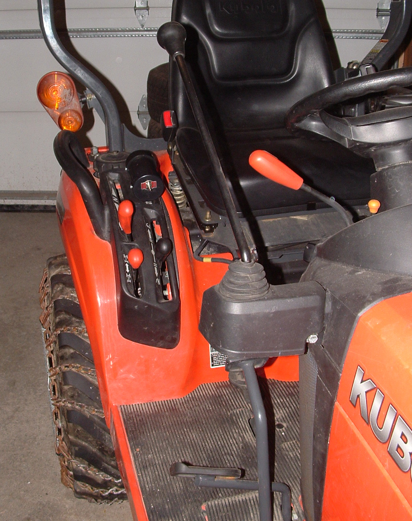

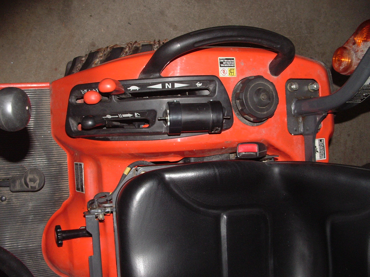

I mounted my snowblower's electric controls (two double pole, double throw switches) next to the seat. I used standard drain pipe tubing (and caps) to make a weatherproof housing (see the black cylinder next to the seat in the photo). The switch on the front of the housing moves the chute left and right, while the rear switch activates vertical chute deflector.
Most importantly, mounting the switches next to the driver's seat in this manner is the most pleasant and comfortable location I have found to date.

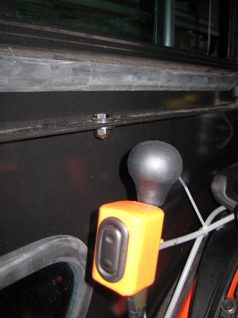

Op; Nice job! Attached is a picture of my deflector actuator switch. Linear actuator was from Frigelli auto out of California. Kubota hydraulic rotation. Sent from my iPhone 5s 64Gb using TractorByNet
