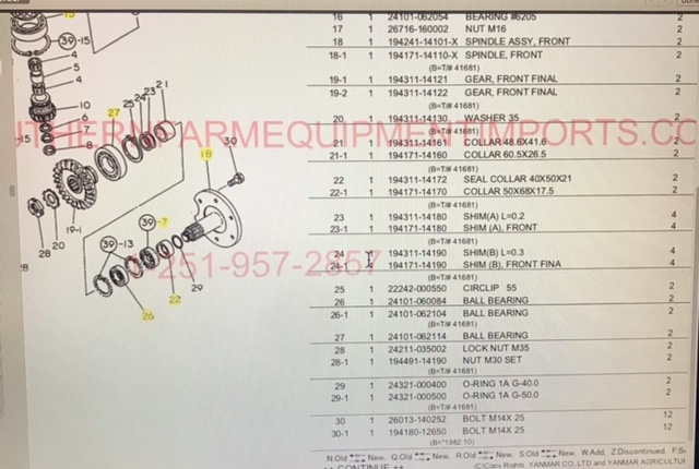

OK.I found one note saying a heavy duty wheel spindle kit was available for the YM330D and YM336D.
The HD kit had a larger shaft, thicker wheel flange, larger bearings and seals, and improved locknut (inside). th
So far all I see are prices for the larger YM330/336 Front Spindle Kit # 794171-14 100-X
THAT KIT NUMBER WILL NOT FIT YOUR YM276D. I'll keep looking.
There is a hand written note with prices $601 & $1038.. my guess is that is dealer pricing and for one side vs both sides.
Interesting that the locknut is also improved. D\
Was your internal lockneut loose where it holds the output ring gear onto the asle spindle shaft?

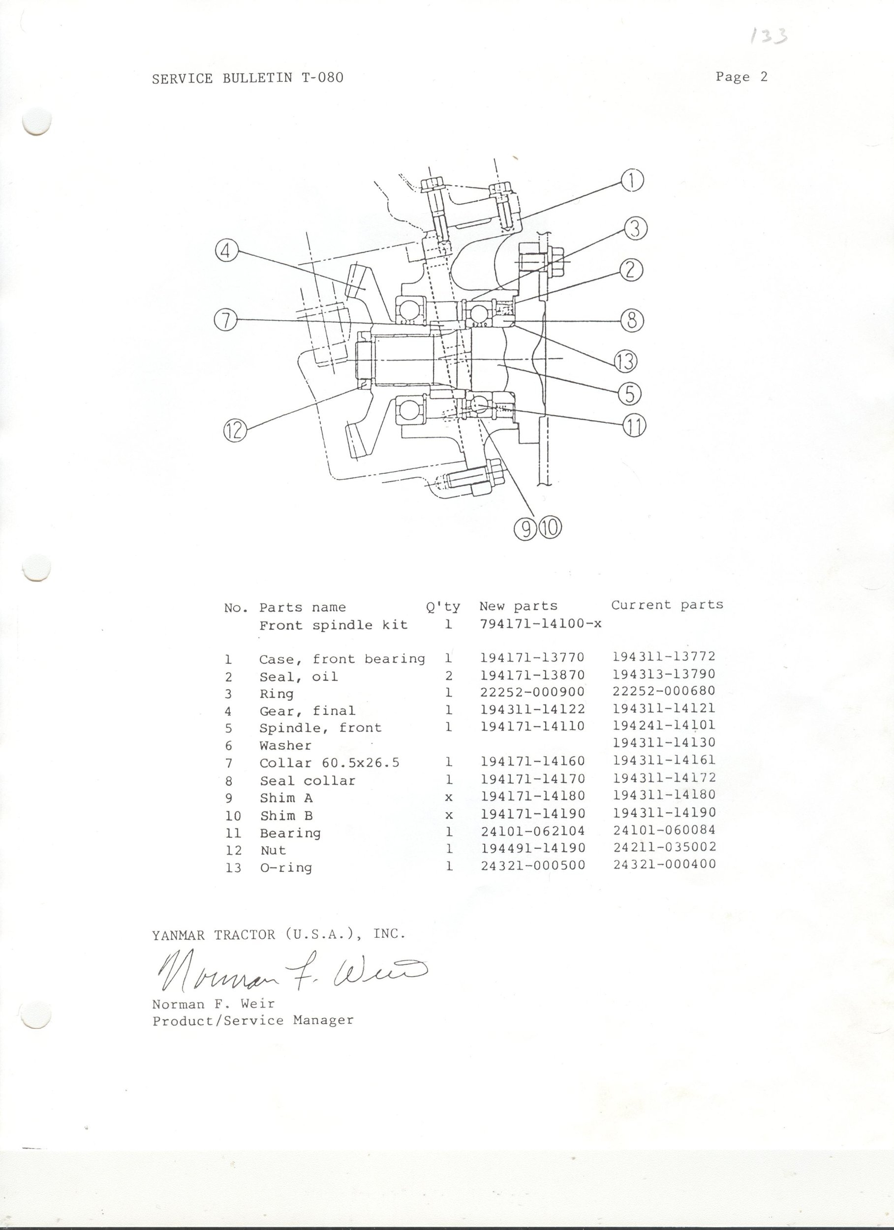

Yes, ceertainly check into the lock nut. I doubt it can loosen, but if it did then the spindle could break. Here are two attachments that show the heavy duty parts for your YM276D. It came as a kit. I have no idea where that kit can be found...but at least you know how to begin a search.
There were several front buckets made for your loader, but I doubt the bucket is the problem.
Remember that when pushing with the loader bucket you CANNOT have the front wheels cocked to one side as though turning. You can wiggle them a little, but try not to do so when pushing.
That applies to all part time 4wd tractors with a loader. Push with the front wheels pointing forward, maybe a little turning is allowed, but no no case turn all the way to or near lock while pushing. Especially in snow or mud.
Good Luck,
rScotty

View attachment 835792View attachment 835792View attachment 835793
Now for him to reach out to Yanmar USA in GA. Sitting on some inventory shelf there could be a set of these kits. (y)

So I ended up getting home and calling Yanmar HQ in GA like a few of you had recommended. Found out my prior installs before I had done it myself were done incorrectly and I was indeed missing an o-ring (#29) and a few shims (#23 and #24) it called for 2 each of the shims per side and I only had 1 each per side. They said to order these reinstall and make sure the final drive gear has no play. Also that I needed to re add the blast to my rear tires to offload the front axels. Heavy implement off the back or not he said this is a must if I was breaking spindles. And like you all had said no 4-wheel drive on hard surfaces and be cognizant of my turning radius especially with a load in the bucket... the wider the better on the spindle.
Lastly, they do have the heavy duty parts still for the spindle! Well at least some of them but not all of them. the parts labeled with a xx-1 (for example 18-1) are all for the new heavy duty axel that is 50mm thick vs 40mm. you'd have to find all the parts on your own as the kits are no longer available, but the parts 18-1 through 30-1 (that have the xx-1 that is would need to be replaced) Myanmar HQ did have some in stock, others they did not and could not get, but he said to ask hoye for the ones that Yanmar did not have as they used to buy up all of the older no longer continued parts. So there is a good chance you could still put together a HD kit for these older tractors! Good to know should another one break on me.
