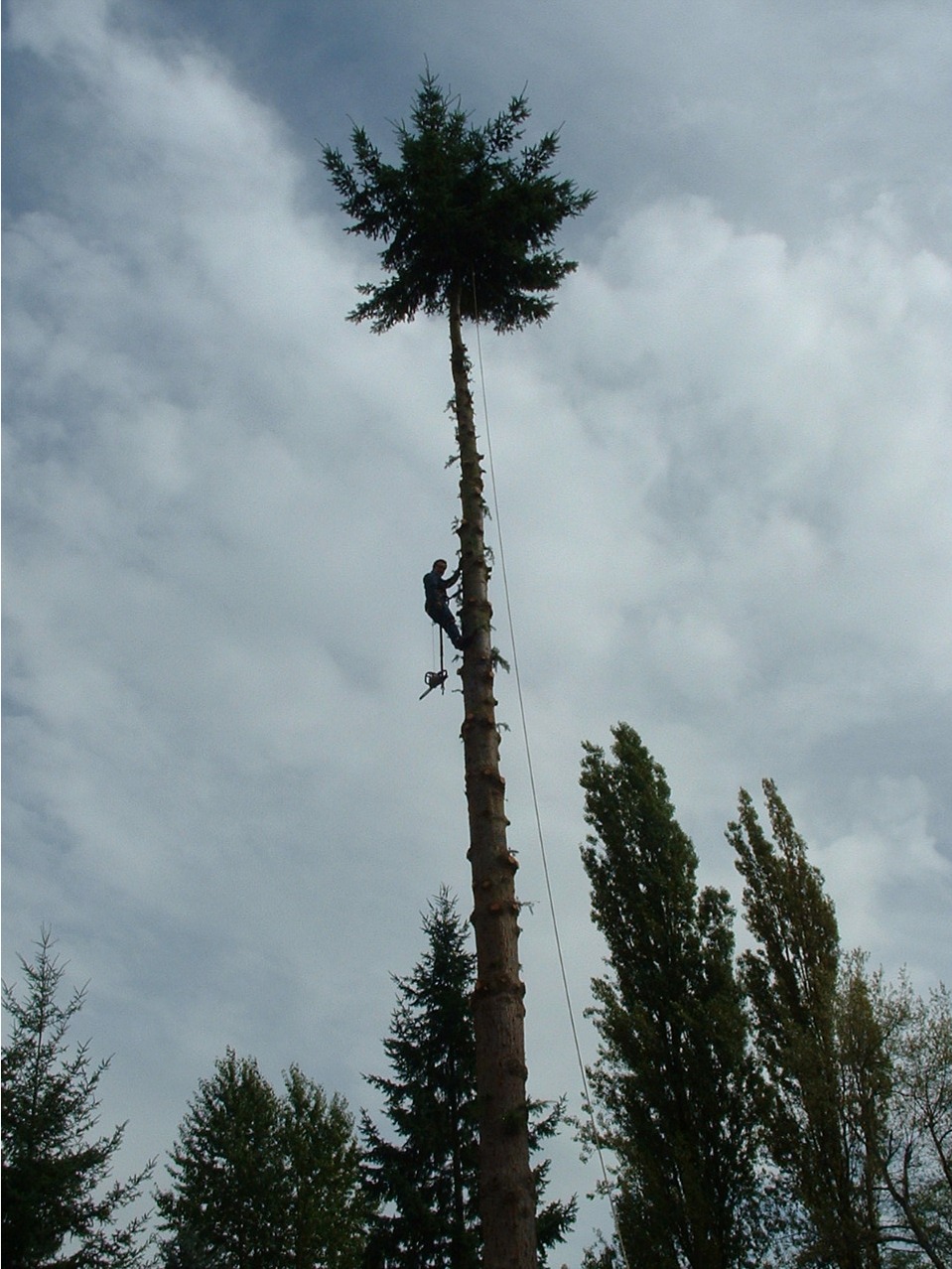

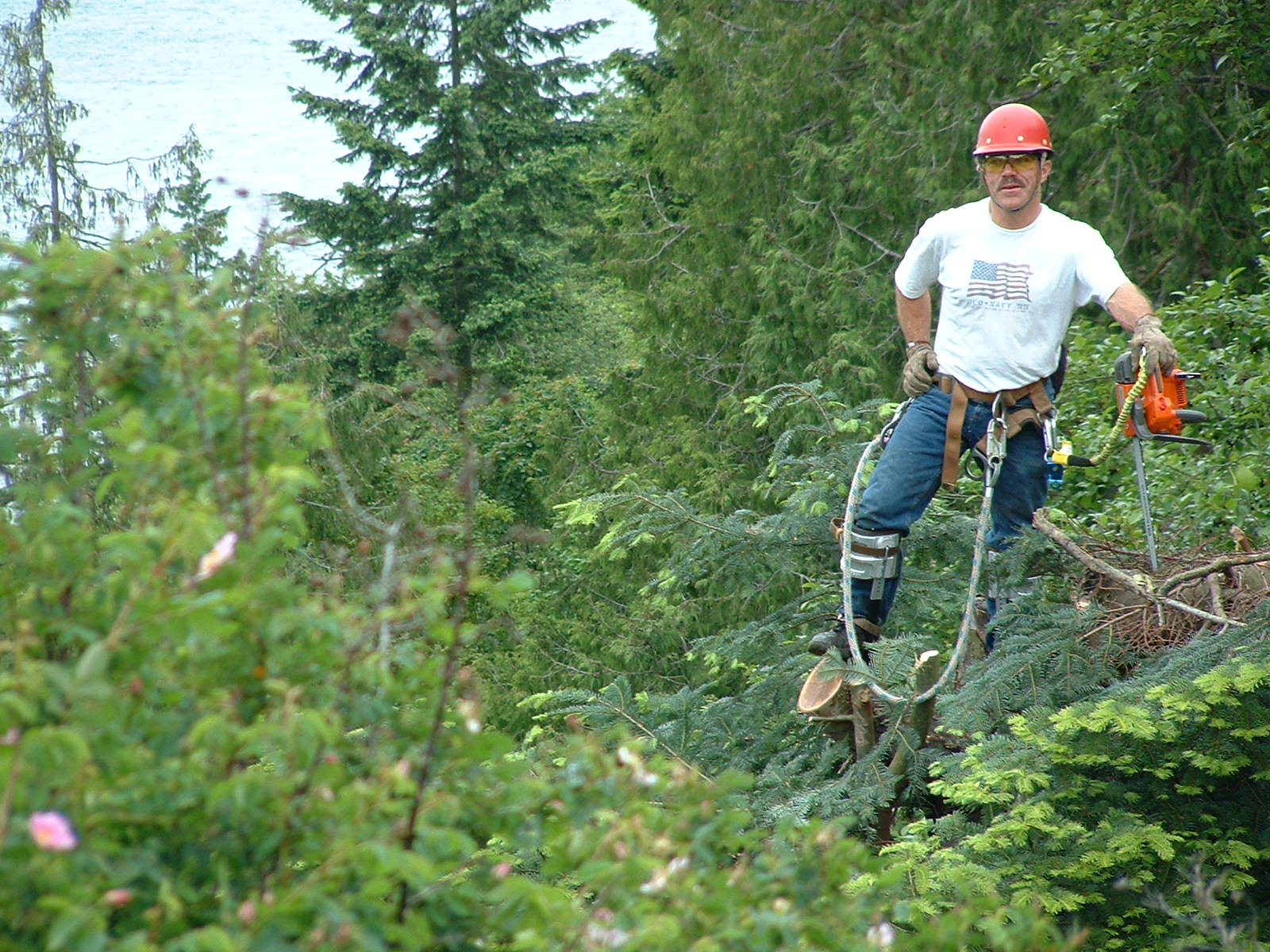

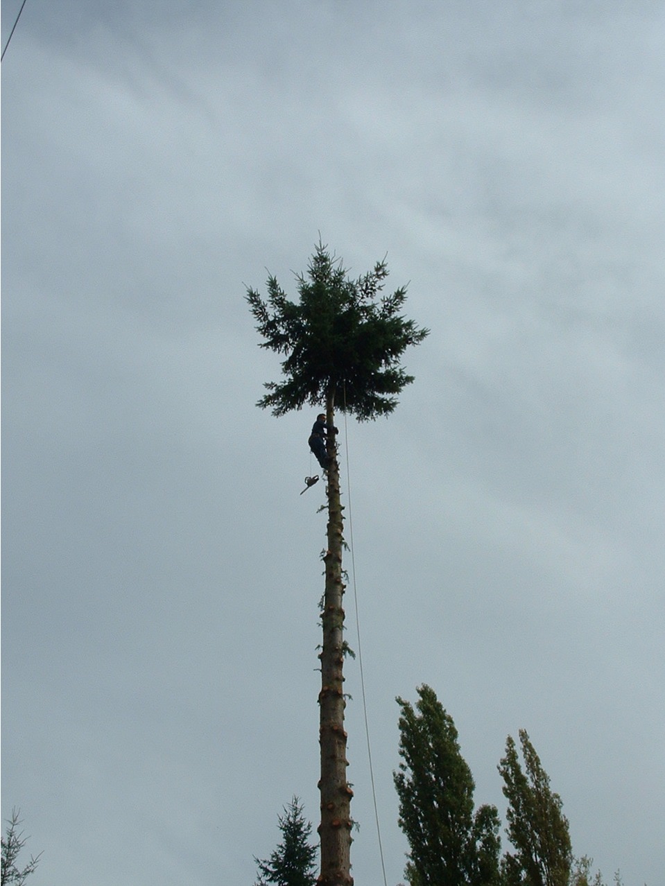

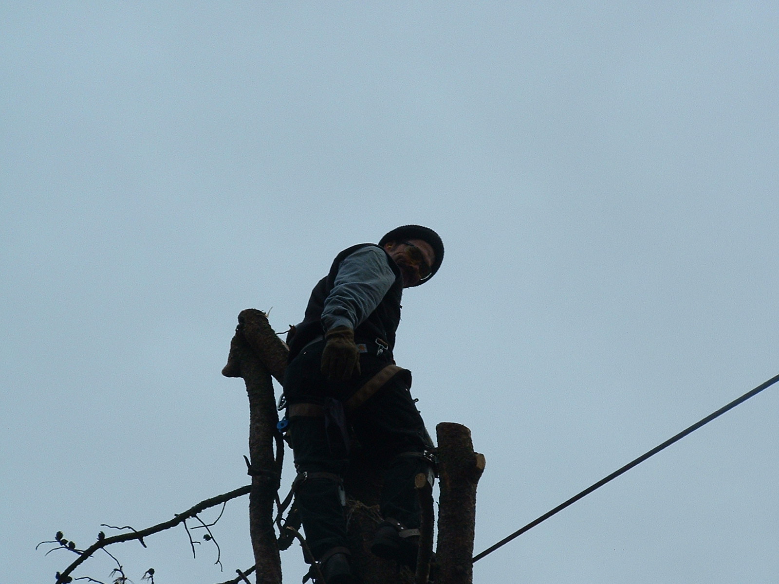

You guys that do that work in the tree tops earn your pay and have to be on your toes. Any pics of you in the trees?
   / (2nd try) How do you climb down from a roof? #43
I do have pictures. This thread is about ladder safety though. Just a few shots of what I do in my spare time. The one with me in a white T shirt I am actually standing on the top of a tree about 40' above the ground that happens to be level with the guys yard. Two shots are me taking down a 100'
for my neighbor. The tree was next to his house and deck so I had to speedline down the branches. And one shot with me looking down is a tree in my own yard that was blown over by a large windstorm we had a couple of years ago.
At 51 years old I am still young enough to do the work but old enough to know better.
