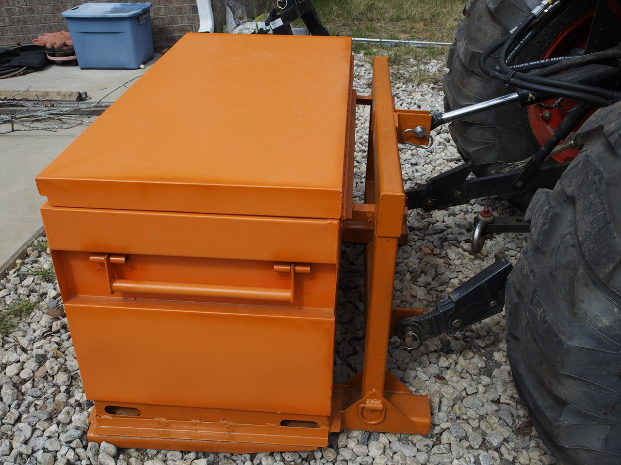

Lots of different experiences with weight boxes on TBN. My factory suggested weight is ~ 850# if I recall correctly for my 2785# FEL lift capacity. I have a ROBB that weighs 710# and extends 26" from the rear pins and it is not near enough weight for maximum FEL carrying capacity. A friend has a TYM 394 (similar tractor capacities to yours I think) with 550# weight box and it is not enough. I think 750 - 800 would be his sweet spot, along with yours.

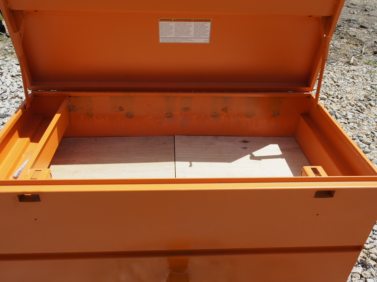

I recently built a weight box assembly using a 15 cu' job site box with the intention of starting with a weight capacity of ~ 1250# and having room to add more weight to the box if necessary. My box weighs 1240# measured and is barely adequate for the heavy maximum FEL weights I need to carry occasionally. Having extra room to add more weight to the box occasionally to protect the front axle is helpful I think.

The bottom of my box is a 2' x 2' galvanized steel plate 5/16 thick. Then I have 3-2.5 inch diameter pieces of galvanized pipe welded at an angle to the plate in the bottom w/ drain holes that are long enough to extend about an inch above the finished box. I will use these to carry a iron rake in one pipe a spade in another and a crow bar in the last pipe.
I have maybe 30# of misc steel in the box welded to different places to provide support and strength to the concrete. I will also be using a real category 1 draw bar as the lower attachment point for the lower arms and I fabbed up some channel iron for a top link connection. The box will extend 12" beyond the lift arm pins. So whatever I said it weighed in the first post it will weigh,..I can probably add 35 to 50 pounds to it I would guess in the steel inside the box. I think I will leave it as is and pour it full in the future. Jeff
