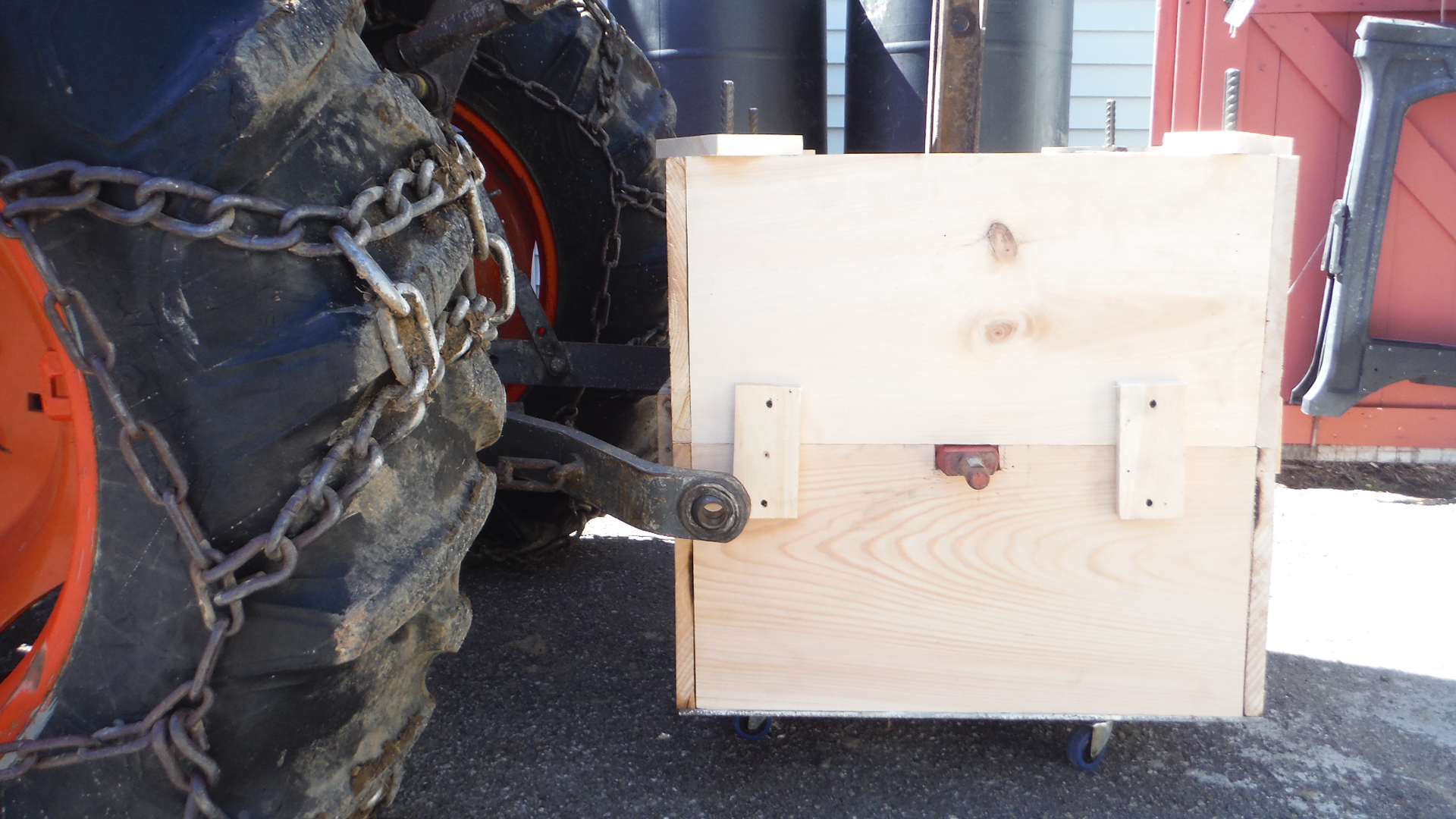

Ya that may be an issue I will have to make a dry run at it for sure good catch! It is 38* and rain today but if it ever warms up I will take the Farmi Winch off and try the box. It makes me glad I decided to post a photo of it. Otherwise I would not have thought about that. I just copied the width & height of the Farmi connections. Now I am itching to see what I will have to change to make it right.

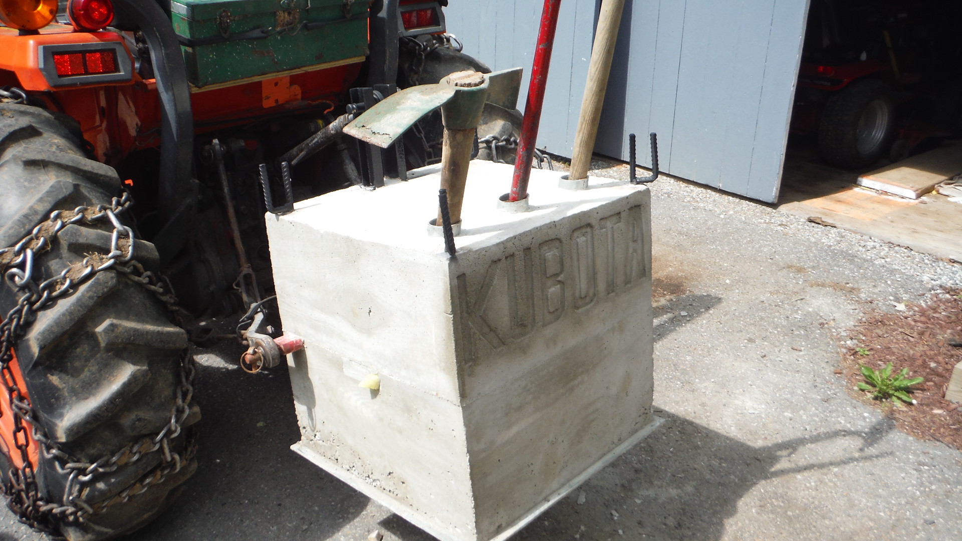

Yes I placed some hand made letters on the back board so when finished the word Kubota will be embossed in the concrete. I used an old property for sale sign like a Century 21 or Re Max the material Is corrugated Plastic. I had my wife wrap the raw edges in painters tape so the concrete will not get into the corrugation voids. I will spray them down with some Fluid Film before I pour so they release good.
   / 2x2x2 concrete weight box
#33
Up-date
You both were right the thing was about 10" from hooking up. Not even close. I just went out and tried it I took a photo of it the way I had it set up you can see it would never have hooked up. Then I moved the draw bar forward to a point that it would hook up easily and positioned the bar there in the box. I thought I took pictures after the draw bar move but I guess I did not. After I get it finished up I will then and post it. DSCF0511.JPG

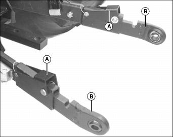

Don't they make some sort of gadgets that go on the end of the lift arms that give you a little extra reach for hooking up implements ?
My cousin has a new Massy 60 -70 hp cab radio heat air cond yada yada. On his lift arms there is some things at the end that you can move in and out about 3-4 inches so you can get close to the thing you want to hook up then make the small movements with these things?
   / 2x2x2 concrete weight box #37
Don't they make some sort of gadgets that go on the end of the lift arms that give you a little extra reach for hooking up implements ?...
Telescoping lift arms??? I think that's what they are called... Otherwise, Pat's quick hitch gives few inches reach.
   / 2x2x2 concrete weight box #38
They're great for getting things hooked up, but you wouldn't want to use them while extended. They would fail quickly.
#39
thanks but I don't think that is what cousin has. His, " I think " will slide out like 4 inches so that if you get close the hitch will do the rest.
   / 2x2x2 concrete weight box #40
If what you describe is what he has, yes, they are telescoping lower lift arms.
Still doesn't help OP's situation where his block interferes with hooking up.
