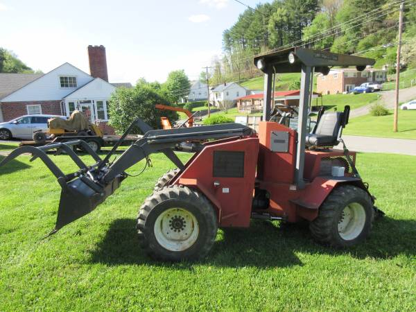

If you are going to look at this 2445 make sure you try all the hydraulics. Power Trac will not sell a hyd mower with the 24XX series tractor because they don't have a large enough oil cooler and will overheat. So there is a chance this machine will have ongoing problems with the hydraulic system from leaks to poor service life of expensive components.

Thanks for this info. I didn’t know that.
