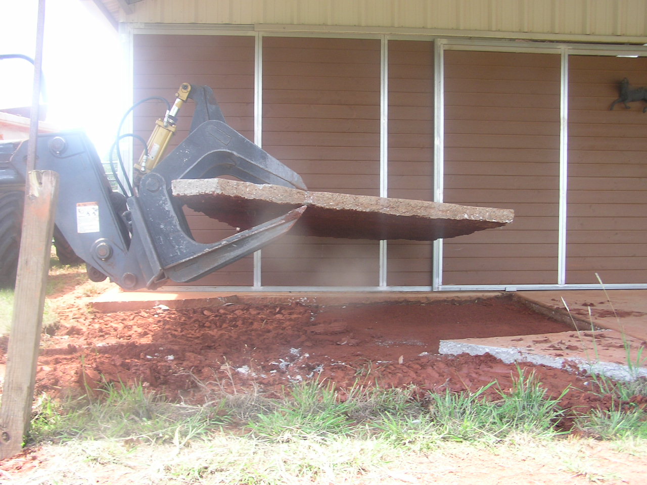

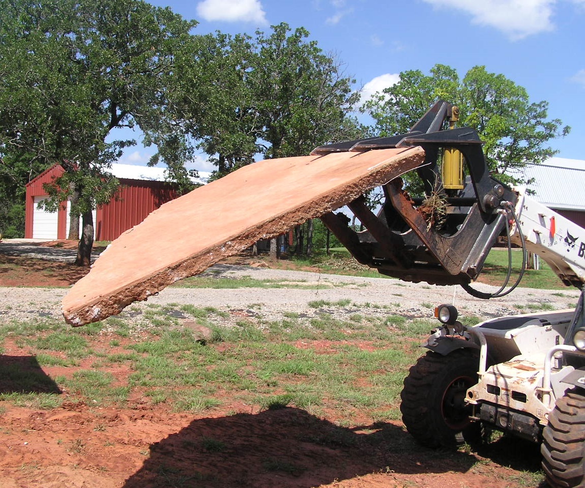

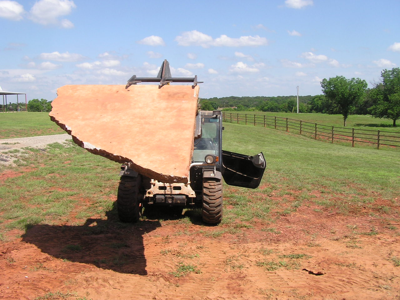

Will 3 1/2 to 4" concrete hold skid steer?
My V417 will hold 3 1/2 to 4" concrete. :D
