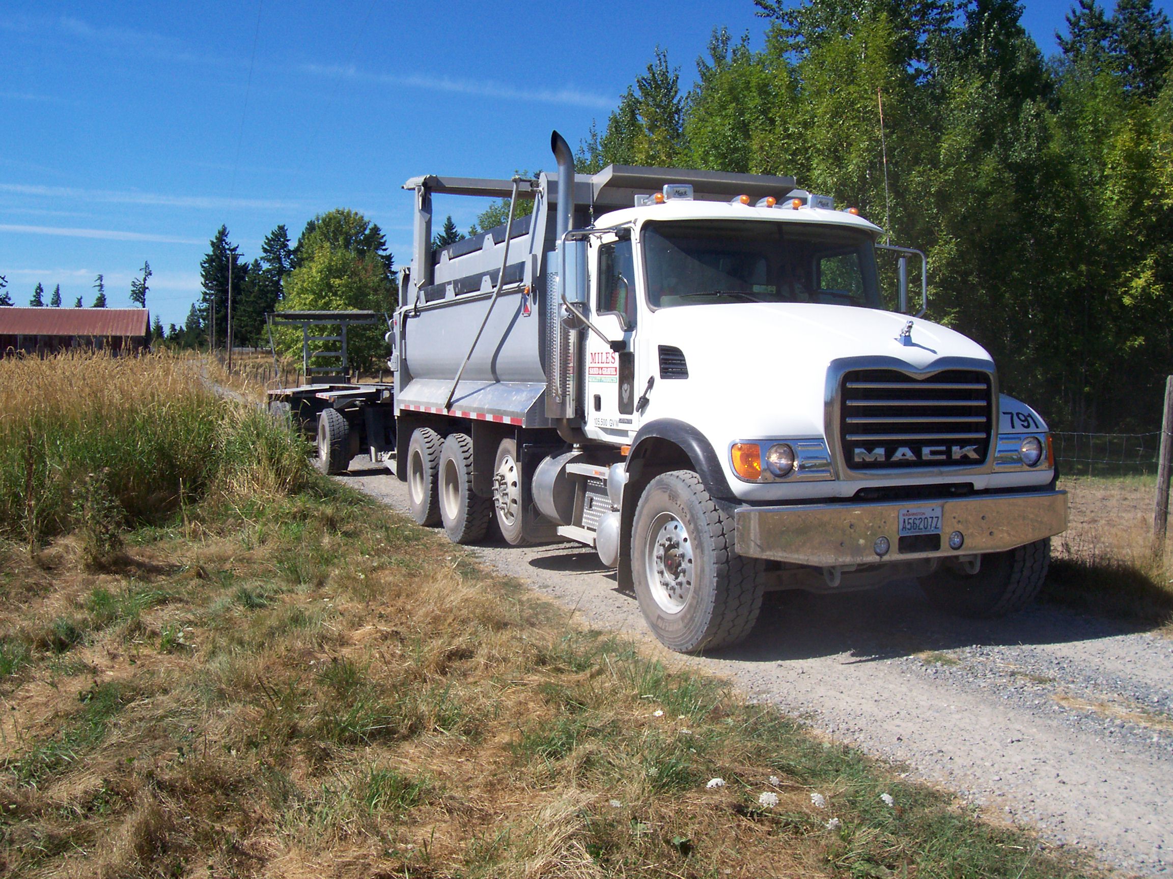

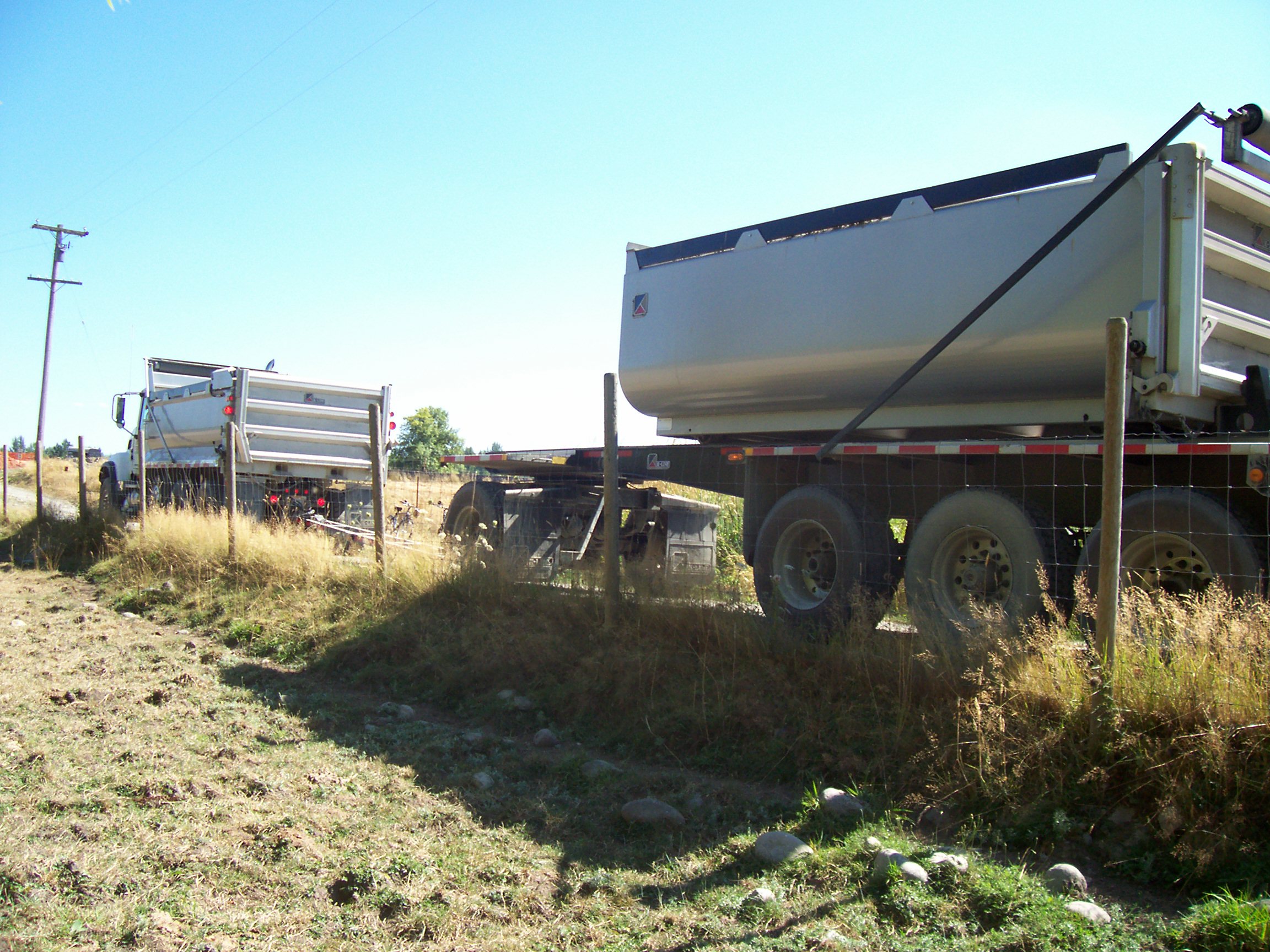

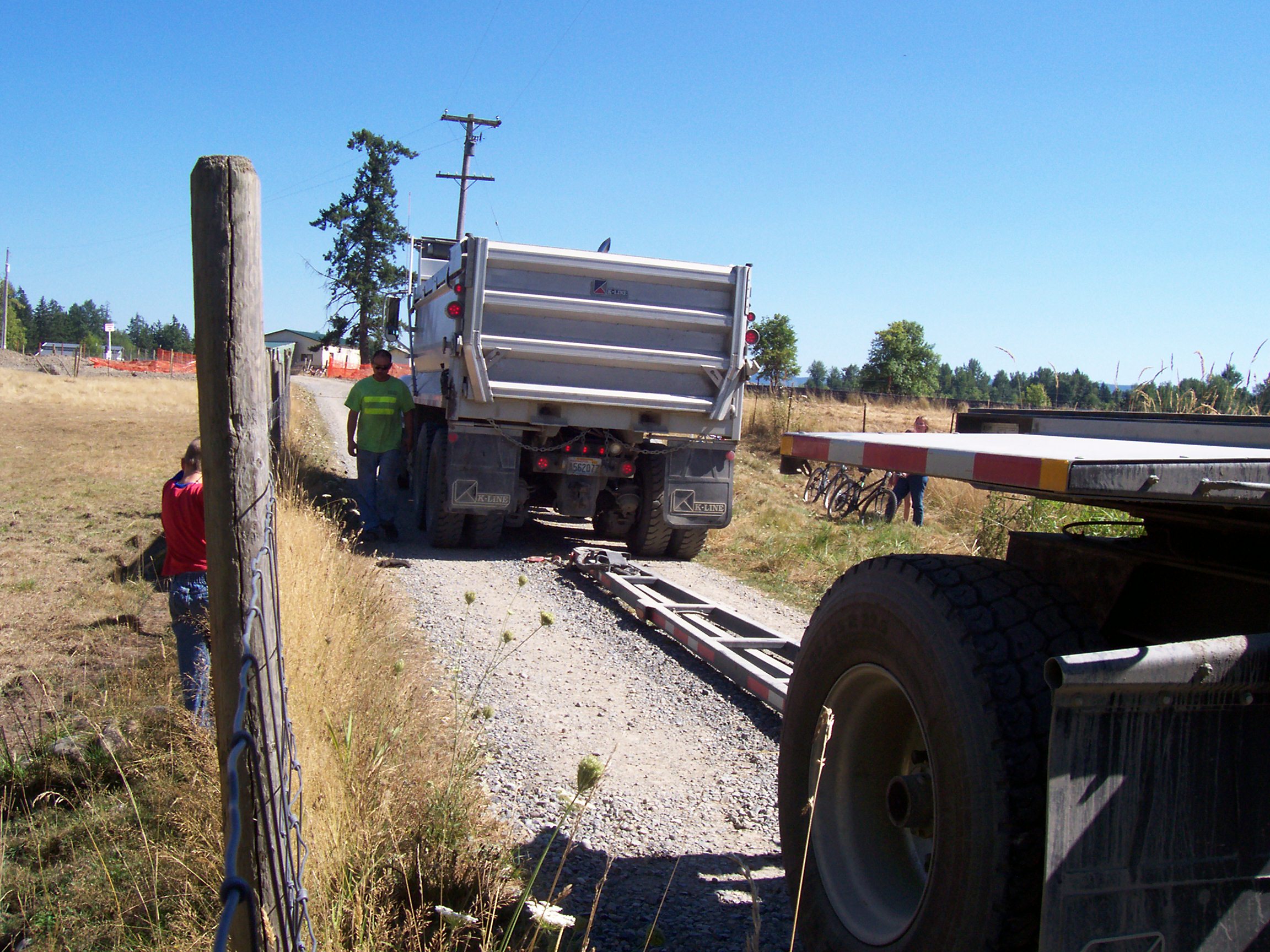

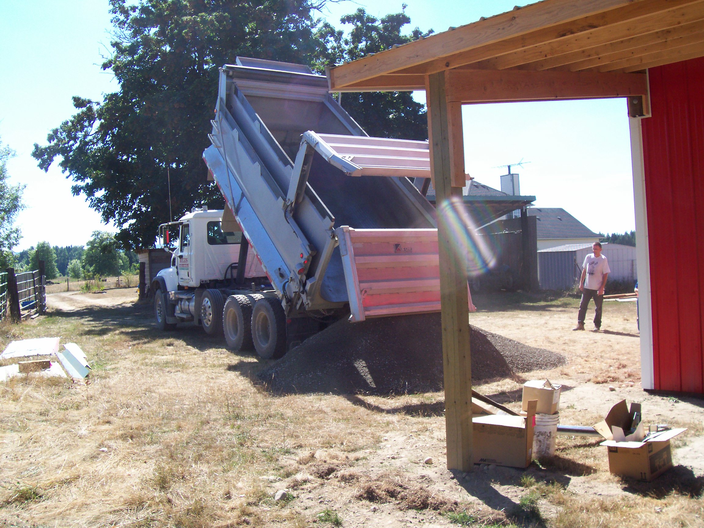

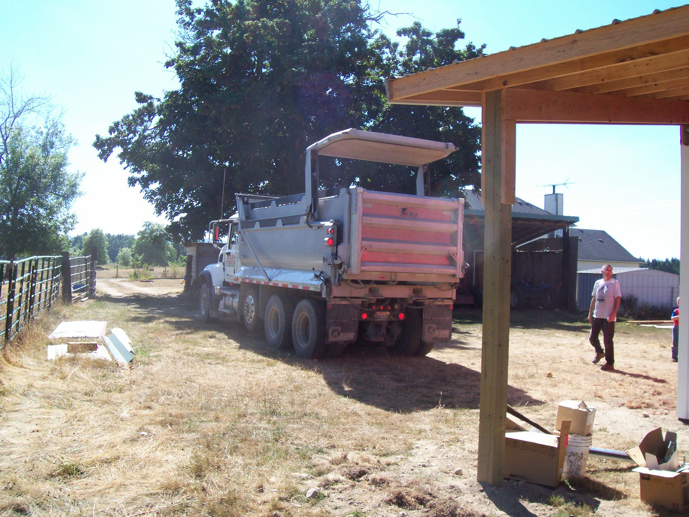

Here are some better pictures of how gravel is delivered around here. The delivery price is the same for just a truck or a truck trailer. I don't know it if works that way where you are.
