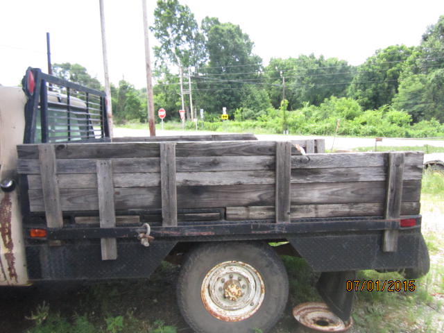

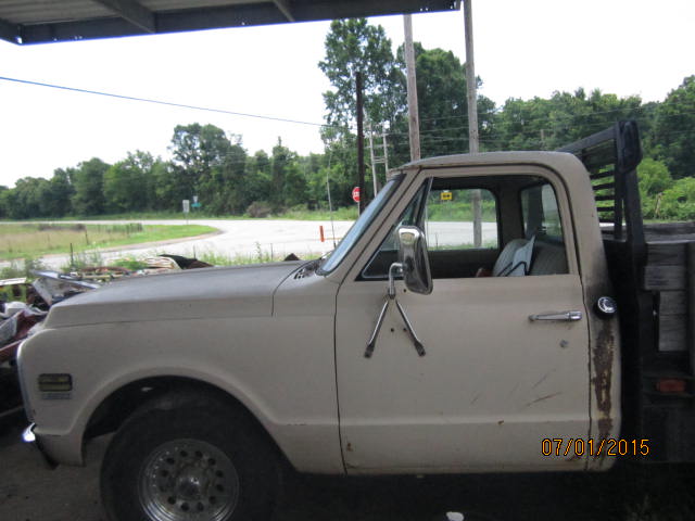

• A trailer with a GVWR of more than 10,000 pounds . Ok so you have a ton truck and your pulling a tandem axle trailer. the trailer itself will weigh at least 2,000 pounds. so that leaves you only able to haul 8,000 pounds. on the trailer. and you will need to have that 8,000 evenly split on the axles. Ive hauled 7500 pounds of july 2 005.JPGjuly 2 006.JPG scrap metal in the bed of my 71 3/4 ton on many occasions.

• A trailer with a GVWR of more than 10,000 pounds . Ok so you have a ton truck and your pulling a tandem axle trailer. the trailer itself will weigh at least 2,000 pounds. so that leaves you only able to haul 8,000 pounds. on the trailer. and you will need to have that 8,000 evenly split on the axles. Ive hauled 7500 pounds ofView attachment 432333View attachment 432334 scrap metal in the bed of my 71 3/4 ton on many occasions.
Well, the requirement was to have a cdl if your trailer is over 10k and the total weight of the truck and trailer is over 26k, so since most 3/4 or 1 tons are under 10k loaded, you can get away with a trailer quite a bit heavier than 10k.
Also, putting 7,500lbs in the bed of a 3/4 ton is either a gross exaggeration or totally unsafe. There's no way that the gvwr of that machine is over 9000lbs, and it's got to weigh at least 4,000, probably more. I don't see how you could put 7,500 and not be well overweight.
4000#? Our 1997 1/2 ton Dodge is almost 6000# unloaded. Most "full size" cars (like my 1997 Volvo V90) are 4000#.
IIRC, most 3/4 ton trucks are 7000# to 8000# unloaded.
