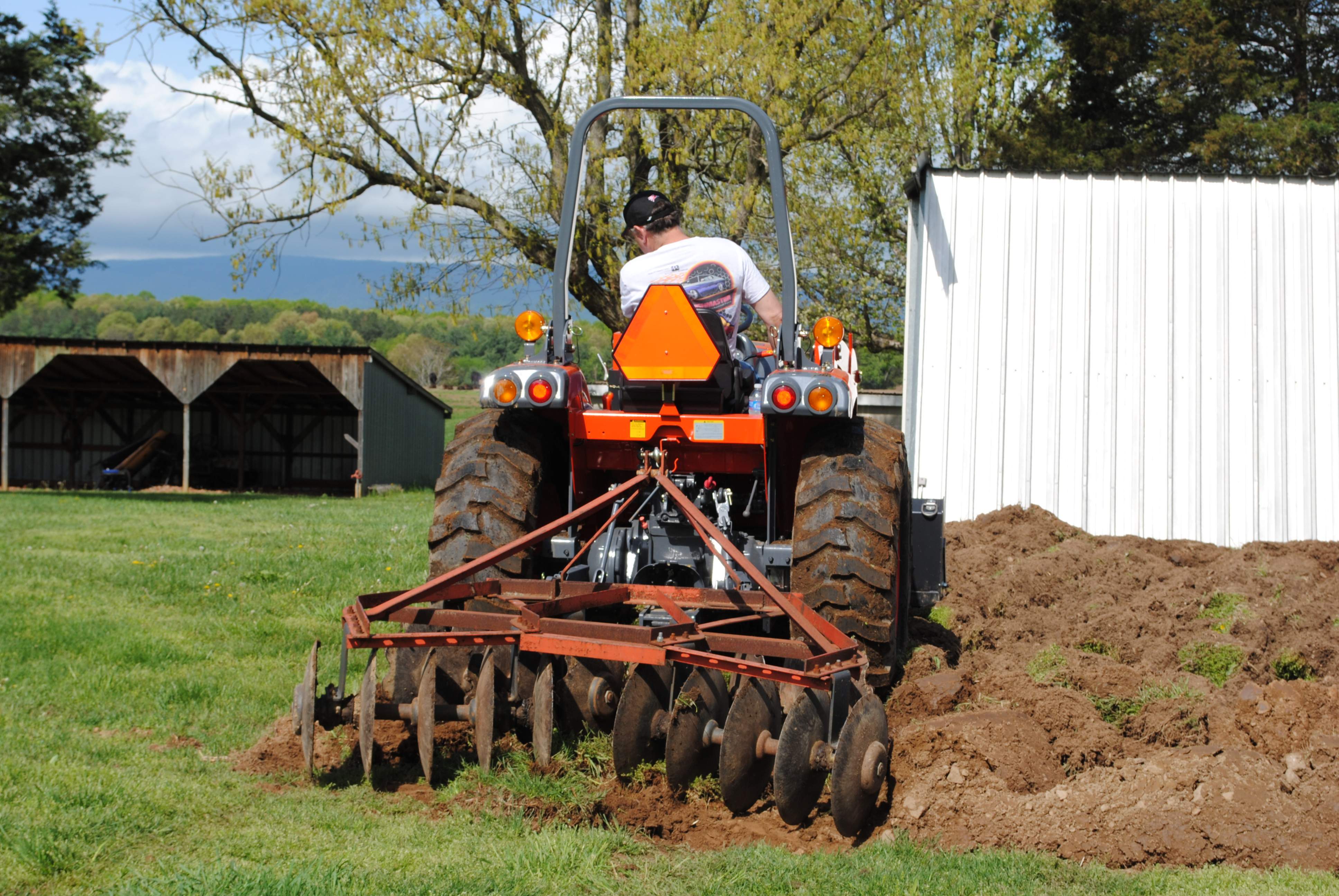

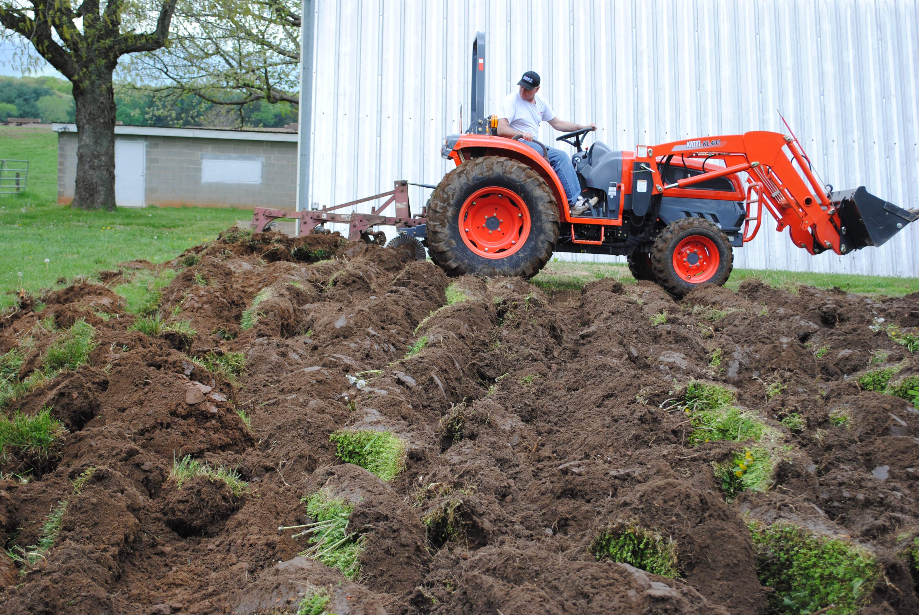

Attached is a pic of my DK45SE HST pulling a 3 bottom plow my neighbor let me borrow. Followed by some discing. Don't know what brand the plow was but it was no problem. Stuff in the garden actually grew after I was done.

That plow is a IH trip beam plow. Nice plow. Ken Sweet

It appears your not plowing deep enough, the soil should turn over better.... Just my thoughts.

Egon; I probably need to let the top link out a little more next time.
Blueriver: 3pt and draft control were all the way down.
I'll admit I'm a rookie at this stuff, first attempt at a small garden. Nothing more seat time won't fix. Tractor did great, operator still learning:)

Looks to me that your tire spacing is to wide. The first bottom should try to turn over only about 7 inches for 14 inch plow and 8 inches for a 16 inch bottom. A little less is more desirable then more.

Have set many breaking plows, 2 to 7 bottom. Yes JD plows are incredibly hard to pull, Oliver or White were the best. DK45 will have plenty of power, open er'up and traction should not be an issue with 4x4 & loader weight. Pulled 5 & seven bottoms plows for days on end, back before no-till took over. Two seven bottom tractors could turn 80 acres in 8 hours.
But... you need to have your spacing correct on the first bottom, should be taking close to the plow spacing of 14" or 16". If not you can likely set it close with your 2pt (lower arms linkage). The speed should be close to 4mph in order for the first mold-board to throw the dirt to the previous round.
You will not get a good level job plowing sod. Just disk it down and it's good.
