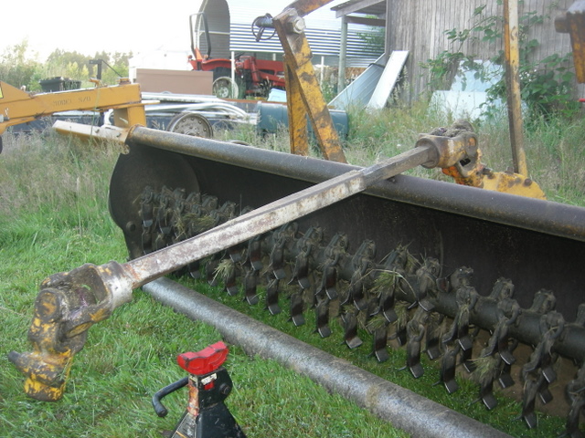

Thanks all. I ended up mowing 2 fields, about 6 acres maybe. Some of the grass was a bit tall for the flail mower, think I need a new pto shaft? Seems the TC30 has a few more horses than the AC5020.

The way it's twisted, I think you need some better sheer pins.
Is it still straight? If it's still straight, keep using it. No point buying a new one until you have to. If it's not straight, you got no choice.

I don't think that's a good idea. Those shafts are two piece to allow some lengthening and shortening during use. Unless the ground is perfectly flat, that shaft isn't going to work.
Since it can't "move", the loads may transmit to the implement or the tractor which could result in more costly damage.

Good point, I didn't think about the movement of the shafts inside of each other. Guess it's scrap metal now.

I finished the job, have an idea it twisted early on as I had the mower set way too low. It worked for another 3-4 hours is my guess, didn't notice anything out of the norm until I got home.

Since the inner section is solid 1" bar I'm pretty sure it twisted beyond the end of that section. I never noticed any binding, and like I told EW I think it went very early in the job. I will be looking for a new one though.

If the inner and the outer shafts twisted at the same time/rate, they _might_ still telescope, no? Easy enough to find out. Just make sure the telescoping part is "good-n-greeeazy". _Might_ work until you can replace it, anyway.
Actually, you need a "worse" shear pin; well, a weaker one, anyway. Grade 2 bolt, right?
