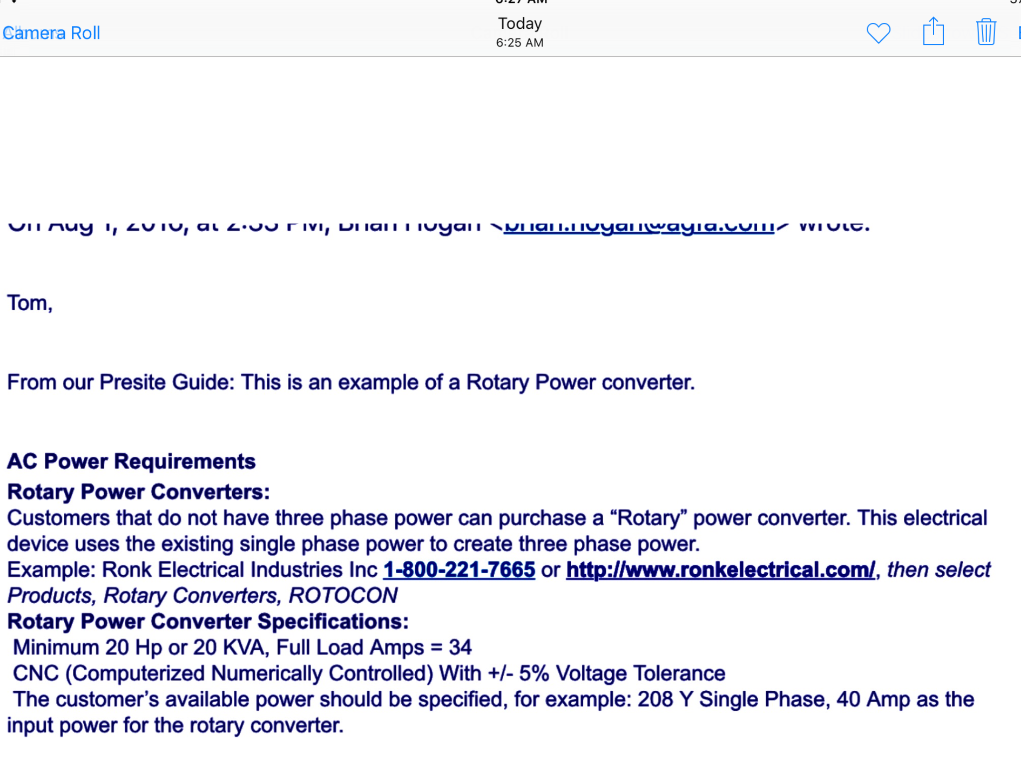

We are more than 1500 feet to run another leg for true 3 phase. I know because when I built the house, I had to trench and build the underground for our house. It's a bit over 1500 from our transformer and another 300 feet to the house.. It's also a private line and only powers my property. We would be using this almost everyday. If it won't run off a converter, I may have to look at a different machine, .. And I really don't want to.

I've been using a 25hp PhaseCraft RPC on a 50amp breaker for the last year or so. It was cheap and easy to install. It was about as plug & play as you can get. My biggest motor is a 10hp Pacemaker lathe. It runs it just fine. When I get the barn up, I'll feed it with 125amps and branch it into a 3phase service and hard pipe all my machines. The breaker is to small but I've never tripped it on start up or while using a machine. I push them pretty hard sometimes. It's a pain to run one machine at a time but it keeps me working.

This is what they have suggested.
   / 3 phase converter ok ? #30
Sounds like their printer ain't picky if they are suggesting a rotary.
Still probably looking at $1500-$2000 or more. I have never priced one that big. And wouldn't try to make one out of a static + motor, cause keeping voltage +/- 5% is gonna be hard on a DIY.
