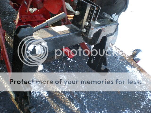

I opted for the #3 solution...A quick hitch.
In fact I have two.
My reasoning when they were purchased was:
1. They were the same cost as just the slip-on lower link quick-ends but weigh in at approx 75# which is a significant amount of extra ballast for the same cost.
2. They came with the upper hook that automatically allows pick up without getting off the tractor so long as you've standardized all your implements.
3. The quick hitch is ready made for attaching out of the way/permanent receiver hitchs on it, making it even more versatle for a WIDE variety of add-ons, and adds a bit of ballast in itself with the 4-way stored in it.
4. With a couple chain hooks welded to the top, it's a ready made log carrier.
5. It's also a solid framework from which to start for specialty or unique items (Such as this truck 3pt hitch I designed).
