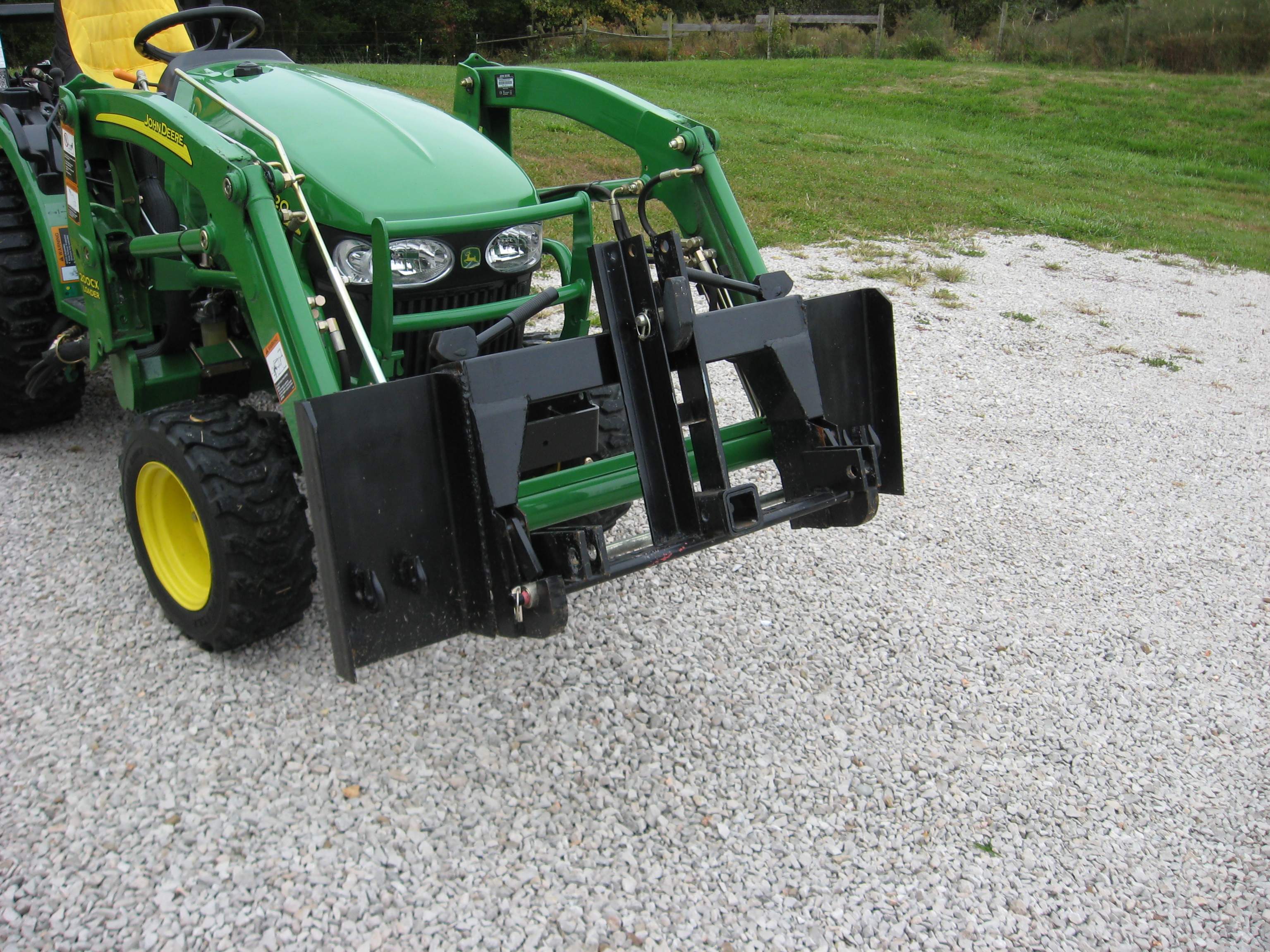

I have two #3's. iMatch on the rear and modded HF for the front.

whats the difference between the imatch and the HF model.

"whats the difference between the imatch and the HF model."
Well, my opinion only, for whatever that's worth:
The HF is a knock-off of the JD iMatch. It is not built to the same tolerances and, therefore, doesn't fit attachments as well as the iMatch. Just for example, the two plates that hold the upper hook get in the way of some of my attachments, so one of the mods was to cut a couple of inches off of them.
Also, the pieces that hold the bottom hook latches are not carefully positioned, and they also get in the way of the lower pin connections.
With some effort, it works basically the same, but just not a smoothly as the iMatch.
If I was doing the front quick hitch project again, I would bite the bullet and use a regular iMatch for it.
