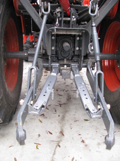

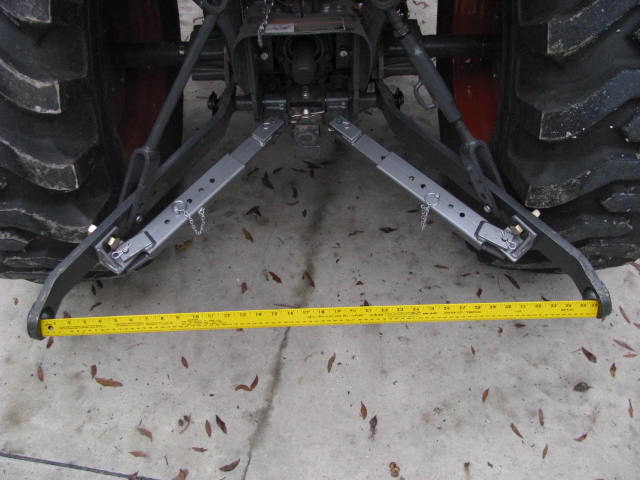

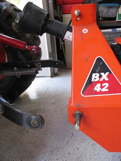

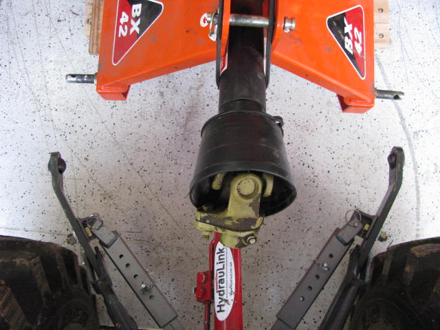

No the bottom hooks will not work either. The spacing between the is fine, the spacing from the top hook to the bottom hooks is good (adjusted that way). The problem is that on the brush hog none of the hooks are long enough to reach out and connect to the pins, and on the tiller the bottom hooks (with the spacers on) will not fit between the pins and the tiller frame and the top hook is not long enough to reach into the top support. Yes I could get the top bracket and fix the top, no I am not going to cut the frame on the tiller or cut the back of the hook to fit between the frame and the pin.
I am done with the unit, I will wse the metal for some other project in the future no big deal.

OK. I think I understand what your problem is. I had a similar issue where the ears on the lower hooks (the flat bars where the hook locks are pinned between) would interfere with the frame and not allowing the attachment (I think it was my box blade) to not go on the lower hooks. I had to grind a little off the box blade and/or the hitch ears to get it to go on. I was able to use the HF hitch for awhile, but took it off when I had to connect my post hole digger which doesn't use the top link. I already had a set of Pats bought for another tractor that I wasn't using. I put those on and haven't thought about taking them off ever since. Pats works with every attachment no problem. If you get a set you won't be sorry.
