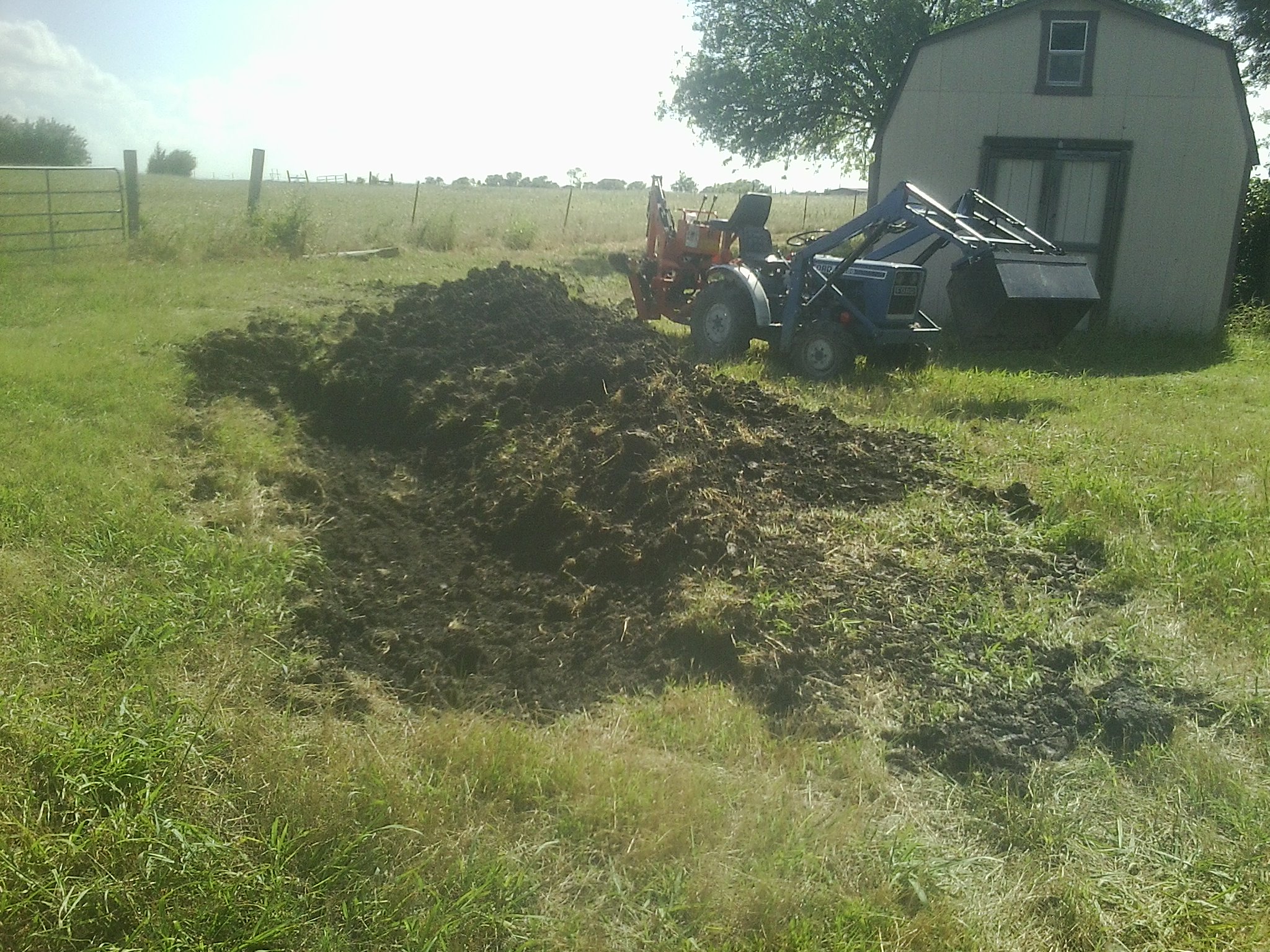

To the OP. I went through all this four years ago. Only some of the names and the dates have changed, but same song and dance. I have been using the 3-point for 4 years on my tiny tractor with ZERO issues. The physics of how backhoes work does not jive with what these "experts" are feeding you. It didn't jive four years ago, and doesn't jive now. I dare say my tiller puts more strain on the tractor than the backhoe. Bottom line: it is your money.
/ 3 point backhoe vs sub-frame mount #29
Physics aren't negotiable, or subject to opinion. If you put a load on the 3pt with a hoe that pushes down, it lifts the front of the tractor, and puts all the weight of the machine forward of the rear axle on the bolts that hold the rear end housing to the transmission. That's not negotiable...it's simply what has to happen. That's why you sometimes see tractors broken in half due to using 3pt hoes. It's also why subframe mounts bolt to the rear end housing and the transmission housing to make them effectively one piece, and not put all the strain on those bolts. This isn't in question, and it doesn't matter whether you think it "jives" or not.
A tiller doesn't put a downward load on the 3pt other than it's weight, which isn't all that much. It can put a rearward load on the 3pt, but those don't break things.
3pt hitches don't normally have down pressure, but backhoes do, and that's the difference. A backhoe can put a significant down pressure on the 3pt, where no other implement really can.
It's great you haven't run into a problem yet, but it's very possible that with such a small machine, the hoe can't put much of a load on anything.
