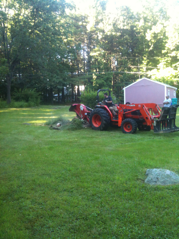

I went ahead and cleared out the shop this morning and hooked up my grinder and took it for spin. Wow, that thing will chew through them stumps! I was running at 540E PTO and bogged down the engine grinding up 3-4 inches at a time. After lunch I'll get out the camcorder for some action footage at 540 PTO (not E) :D and update my thread.

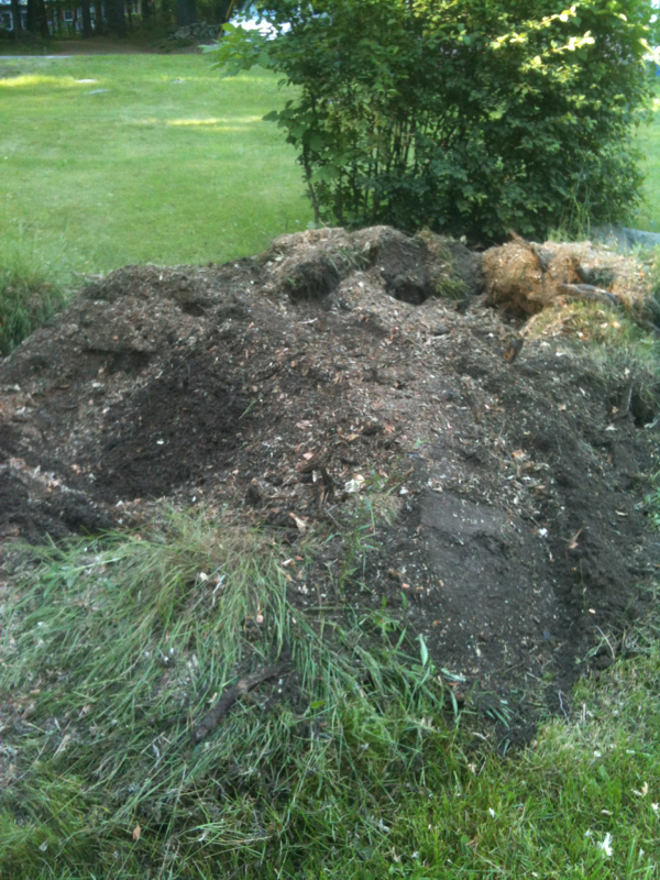

I take only about 2 inches off per swipe and have to go slow. I'm amazed at the chips it throws and the amount of chips it throws up! With the full 85hp of your pto I bet you can chew through some serious wood in no time! I'm glad you broke it in!
I ground down a cherry tree stump yesterday that was blown over in a storm. Love that smell!
