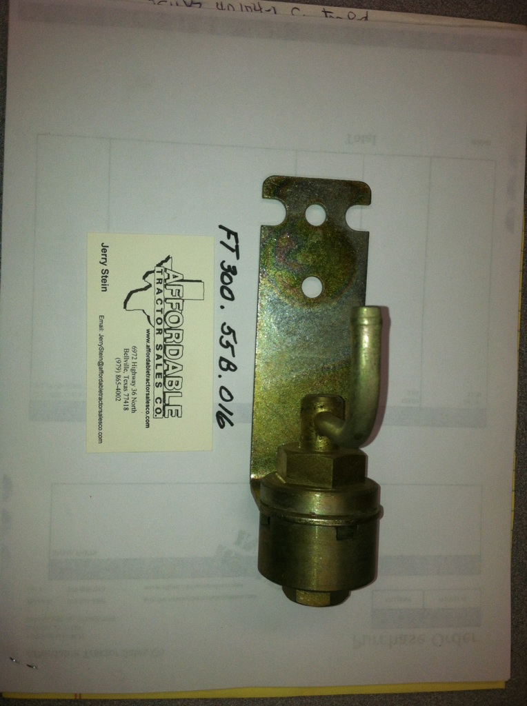

   / 3 Point bushings #16
Ok I know this is an old post but my F404 started leaking only from the left side 3Point control arm. I have called Affordable for parts but since I need a few other things I have to wait to verify them before just ordering the parts to fix this.
A couple of assumptions:
It has always had blow out the vent top so there is a vent tube on the vent pipe that goes into a collector.
I too like the OP had been filling to the top second line not the first line about 1/4 from the bottom of the stick
Lastly how do you replace these bushings and seals? Do you have to take the whole 3 point box off the 404? Or, can they be removed while installed on the unit and just pulled out the side? I do have the manual and can see the parts but its not clear if I have to remove all the shafts and guts first or can they be removed out the side
Thanks in advance for any guidance
   / 3 Point bushings #18
Tommy,
Thanks I called in and talked to one of you guys this morning. I have a few more non related parts that I need to identify before ordering so I can order once. ;)
Do you have a suggestion on the fill level? I keep a container back there with a tube on the overflow vent.. I bet I take a half gallon of overflow out every other month.
   / 3 Point bushings #19
   / 3 Point bushings #20
I am not overfilling it on purpose but as stated above there are two lines on the dipstick.. I have always thought of the lowest one as the "hey not enough discontinue use until refilled line" and the upper one as the " this is the maximum full line". I keep it between there but it pukes out the breather quite regularly.. Some including Greg have noted they do not fill to the top line I was wondering if that was the facts or ?
