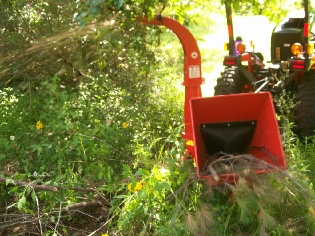

I also have the Wallenstein BX42. It works really well if the blades are kept sharp, and there aren't more leaves than brush. Here are a couple of pictures of mine:
